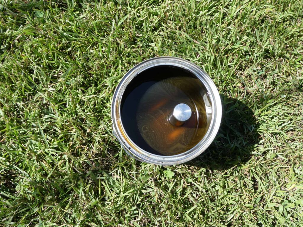

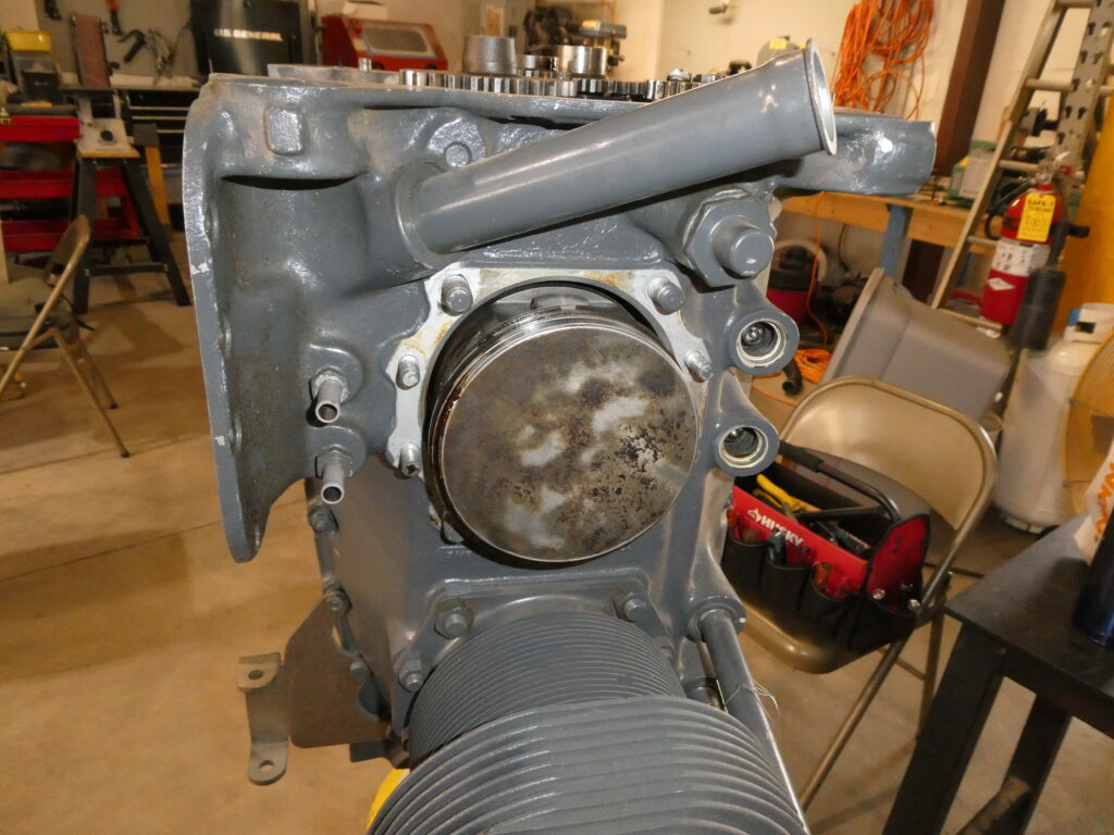

We (myself and the kids working with me at the EAA chapter Youth Build sessions) were initially thinking good things as the insides looked clean and there was plenty of assembly lube still in evidence. Then we pulled the jugs and discovered that during storage the assembly lube had puddled at the lowest points in the cylinders and “sludge-welded” the rings to the pistons. Not good. I pulled out the gallon cans of carb cleaner and dropped the pistons in until the sludge was dissolved and the rings were rattling around loosely. Since these rings have become nearly unobtainable (reference prior comments about the practicality of O-290 conversions), I left them in place and used a sharpened dowel to remove any remaining sludge in the ring grooves, not that there was much, as the carb cleaner really works.
And if new rings had been necessary? There are Mack E6 diesel engine piston rings that are the correct size and apparently work (and for a very small fraction of the price of official Lycoming rings), but the ones on my pistons looked to be in decent shape, so they were used. As for the diesel rings, a fellow EAA-er used the Mack rings and reports no issues after installing them on one cylinder of his O-290D. O-435 rings and pistons are also supposed to be usable in the O-290 as they are the same diameter bore, which you will know once you’ve done your reading assignment on Lycoming engine architectures. If you haven’t done that already, I will leave that as an exercise for the reader, to paraphrase my college profs.

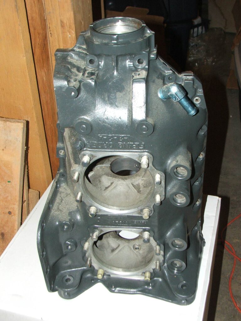

At this point, do we need to “split the suitcase” (pull the case apart), or are we good to put the cylinders back on and move forward? I was thinking the latter until looking more closely inside.

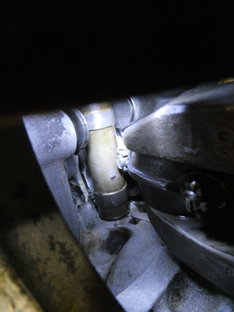

Me: “Wait, what is this that I am seeing inside the case, especially around the part line?
Permatex? Surely that isn’t Permatex.
Seriously? It is Permatex! Gads.“
Yes, grey Permatex Form-a-gasket, with significant amounts squeezed into the inside of the engine!
Some of it was still gooey, but the rest of it had hardened and was crumbling into large, brittle chunks. In neither case did I want it going into the sump and the oil, never mind that it wasn’t the correct case sealant. Decision made easy: split the suitcase it is. See my article in a prior issue of this fine magazine on the inexpensive plates we fabricated to separate the case, necessitated due to the case halves being firmly bonded together by the Permatex. Besides the wrong sealant, there was no silk thread, either.

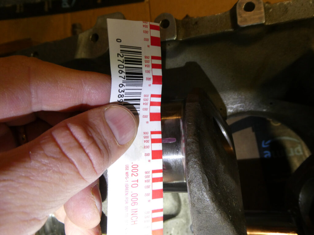

The rod and crank bearings all looked as if they were unused, and Plastigauge showed them to be well within tolerances. Wondering about the viability of using the D crank, I checked the bearings with the D crank using the Plastigauge and found them all to be on the outer edge of tolerances, right around 0.004 inch clearance (see Figure 5). I then compared the two cranks and found the flight crank journals to all be about 0.003 inch smaller than on the G crank per my micrometer. This seemed to be a curiously specific and consistent amount. A little research revealed that 0.003 inch and 0.006 inch are the first two crank bearing rework values, so all I needed in order to use the flight crank were bearing shells to match the 0.003 inch diameter undersized bearing surfaces. For what it is worth, there are also 0.010 inch undersized bearings as the third and final amount that you can turn down a journal. After that, you need a new crank.
