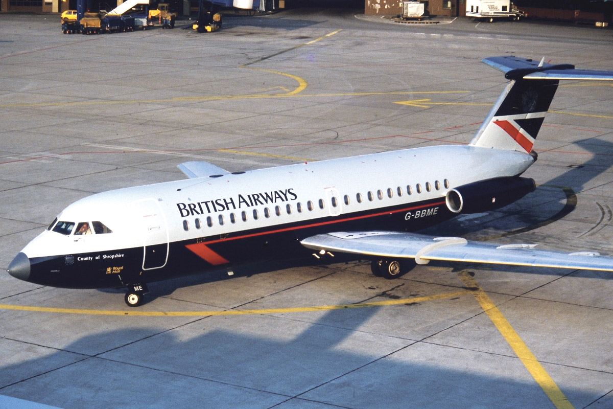

This is harder to detect than an abrupt pitch-up, but it is very dangerous because the airplane is transitioning into a steep descent at high angle of attack in an approximately nose-level attitude without a strong pitch-rate cue to the pilot. The airplane can progressively lock into a steeply descending deep stall as sink rate increases and airspeed decreases. This particular characteristic caused accidents with some early swept-wing T-tailed airliners. Both the BAC 111 twinjet and the Hawker Siddeley Trident trijet had fatal deep-stall accidents caused by this.
