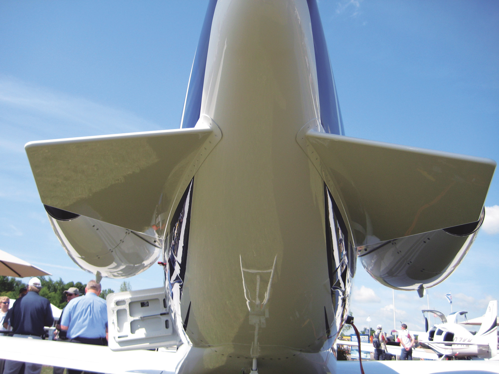

Aft Body Strakes
Enlarging the horizontal tail on a high-tail configuration requires a significant redesign of the tail and the structure it attaches to. Any production tooling for the original tail must also be scrapped and replaced with tooling for the new tail. This can be quite expensive, and the structural changes can add significant weight.
Another approach is to add additional aerodynamic surface to produce stabilizing forces at high angles of attack. The auxiliary surfaces can clean up the pitching moment characteristics of the airplane at higher angles of attack sufficiently to give the airplane satisfactory flying qualities while retaining its original tail. Low-aspect-ratio horizontal or canted strakes mounted to the aft fuselage are often used to improve longitudinal stability at high angle of attack.
Lift on the strakes produces a stabilizing nose-down pitching moment increment as angle of attack increases, and this increment persists and increases as angle of attack increases up to and beyond the angle of attack at which the wing stalls. They are particularly effective at higher angles of attack because instead of stalling, they generate strong vortices that produce lift at angles of attack well above the stall angle of attack of the wing.
Aft-body strakes are common on business jets and some other T-tailed and V-tailed airplanes. Among these are the Lear 60, Cessna Citation Mustang, Piaggio Avanti, and Cirrus Vision Jet.
The Vision Jet actually takes the concept a step beyond being a passive stabilizing device. It has control surfaces on the trailing edge of the strakes that work along with the V-tail ruddervators to improve the controllability of the airplane.
