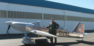

Not every A&P is troubled by this situation. I recently began a condition inspection on a 19-year-old RV-4 that had no service bulletins signed off or performed. There were 18 signed condition inspections in the logbook when I got there and nothing else (which is admittedly perfectly legal), but there is now a list of service bulletins that have been completed and signed by the owner, since he is the one who did the work. These things weren’t difficult or expensive to do, and the airplane is now safer because of it.
