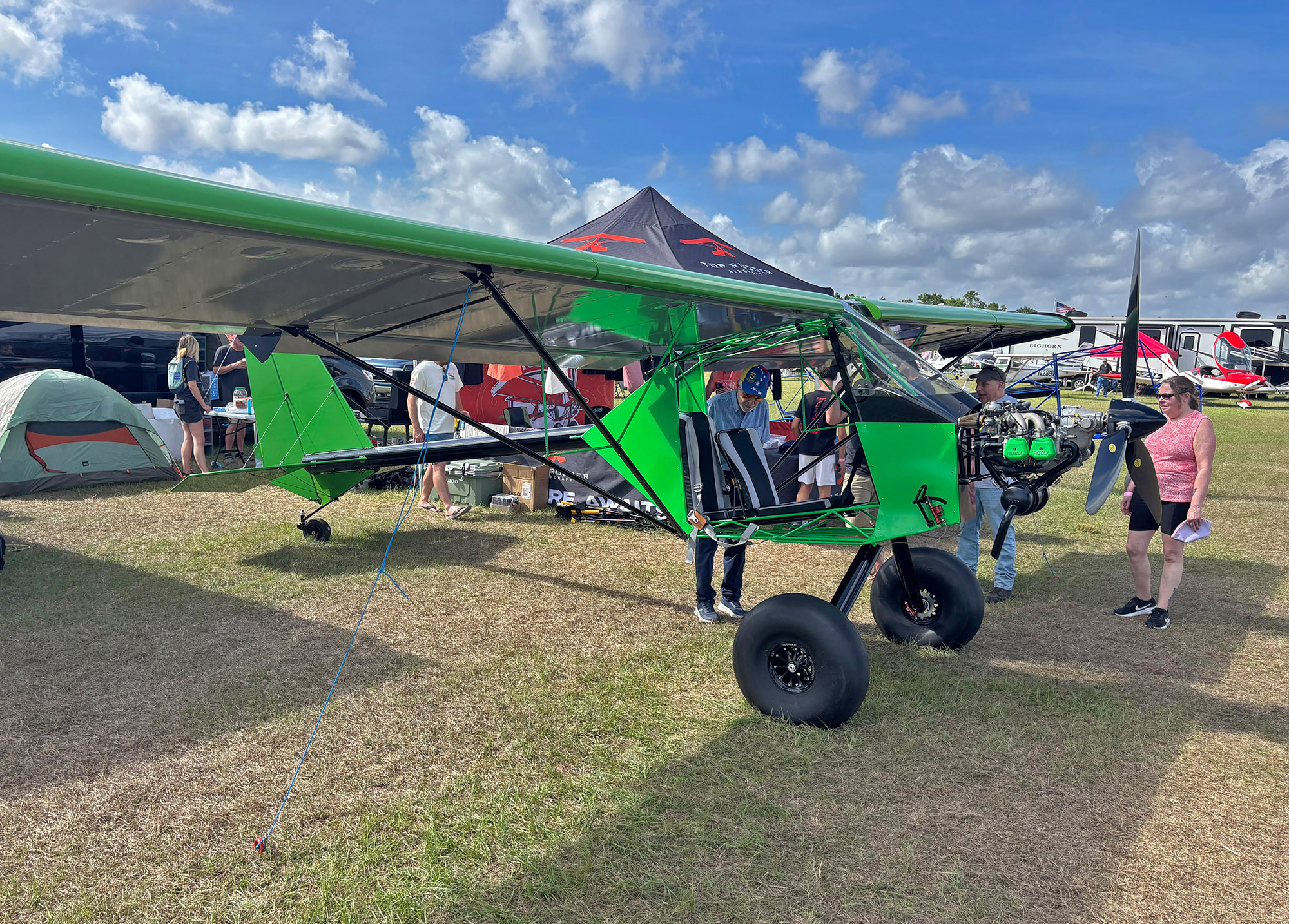

You might call Top Rudder Aircraft’s new Ruckus “the STOL plane for the masses.” The aircraft, introduced to pilots for the first time at Sun ’n Fun 2025, features excellent short-field capabilities, is powered by an 80- or 100-hp Rotax engine, and can easily be trailered to and from the airport. In addition to potentially eliminating hangar costs, you can put one together for $40,000 plus the engine.

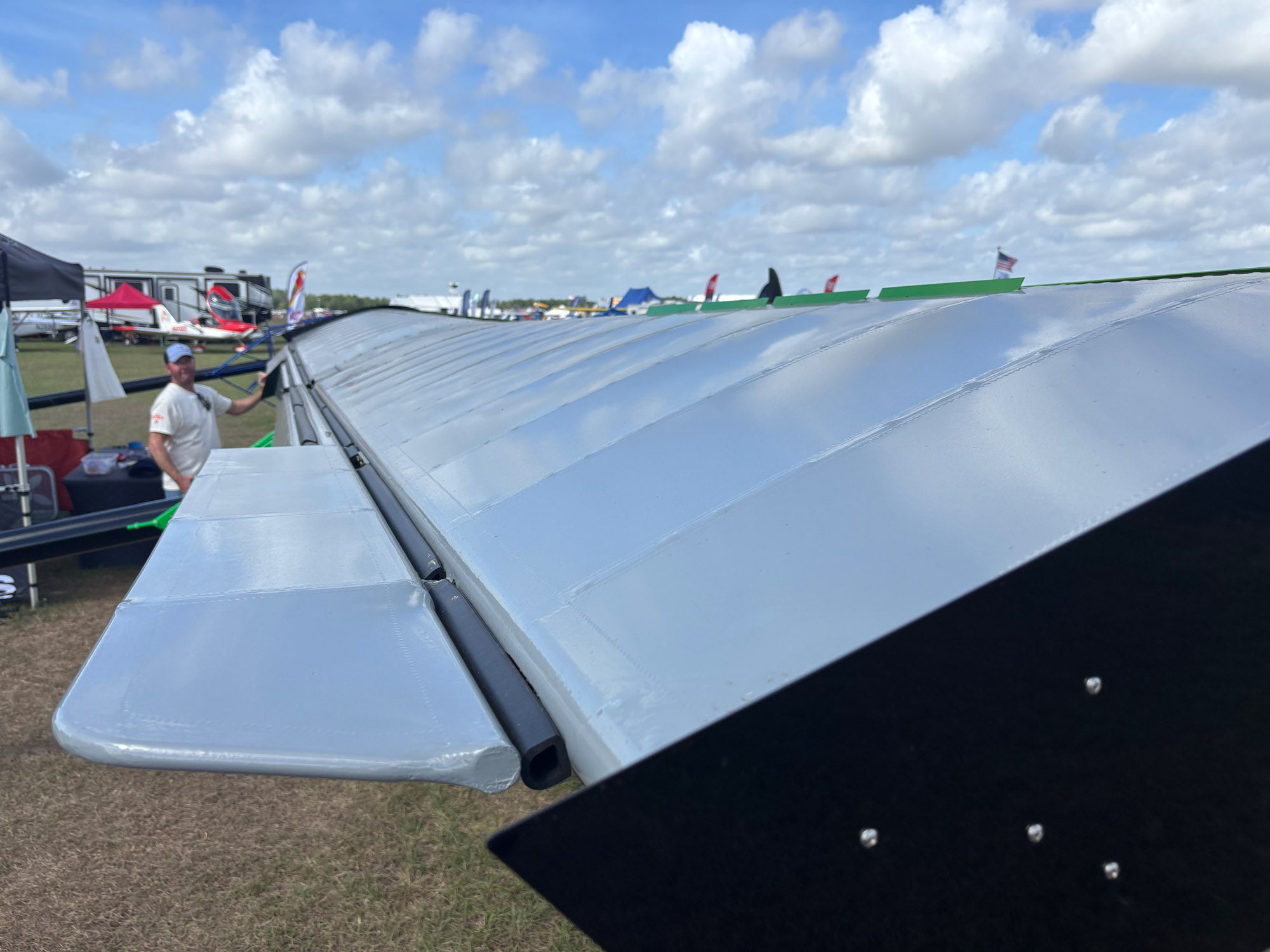

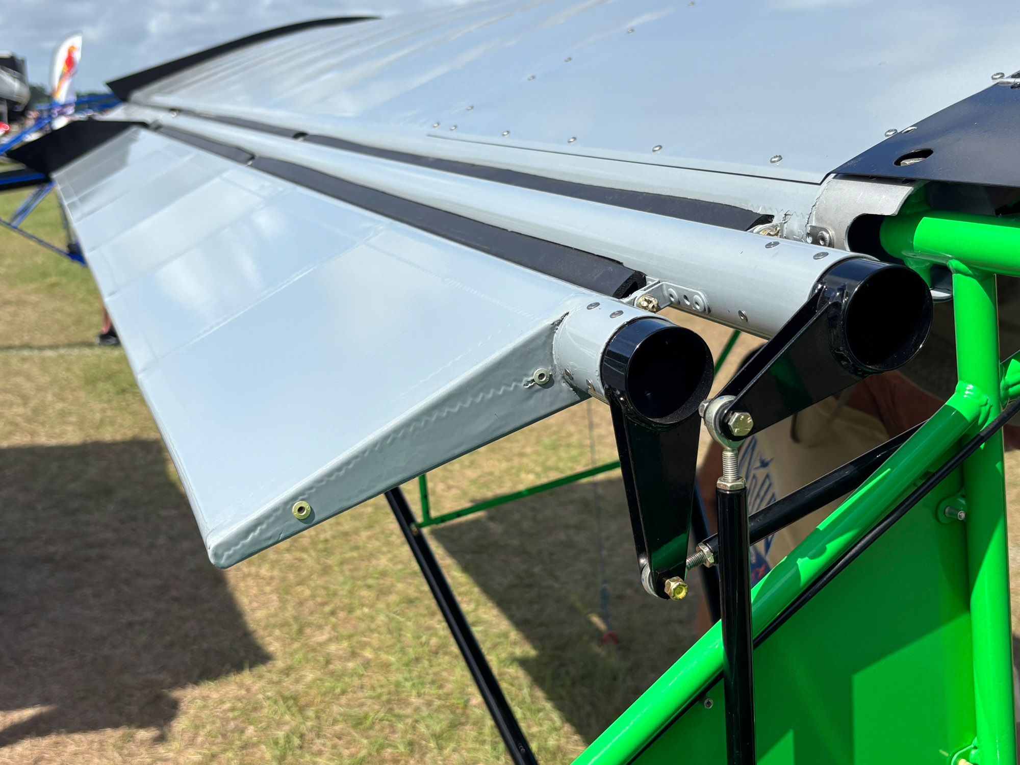

The Ruckus may initially appear to be nothing more than a beefed-up ultralight, but it’s actually a full-fledged and surprisingly capable ELSA—one that can cruise 500 miles at more than 100 mph, take off in less than 50 feet, and land in under 200. With its unique, patent-pending moving-hinge flaps, flap and aileron fences, leading-edge slats, and spoiler system, the airplane will fly at 25 mph, fully cross-controlled, without stalling.

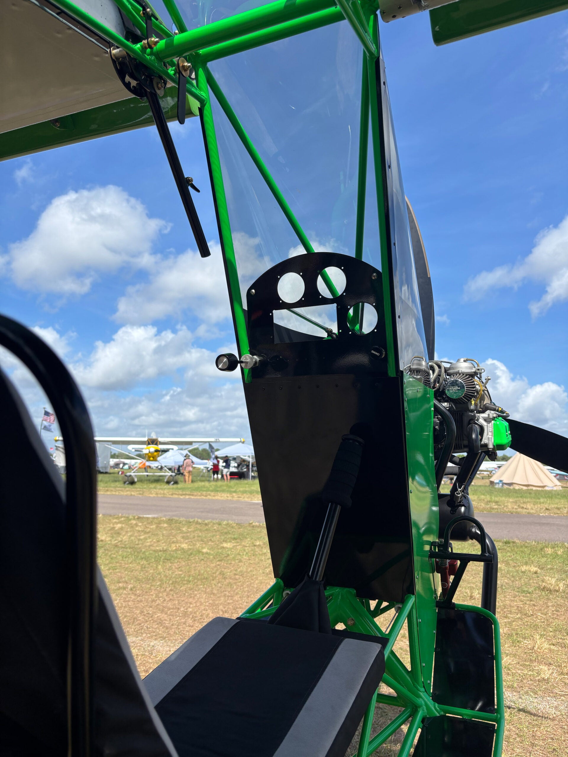

Thanks in part to its open cockpit and welded X-frame design, the Ruckus can be assembled in as little as a week. Top Rudder says just about anyone can have the wing ready for covering in less than a day. “After that, it depends on how comfortable you are with tools and how hard you want to push,” says Angell.
