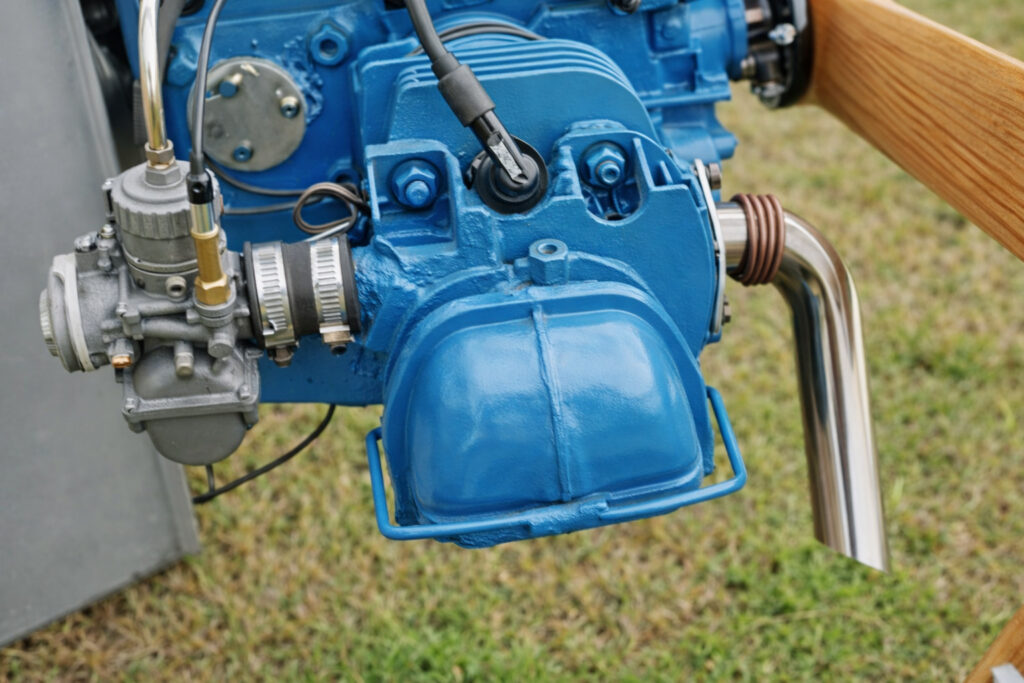

The Milholland V-twin engine, properly called the Better Half VW, represents one of the most successful lightweight four-stroke powerplants in the homebuilt aircraft world. Designed by Leonard Milholland of Brookshire, Texas, and first introduced in 1993, this two-cylinder conversion takes a fundamentally different approach to creating a small aircraft engine from Volkswagen components. Unlike earlier half-VW conversions that required cutting the engine case in half, Milholland’s innovation preserves the full crankcase, an approach that has proven simpler, more reliable, and ultimately more successful than the cut-case alternatives that preceded it.
The Better Half VW conversion produces approximately 30 horsepower at 3400 rpm with standard 92mm cylinders, though builders can increase power to 37 horsepower or more by using larger bore cylinders. The engine’s displacement is 920cc with the 92mm cylinders on the stock 69mm crankshaft, though various strokes from 69mm to 86mm can be used depending on builder preferences. The engine weighs approximately 88 to 90 pounds when properly built, making it ideal for ultralight aircraft that must comply with FAR Part 103 regulations. Milholland’s own Legal Eagle ultralight, which has an empty weight of just 244 pounds, was specifically designed around this engine and demonstrates its suitability for the lightest end of the homebuilt spectrum.
The Better Half conversion differs dramatically from cut-case approaches in its construction methodology. Rather than sawing the VW crankcase in half and fabricating an aluminum plate to seal the rear, Milholland’s design leaves the case intact and simply blanks off the two rear cylinders. An eighth-inch aluminum plate bolts over each rear cylinder opening, and the rear pistons and connecting rods are removed entirely from the crankshaft. The crankshaft itself remains unmodified, though only the front two rod journals carry pistons. The camshaft similarly remains uncut, with only the front two lobes actuating valves.
This full-case approach offers several compelling advantages that early builders of cut-case engines discovered through hard experience. The VW crankcase uses the rear mounting bosses originally designed for the car’s transmission as engine mount points. When the case is cut in half, these critical mounting provisions are severed, requiring builders to fabricate new mount points and add them back to the modified case. Similarly, the oil drain hole at the bottom of the case is bisected when the case is cut, creating sealing challenges that must be addressed with additional fabrication work. The rear bearing support and case rigidity are also compromised by cutting, necessitating careful reinforcement to prevent case distortion under load.

More significantly, full-case engines run substantially cooler than their cut-case counterparts and exhibit far less crankcase pressure. Cut-case conversions often require oil coolers to manage temperatures, and many builders found it necessary to add reed valves to handle excessive crankcase breathing. The full-case design eliminates both problems. With the unused rear cylinder openings properly sealed and the case volume maintained, the engine achieves adequate internal breathing and oil temperatures remain within acceptable limits using only the inherent cooling capacity of the VW’s air-cooled architecture. When Leonard Milholland discovered these characteristics after building both cut-case and full-case engines, he adopted the slogan “Don’t Cut That Case” for his advertising and calling cards, a message that resonated with builders who had struggled with the complexities of cut-case conversions.

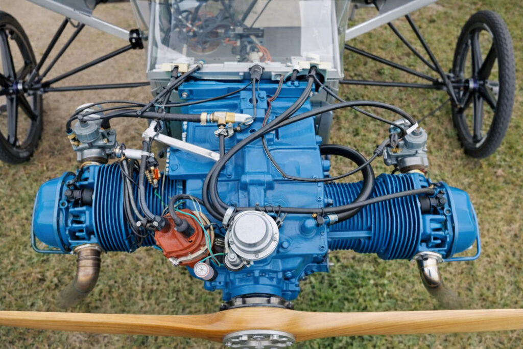

![This top view shows the elimination of two of the Type 1 VW’s cylinders while keeping the full case intact. [Credit: Legal Eagle Airplane]](https://www.kitplanes.com/wp-content/uploads/2026/02/Milholland-V-Twin-Top-View-1024x683.jpg)

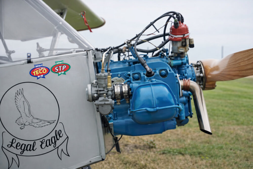

Great article and great little engine mod. But somehow I am havig trouble following some of the lines and wires. There seems to be a fuel line terminating at its left spark plug. Then the plug wire for the left cyilinder disappears under the fuel pump. The top of the left carburetor appears to be fed by a fuel line. Where is its throttle cable? I can go on, I suspect this was not a flying setup.
I would defer your question to Leonard Milholland, who can be SKED HERE: https://legaleagleairplane.com
