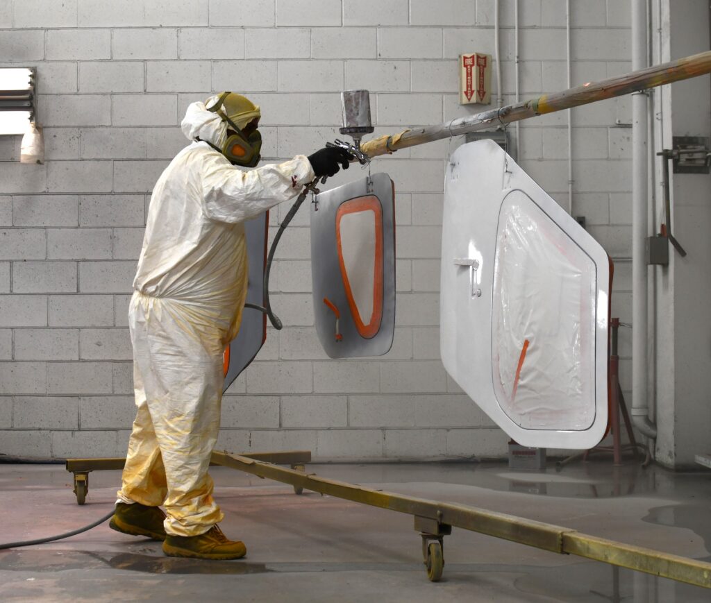

![The painter sprays the door planels of a Glasair Sportsman 2+2. [Credit: Mike Davenport]](https://www.kitplanes.com/wp-content/uploads/2026/02/White-doors-1024x869.jpg)

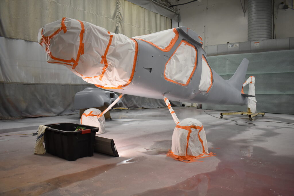

![The Sportsman 2+2 masked and primed. [Credit: Mike Davenport]](https://www.kitplanes.com/wp-content/uploads/2026/02/Primer-1-1024x683.jpg)

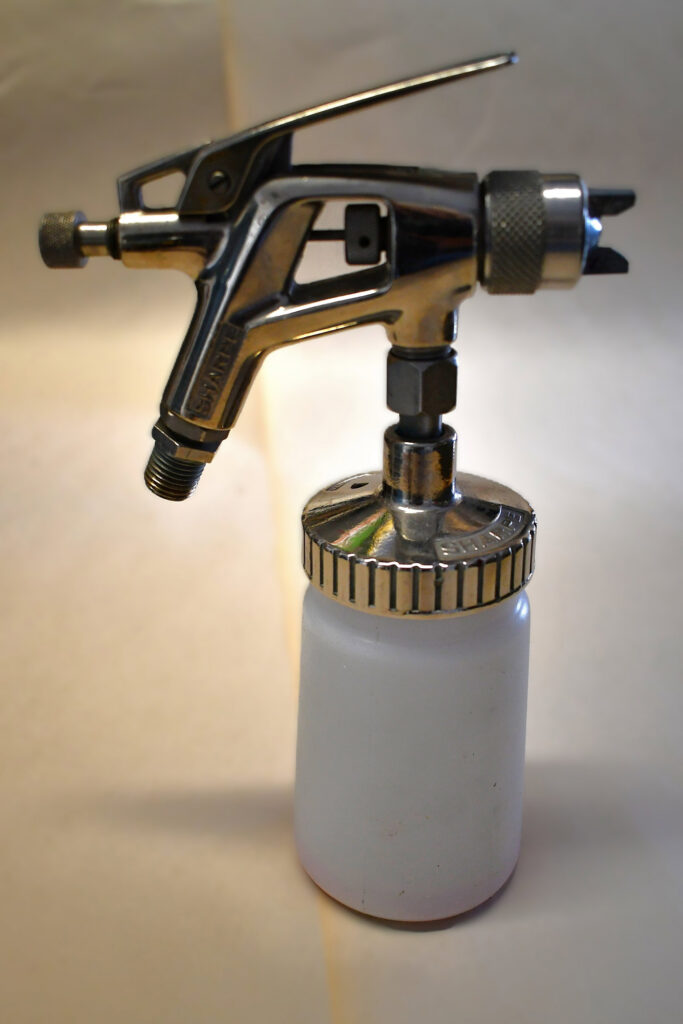

Spray Equipment
- Two spray guns, one for primers and the other for topcoats. (HVLP or LVLP)
- Air regulator and moisture trap.
- An air compressor large enough to support the guns (4 cubic feet per horsepower (CFM). For example, if your gun uses 8 CFM, you will need a 2-hp, two-stage compressor.

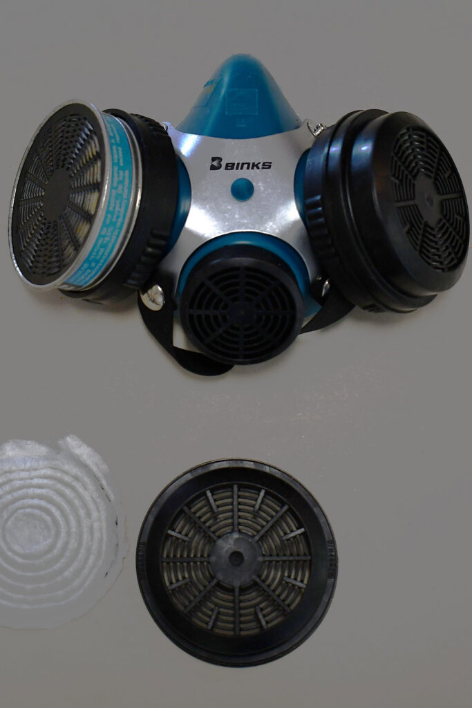

- Dual Cartridge Respirator with prefilters. These will extend the life of the more expensive cartridges.
- Air Fed Respirator – optional

Once the parts to be painted are thoroughly cleaned, it’s time to start masking. Complete masking of the interior and engine areas must be done to cover any part you don’t want exposed to overspray, such as tools and finished parts.

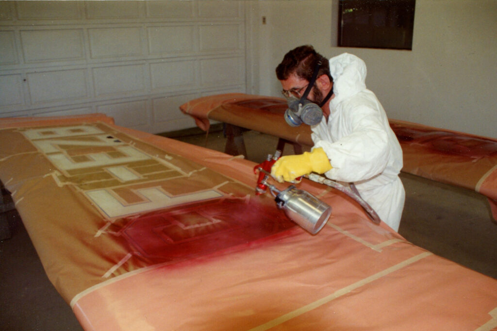

![The author spraying the registration letters on his Stinson 108 wings. [Credit: Mike Davenport]](https://www.kitplanes.com/wp-content/uploads/2026/03/Painting-EZB-1024x682.jpg)

When you have reached the point where there’s not much left to do, you’ve got all the materials and equipment, it’s time to start painting. If you’ve never done it before, the good news is that you are starting with the primer. A great place to learn, and if you run the primer, it’s no big deal, as you have to sand it anyway.
Paint and cleaning solvents and hardeners are toxic, so wearing a mask is not optional. For priming and small parts painting, I use a dual charcoal cartridge respirator. Just remember to change the cartridges and the paper prefilters often. If you can smell solvents through the mask, it is time to change. This type of mask can be more expensive, but it is a minor cost compared to the overall project cost.
For large or complete paint jobs, consider an air-fed respirator to breathe clean air. This requires the use of a separate oil-free air supply. I have a ¾ hp oilless compressor for this, along with sufficient hose to put the compressor outside the booth where it can draw clean air. It means dragging another hose into the booth, but the benefit of clean breathing air far outweighs the inconvenience. These respirators are most readily available from your local autobody shop supply house but be aware that they are not cheap.
