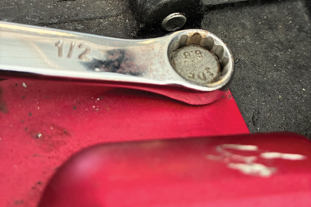

I believe that the picture shows a 1/2 inch wrench on a metric bolt (probably 8 mm with either a 13 mm head if it is ISO or 12 mm if it is JIS). Note the 8.8 marking on the bolt which is an ISO standard grade marking roughly equivalent to grade 5.
