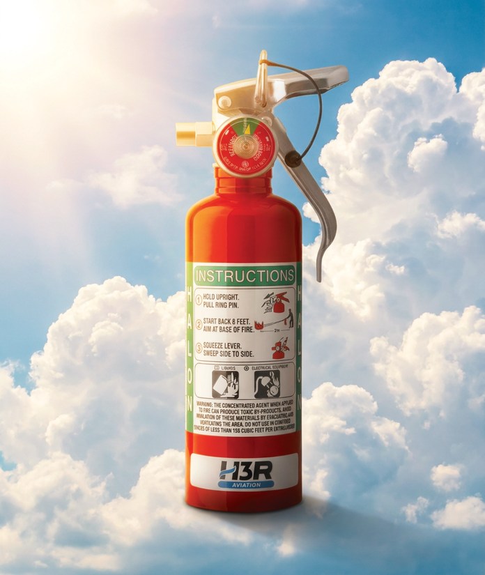

It’s easy to think of a fire extinguisher as a last-minute accessory: buy one, bolt it somewhere convenient, and move on. But in a homebuilt aircraft, the extinguisher’s agent, rating, mounting location, and bracket all affect whether it can be used quickly in an emergency.
The choice can matter after the fire is out, too. Some agents leave residue that can work its way into wiring, avionics, and inaccessible spaces, creating significant cleanup and repair problems.
Builders make hundreds of decisions about everything from fuel lines and wire routing to panel layout and cockpit ergonomics. The cockpit fire extinguisher deserves the same level of design judgment.

FAA guidance generally does not recommend dry chemical agents for internal aircraft use. That points builders toward clean-agent extinguishers, typically halon or approved halon alternatives.
What Builders Need to Know About Clean-Agent Extinguishers
Clean agents such as Halon 1211 and approved halon alternatives avoid the powder problem. They don’t obscure visibility or leave corrosive residue behind.
They can also reach spaces where powder may not be as effective. This makes them well suited to cockpit fires that may start behind the panel, in wiring, or around avionics.
“If you’ve got a fire hidden behind a panel, you can spray halon into a gap, and because it’s a gas, it can get to that fire and put it out,” Dieter said.
Halon 1211 has long been used as a performance benchmark in aircraft fire extinguishing. Instead of simply smothering a fire, it chemically interrupts the combustion process.
Some builders assume halon is no longer an option because new production ended in the 1990s for environmental reasons. But in the United States, new extinguishers charged with recycled Halon 1211 are still available.
Halon continues to be used in aircraft today because it’s compact, effective, electrically nonconductive, and leaves no residue after discharge.

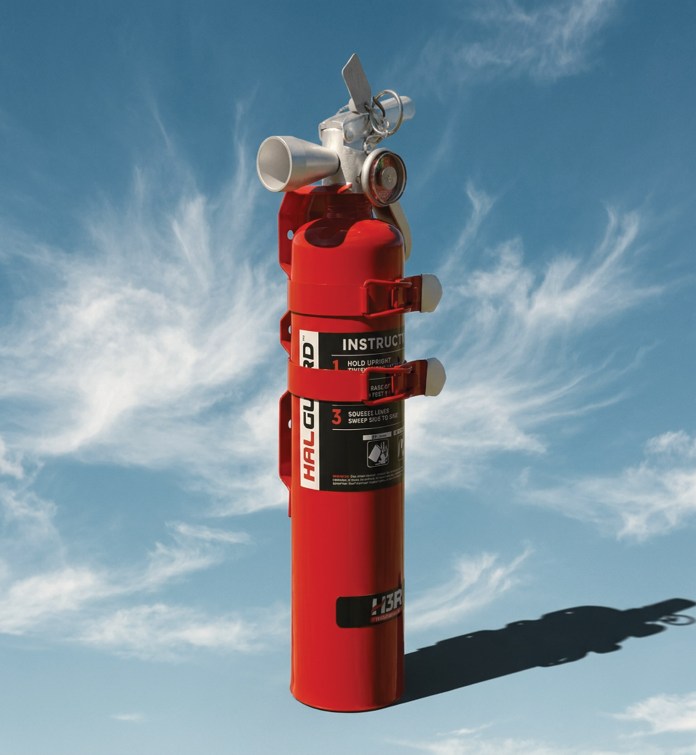

For cockpit use, builders should look for a 2B:C extinguisher. The B rating means it’s rated for flammable-liquid fires (such as fuel or oil), and the C rating means the agent is suitable for use around energized electrical equipment.
It’s important to compare extinguishers by rating, not just size.
“Builders might look at a one-pound Halotron 1 extinguisher and a one-pound Halon 1211 extinguisher and assume they’re equivalent, but they’re not,” Dieter said. “Halon is roughly twice as effective.”
A one-pound Halon 1211 extinguisher can carry a 2B rating, the minimum benchmark identified in FAA guidance for small aircraft compartments up to 200 cubic feet. To get the same 2B rating with Halotron 1, a builder would need a 2.5-pound unit, which means more weight and more space.
That’s why the listed rating matters more than bottle size or weight.
