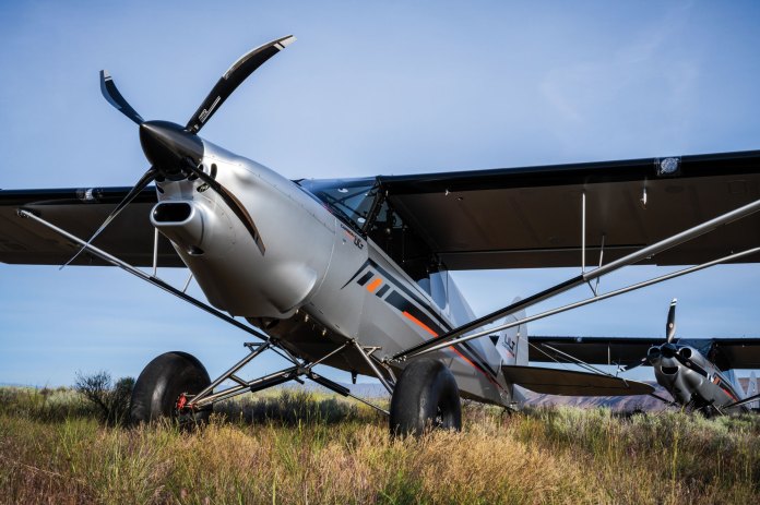

The heart of the ULT is the TurboTech TP-R90, a regenerative turboprop from the French aerospace firm TurboTech. “Regenerative” is not garnish; it is the whole point. The engine recovers and reuses heat energy that would otherwise be lost through the exhaust, preheating incoming air through a recuperator and reclaiming energy a conventional small turbine simply throws overboard. The result, both companies claim, is fuel consumption comparable to the gasoline-powered Carbon Cub UL—addressing the historic demerit of small turbines, which have always been thirsty—while retaining the qualities pilots covet, i.e., smoothness, durability, and the mechanical simplicity of a rotating group with a fraction of a piston engine’s moving parts. TurboTech describes the TP-R90 as its flagship engine, combining patented regenerative turbine technology with full-authority digital engine control, and the Carbon Cub ULT is the company’s first production aircraft partnership in the United States.
The ULT designation itself is a small piece of wordplay CubCrafters is happy to explain. The original “UL” reflected the Carbon Cub UL’s focus on lightweight performance and unleaded-fuel compatibility. The new “UL’T” adds “T” for turbine—while also standing, as the company puts it, for the “ULTimate” evolution of the backcountry Carbon Cub platform.
The engineering underneath that tidy branding is the harder story. Small turbines have tempted light-aircraft designers for decades and defeated most of them, because a conventional gas-turbine cycle is brutally inefficient at the modest power a two-seater needs; the fuel flow that keeps a big PT6 economical becomes ruinous when scaled down. TurboTech’s recuperated cycle is the answer, trading a heavier, more complex engine for a fuel burn that finally makes sense at this end of the spectrum. Pairing it with an airframe already engineered for light weight and low drag is what lets CubCrafters claim piston-like economy from a turbine—a sentence that would have drawn skeptical looks not long ago. TurboTech, for its part, says it developed the TP-R90 specifically for light aircraft, with push-button starting, single-lever power control, and simplified maintenance as design goals from the outset rather than afterthoughts. Whether the real-world economy holds up is exactly what the Yakima flight-test program is there to prove, and it is the figure this magazine will be watching most closely once airplanes reach customers.

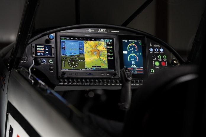

What that turbine means in the cockpit is a deliberate absence of ceremony. There is no turbine-management ritual, no watching ITT like a hawk during a hot start. Starting the airplane is as simple as turning on the master switch and pressing the start button; the dual-channel FADEC then automatically manages fuel flow, ignition, engine temperatures, and propeller operation throughout the start sequence and the entire flight envelope, eliminating procedures traditionally associated with both piston and turbine aircraft. Power is a single lever. A dedicated turbine-engine display joins the Garmin avionics on the panel, and CubCrafters says the combination delivers a remarkably simple flying experience—pilots focused on the adventure rather than the engine.
“The first thing pilots notice is how effortless the airplane feels,” says Brad Damm, CubCrafters vice president. “You push and hold the start button for a few seconds, and the aircraft is ready to go fly. The FADEC handles the details, the turbine is incredibly smooth and quiet, and the aircraft retains the lightweight performance and responsiveness that pilots love about the Carbon Cub. It’s one of those airplanes that makes you look for excuses to go flying.” His counterpart at TurboTech frames the partnership in similar terms. “CubCrafters has an exceptional reputation for innovation and engineering excellence in backcountry aviation, and the Carbon Cub ULT is an ideal platform to demonstrate the capabilities of the TP-R90 engine,” says TurboTech CEO Damien Fauvet. “Together, we believe we are introducing a new generation of efficient, practical, turbine-powered recreational aircraft.”

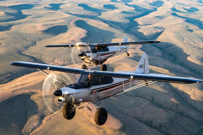

CubCrafters’ preliminary specifications place the ULT squarely inside the MOSAIC envelope while trading on the turbine’s power-to-weight advantage. Empty weight is estimated at 880 pounds, with a maximum gross of 1,865 pounds for an estimated useful load of 985 pounds—a remarkable figure for a two-seater and a direct dividend of the carbon-fiber-and-chromoly structure the Carbon Cub line is built around. Fuel capacity is 44 gallons of Jet A. Cruise is estimated at 130-plus mph and stall at a MOSAIC-friendly 32 mph, with a claimed takeoff roll as short as 50 feet and a landing roll of 90 feet—the short-field pedigree the airplane inherits intact from CubCrafters’ latest generation of aerodynamic refinements. Endurance is pegged at an estimated 5.2 hours and range at roughly 682 statute miles. Dimensions mirror the piston Carbon Cub UL: 23 feet 3 inches long, a 34-foot-3-inch wingspan, and 179 square feet of wing.
These are, it must be said, estimates. The ULT has been in active flight testing near Yakima, where CubCrafters says the program continues to validate performance and refine the aircraft ahead of the Oshkosh debut, and the specifications carry the usual subject-to-change caveats that attend any airplane still earning its numbers. But the design targets are coherent, and they describe an airplane that behaves like a Carbon Cub until the moment you firewall a turbine.
