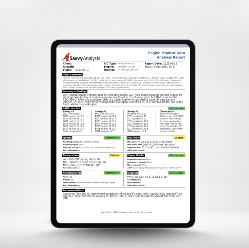

Leading the Pack: Savvy Aviation
Savvy Aviation has established itself as the premier analytics service provider for homebuilt and experimental aircraft engines. Their SavvyAnalysis platform supports the most common engines found in experimental aircraft: Lycoming, Continental, Jabiru, and Rotax powerplants.
What sets Savvy apart is their deep understanding of how these engines behave in experimental installations, which often differ from certified aircraft operations. Their analysis methods account for the unique operating profiles typical of homebuilt aircraft, from pattern work to cross-country touring.

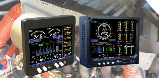

EDM Series Monitors
JP Instruments has long been a favorite in the experimental community with their EDM series monitors. The EDM-350, EDM-730, and EDM-830 systems provide professional-grade data logging while maintaining compatibility with analytics services like Savvy Aviation. These monitors offer data export capabilities that seamlessly integrate with post-flight analysis platforms.
For budget-conscious builders, the ENGOOD Engine Monitoring System represents an interesting alternative. Designed specifically for fixed-wing experimental aircraft, this $1,299 system monitors all critical parameters including CHT, EGT, RPM, MAP, oil temperature and pressure, and fuel pressure and flow. At a fraction of the cost of certified equivalents, it provides data logging capabilities that work directly with Savvy Aviation’s analysis platform.
MGL Avionics
MGL Avionics has carved out a significant niche in the experimental aircraft market with their comprehensive engine monitoring solutions. The Blaze EMS-2 and XTreme EMS systems offer universal engine monitoring capabilities with special accommodations for different powerplant types.
What makes MGL particularly attractive to homebuilders is their systems’ flexibility. The XTreme EMS can adapt to various engine configurations, while offering special modes for popular engines like the Rotax 912/914 series. These systems include data export capabilities for analysis services and integrate well with MGL’s EFIS systems for builders seeking a complete avionics solution from one manufacturer.
