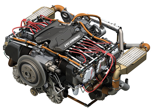

FADEC
Full Authority Digital Engine Control (FADEC) is not quite ready for prime time for most Experimental airplane builders. Such systems promise single-lever engine control for the pilot, with electronically controlled management of fuel injection, ignition and propeller in one unit. Aerosance (TCM) sold a few FADEC systems to Experimental builders but no longer offers them for Lycoming engines. Its energies have been focused on refining the system for TCM-powered Cirrus airplanes. Lycoming has a FADEC system on its new TEO-540 engine for the Lancair Evolution, but that technology has not been applied to smaller engines yet. Precision Airmotive has a system that manages fuel injection and ignition but not the propeller. Others are working on systems, and this is an area ripe for further development.
Lycoming has a complete FADEC system that they developed for their new TEO-540 engine. This technology will eventually make its way to their smaller engines.
