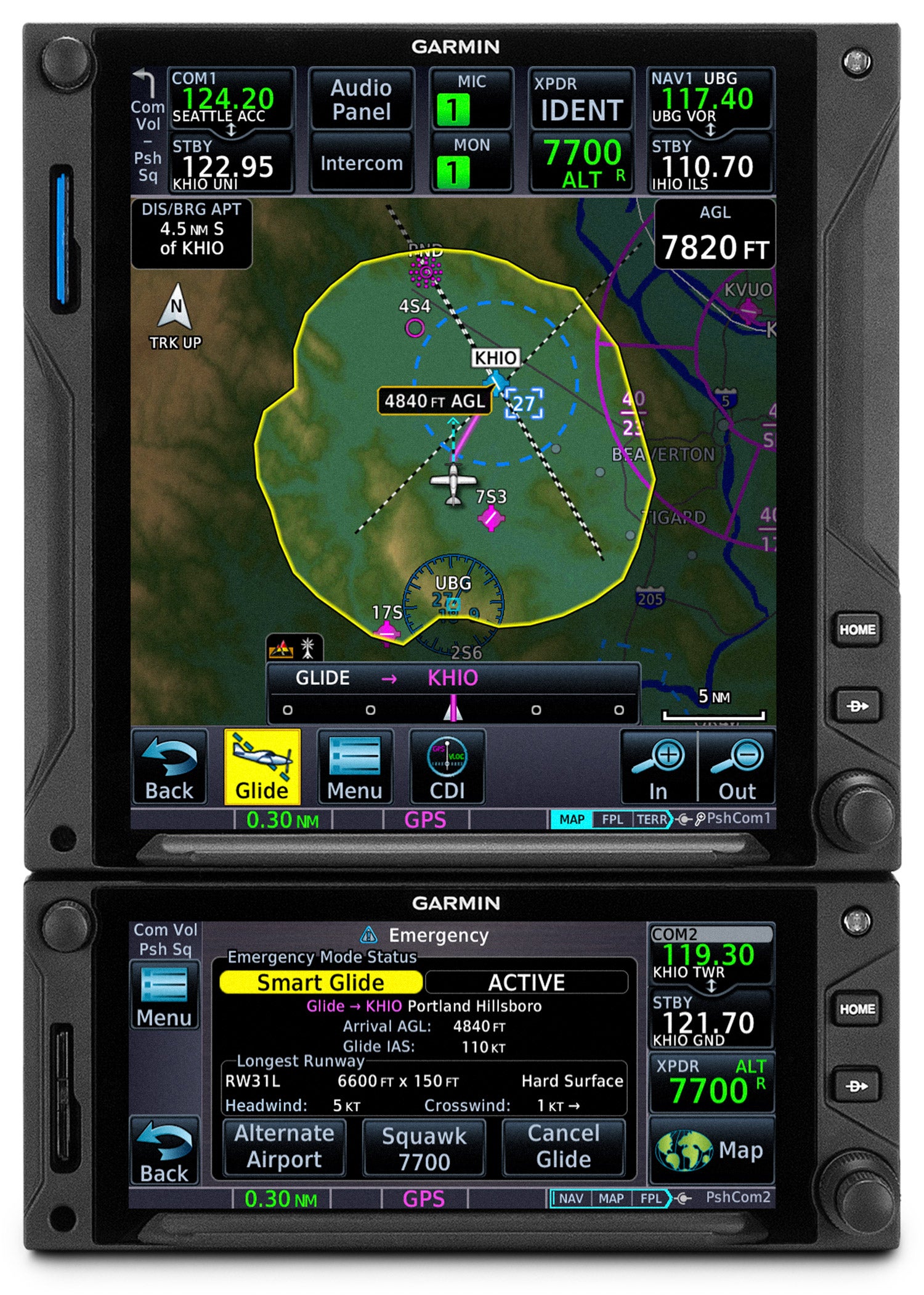

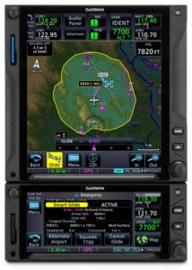

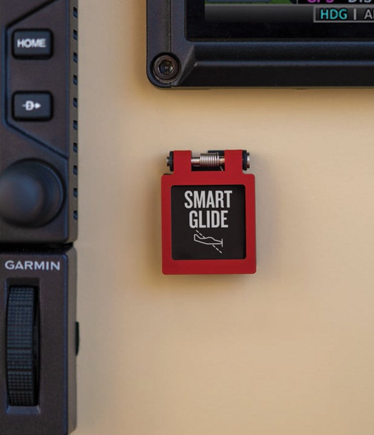

What is Smart Glide? The feature is an add-on to Garmin GTN Xi series retrofit navigators and when activated (with a panel-mounted switch or by pressing and holding the navigator’s Direct-To key), it helps find the best suitable airfield to put down. The system also indicates the best glide speed for the aircraft’s gross weight. Similar to the fuel endurance range ring on the navigators, Smart Glide uses a yellow glide-distance range ring that automatically appears on all configured moving map pages and uses real-time data to calculate an estimated glide ratio based on current aircraft glide performance and available wind data. It offers the pilot multiple choices of airports to glide to (when there are ones within gliding range), and calculates/displays a direct navigation path to the runway environment. It changes the CDI scale of the interfaced nav indicator to 0.30 NM, tunes the comm radio to the appropriate frequency for the destination airfield and when interfaced with a compatible Garmin transponder, provides a one-touch selection for the 7700 emergency code.

Are there other limitations? Smart Glide does not manage altitude. Configure the aircraft appropriately with the flaps and the landing gear (in a retrac) to make the landing yourself. Remember, this isn’t Autoland. But there are good visual cues along the way. Flashing textual annunciations alert the pilot of warning, caution and advisory conditions. These annunciations appear in a banner on the Emergency page and over the route display on the GTN Xi’s Map page. They turn solid or disappear after five seconds. There is an advisory alert (white text on a black background) that says Approaching Airport when the aircraft is 4 nautical miles out. Can’t make the field? You’ll see an Airport Out Of Range caution alert. If you make it to within 2 nautical miles, you’ll see a Maneuver And Land message warning alert.
