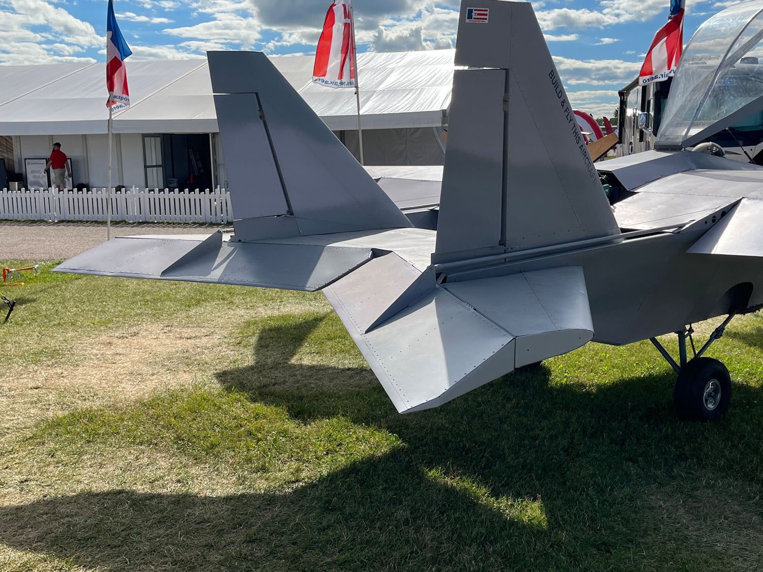

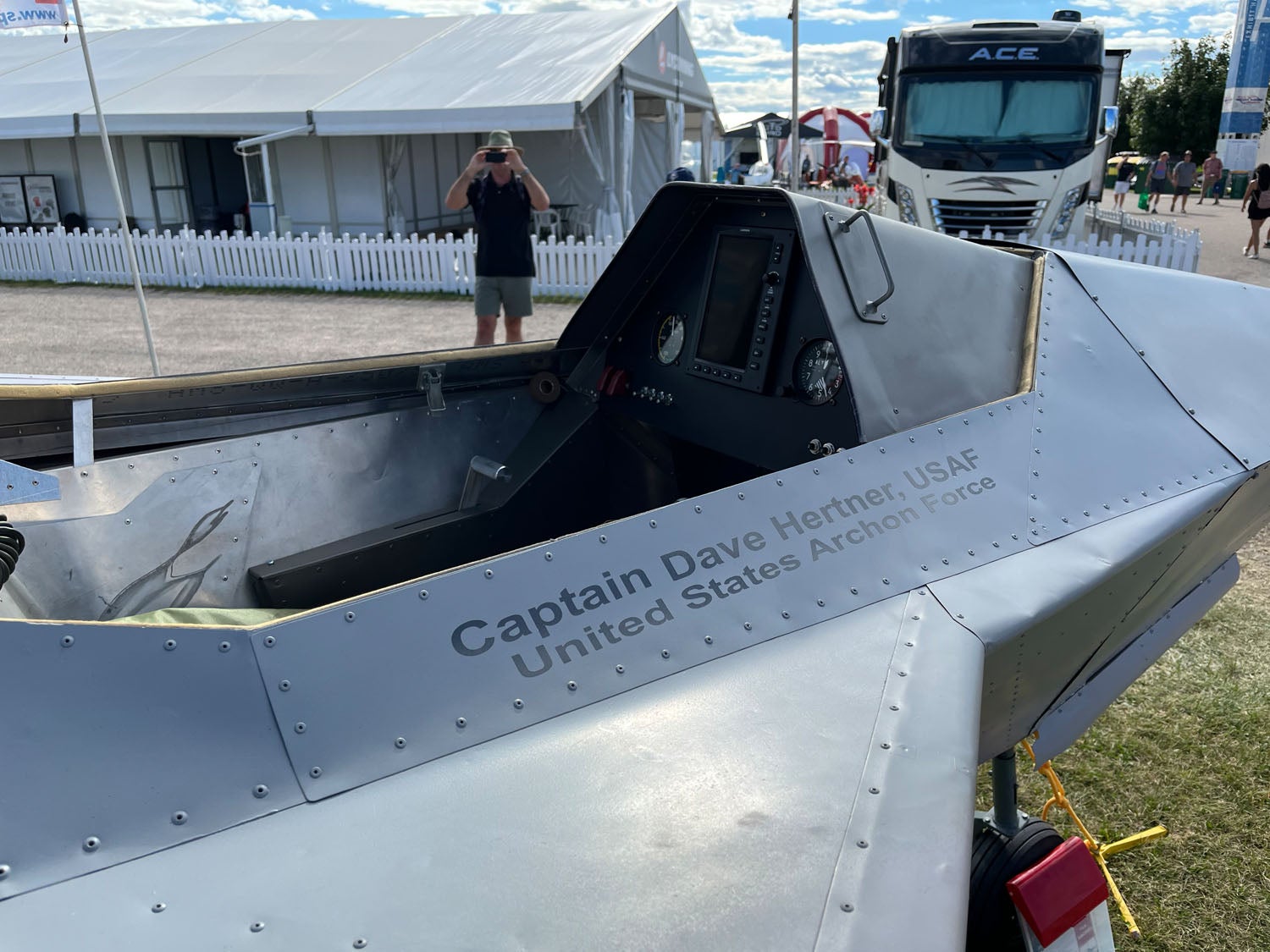

The original prototypes have been powered by a two-cylinder two-stroke engine, producing 40 horsepower. The airplane displayed at AirVenture has been transplanted with a 4-cylinder Rotax water-cooled engine, weighing more than twice as much and putting out 100 horsepower. The displayed prototype has .016 aluminum skins, which designer Iiiapoulous utilized in an effort to get the ship down to European ultralight weight. Hertner anticipates utilizing .020 skins for the U.S. model. The current empty weight is 422 pounds (201.1 kg), but that weight is expected to increase significantly with the thicker skins and engine accessories.
The engineering prototype has fully retractable landing gear and pushrod-controlled split elevators. The fit and finish of the prototype is crude, but the fighter-like form and lines of the craft are what has stopped attendees in their tracks. Several pilots have been skeptical that this display can actually fly, but Hertner points to several YouTube videos showing the prototype doing just that in Greece. Hertner reports that the prototype (with its original 40-hp engine) would cruise at 110 mph and stall at 40 mph. The VNE for the airframe has been set at 155 mph.
