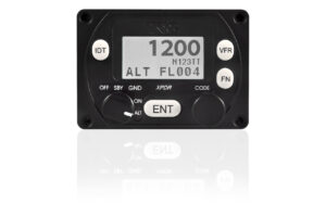

TT23 Controller Courtesy Dynon

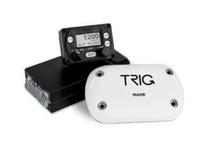

The compact transponder package from TRIG, Courtesy Dynon
The transponder is available in two versions:
TT23G: The TT23G features a built-in GPS receiver for pilots seeking an integrated ADS-B out solution. The TT23G is perfect for experimental and light-sport aircraft looking to meet ADS-B out requirements in the United States. In markets where ADS-B equipage is voluntary, the TT23G offers enhanced conspicuity and safety.
TT23: The TT23 is the same compact transponder without an internal GPS. For aircraft with a suitable GPS position source on board, the TT23 can be used as an ADS-B Out solution for both homebuilt and type-certificated aircraft in the US. An STC will be available to integrate with popular third-party GPS navigators, as well as the Trig TN70 Remote position source. For those who do not intend to equip with ADS-B out, the TT23 model is a high-quality, modern transponder with easy configuration options, making it suitable for any application.
The TT23 builds on the success of the popular TT21 and TT22 transponders, retaining the same user-friendly controls that pilots know and trust. The new models include a built-in altitude encoder and feature a bright, easy-to-read LCD screen for intuitive operation and dependable performance.
