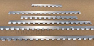

Heli-Coils are particularly useful for reinforcing threads in softer materials like aluminum castings or extrusions. For years VW engine builders have been changing the stock 10mm cylinder head studs with 8mm studs threaded into “case-saver” helical insert threads. My neighbor/builder Phil Hooper put Heli-Coil inserts in the aluminum door hinges of his Velocity RG to reinforce the thread engagement.

A typical thread repair kit will include some number of insert threads, an installation tool, and a tap. It may or may not include a drill bit, so be sure to verify that you have the correct size drill if the kit doesn’t come with one. Good quality kits are not cheap. I paid $40 for the 10-32 kit shown. It came with a dozen 10-32 inserts, a tap, and an installation tool. The coils themselves are $1 to $2 each when purchased by the dozen.
