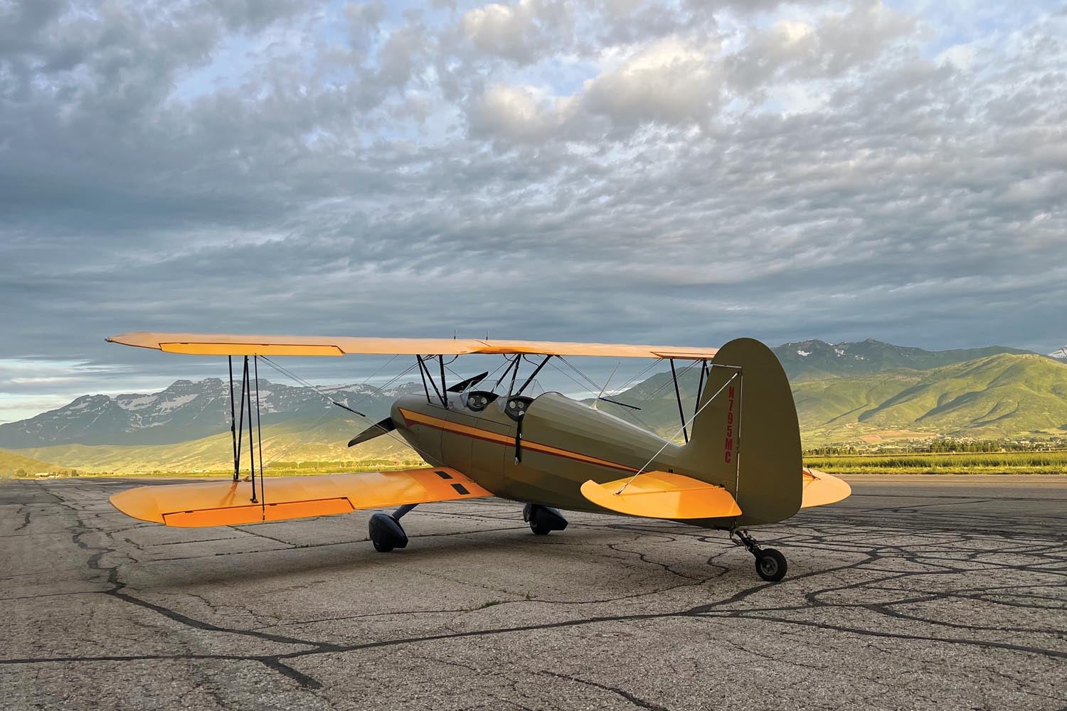

The Charger certainly looks cool. Heck, it is cool! Designed by the legendary Edwin “Ed” Marquart, it is a responsive yet easy-to-fly sport biplane. It is plansbuilt, so there’s no quickbuild option.
The fuselage is 4130 steel tubing with aluminum side panels from the cockpit forward. These make getting into the innards for inspection and repairs a lot more accessible. From the rear of the cockpit to the tail, it is fabric covered.
The wings are spruce and fabric, with a NACA 2412 airfoil swept back at 10°. The upper wing angle of incidence is 1° while the lower wing is 2°. Each set of wings is braced with seven flying wires per side.
The cantilevered landing gear is bulky and stout. Robust even. It has tapered hollow box legs welded from 0.090-inch flat 4130 steel with rubber donuts at the upper ends for shock absorption. It looks like it came off a battleship.
The horizontal stabilizer is adjustable via a jackscrew like a Piper J3 Cub. The ailerons and elevators are actuated by pushrods, giving a very smooth feel.

While John is modest about his achievement, the judges saw fit to award him the 2016 Plansbuilt Outstanding Workmanship Award. Going over the aircraft, the fit, finish and attention to detail is impressive. While the project started with good bones, John took it to the next level while bringing it to completion.
