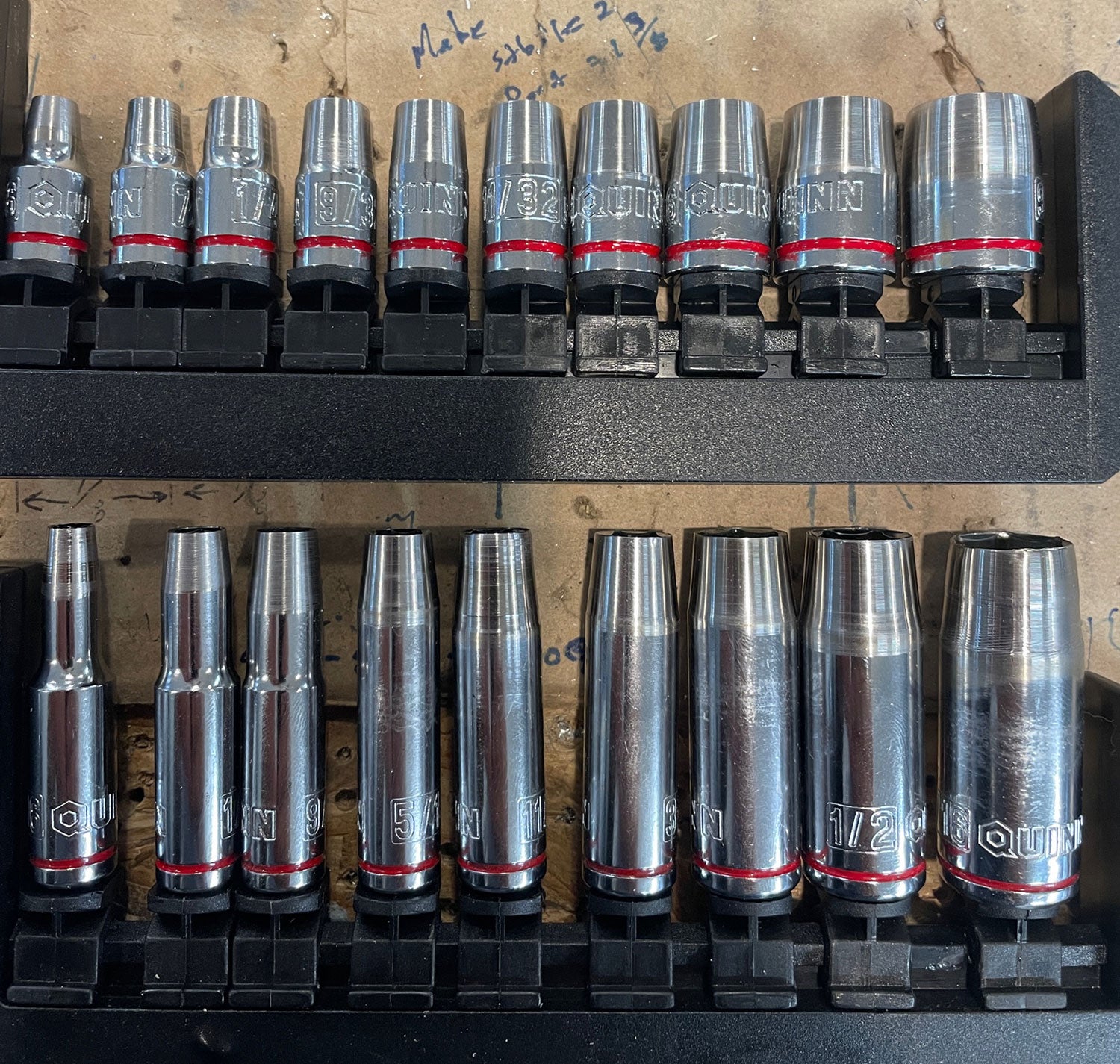

More recently, I was working on another little task that required a very narrow-nosed socket wrench. In the past, I have butchered cheap sockets on a bench grinder, most notably to have a tool that fits Lycoming connecting rod big-end bolts. But now realized I could have a whole set of such custom sockets with the new lathe skills I’d been learning. Off to Harbor Freight for the sacrificial victims.
It’s a simple matter to set the lathe up to move the tool at a 5 degree taper angle, and I proceeded to turn down the entire set of sockets (one at a time) until they were tapered to a knife edge. Given that it is a set of small sockets and torques rarely get very high, they should do the job—whatever that might be—in the future. Since things were all set up, I did regular and deep sockets at the same time!
