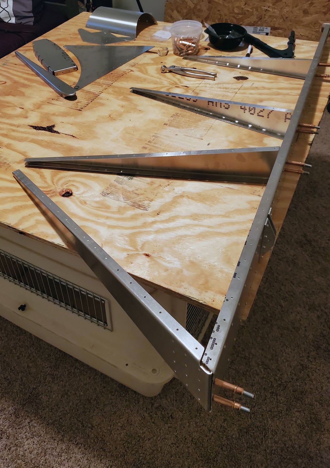

The rudder kit arrived a day before the workshop. Given that I first contacted Zenith about participating just 10 days earlier, I was amazed at how quickly they were able to get me the kit and the tools. The rudder kit itself was securely packed; all the parts were well wrapped and arrived in pristine condition. I unpacked and verified the inventory with the included packing list. As part of the separate toolkit they offer, Zenith supplied a hand riveter, Clecoes and Cleco pliers, a measuring tape and drill bits.
Perhaps the peskiest thing about getting the parts ready was removing the stickers with the part numbers on them. They proved to be infuriatingly tenacious. After experimenting with a few of the recommended removal methods, I found—admittedly much to my surprise—that a one-to-one solution of baking soda to coconut oil, rubbed in with a cloth, worked best.
I did use a flat file and a drill bit to deburr the parts before getting started. It was around that point I discovered my drill was MIA. With less than 24 hours until go-time and not being able to venture out to get a new one, I did without. That led to being very, very careful about how I was setting the rivets and occasionally having to use a bit more brute force than I would have preferred. For this project, it ended up only being a minor issue but not one I would care to repeat.

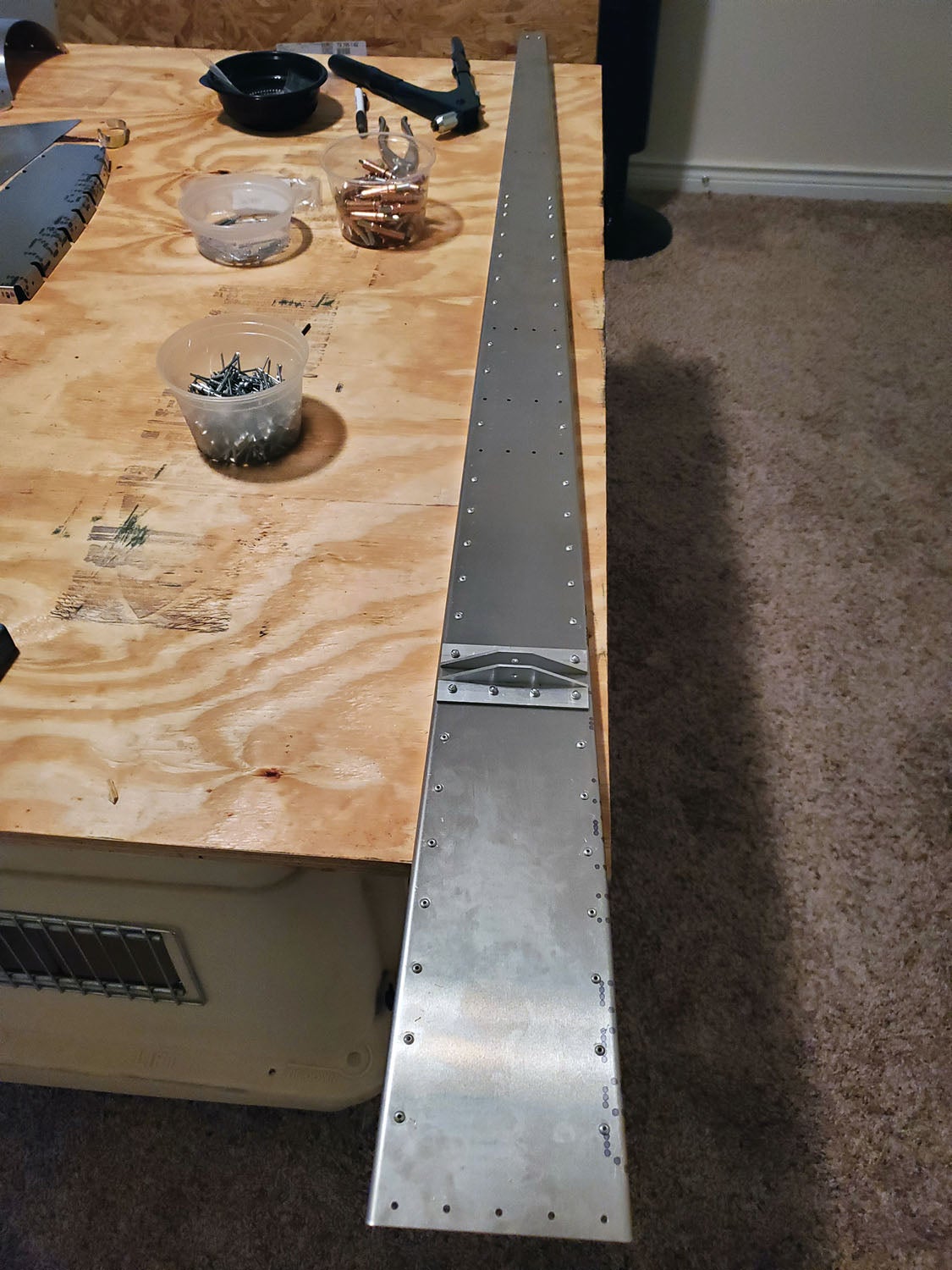

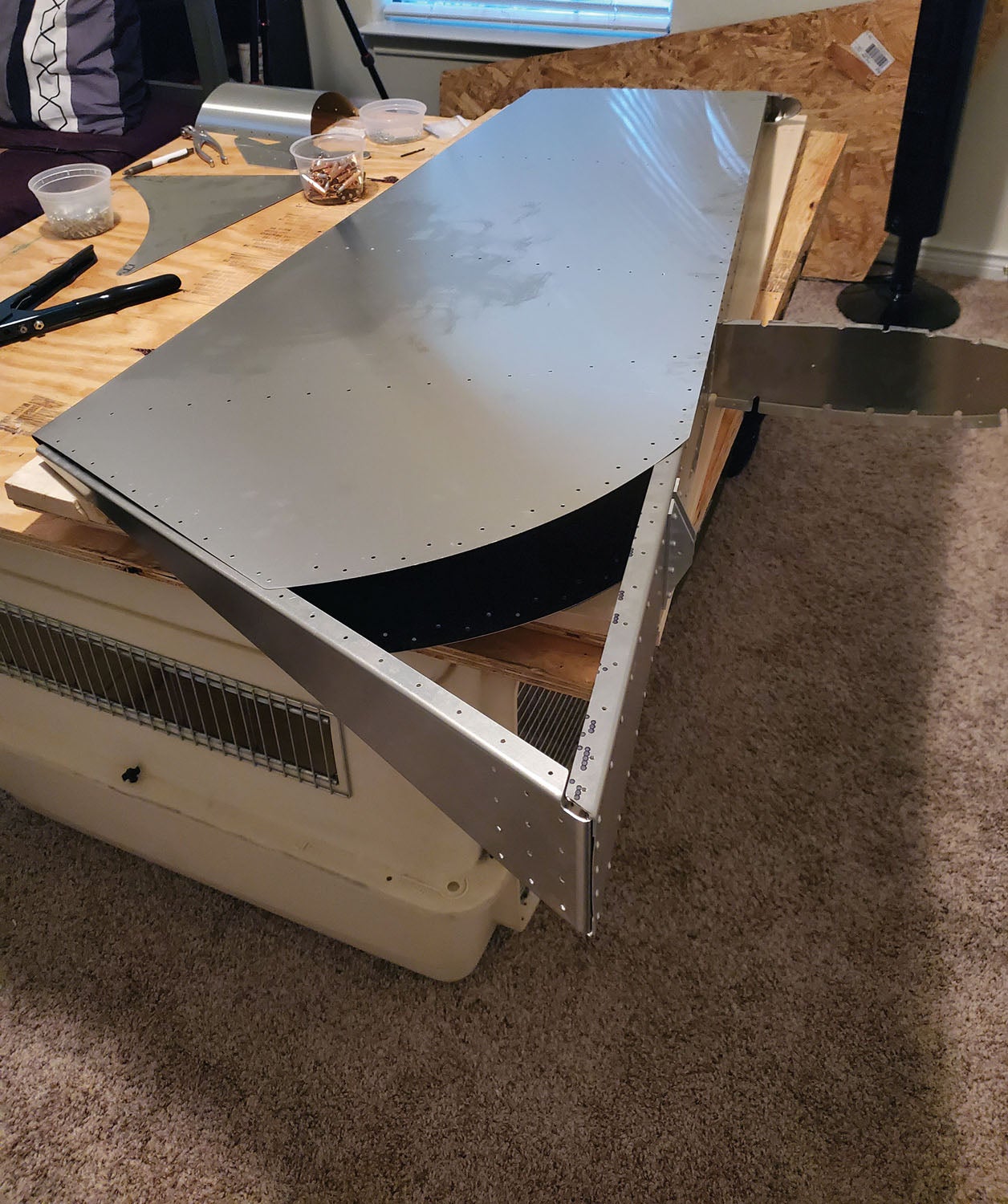

The workshop started at 9 a.m. Central time. After a quick round of intros, Roger walked us through assembling the rudder skeleton, demoing the process as we all worked. Once the majority of the participants were finished with a section, he moved us along to the next. He and Sebastien kept an eye on us builders throughout the day and offered suggestions and corrections as needed.
The building process itself was remarkably simple. Since the rudder parts are all predrilled and bent—and aren’t heavy or big enough to need a second pair of hands—it was mostly a matter of lining them up, clamping them together and riveting. That said, there’s a huge difference between my amateur ability to make all the bits stick together and the craftsmanship displayed by the people who knew what they were doing. For me, that’s where attending the workshop made the most difference. I picked up a lot of tips on how to approach the project, tricks regarding tool use and a heads-up about trouble spots to watch for that likely would have taken me forever to sort out on my own.

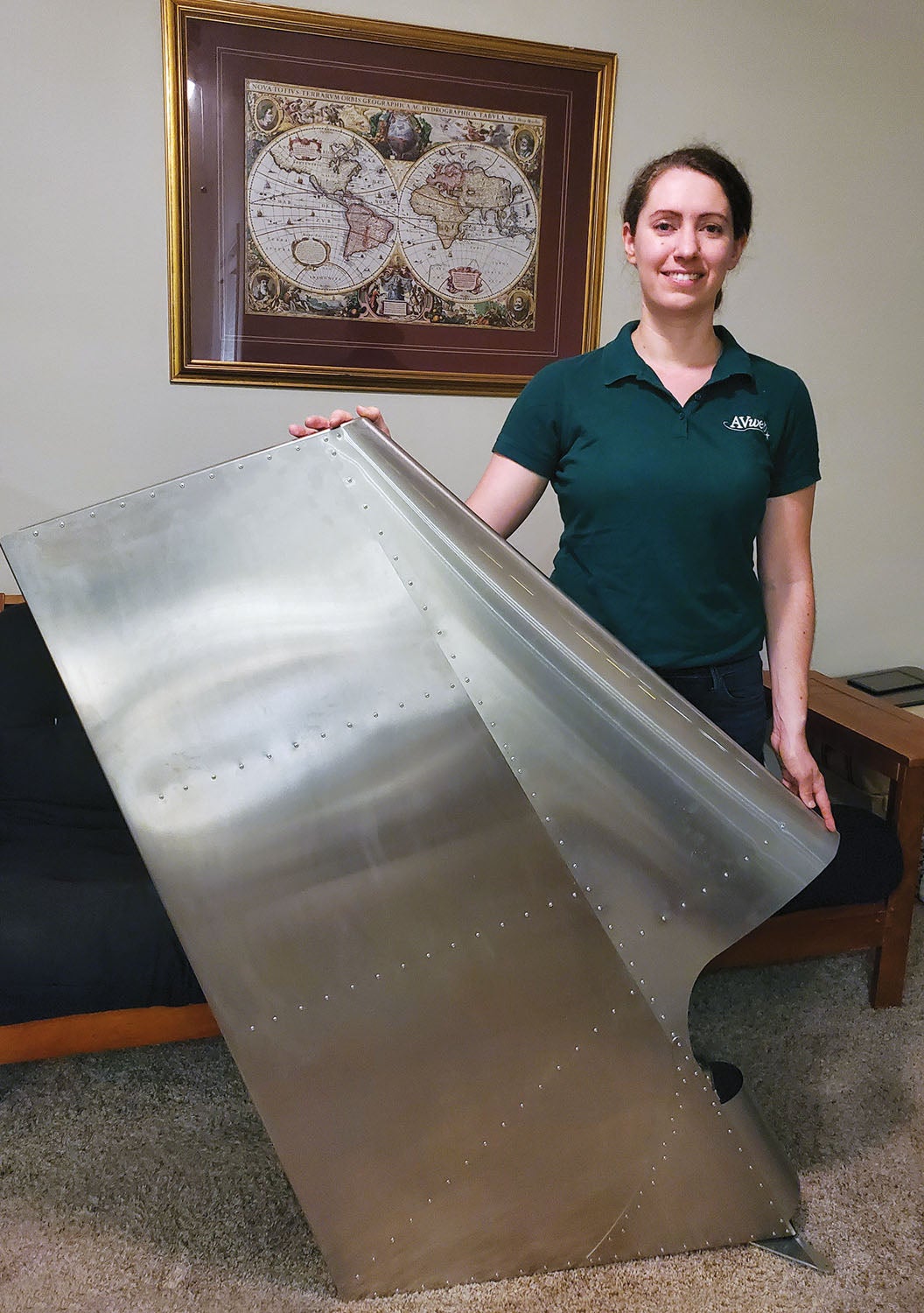

While I wouldn’t want to see Zenith switch to doing only online workshops—and I very much doubt that’s their plan—the ability to hold them seems to be helping the company reach people for whom making the trip would be challenging. One participant had his young children helping off and on during the day, which likely would have been difficult, if not impossible, to do at the factory. For my part, it meant I could take half a day for building and be back at my desk in time to turn out a few news stories for our sister site, AVweb.
As a first-time builder, attending the workshop provided a lot of useful support. It helped to know that if a problem arose, there were several highly knowledgeable people on hand to get it sorted along with providing extra eyes to catch my newbie mistakes. It was also just plain (plane?) fun!
