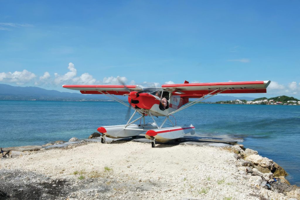

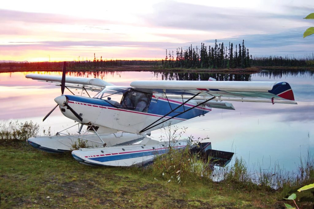

The kit also does something newer designs sometimes don’t: it leaves room for the builder to make decisions. The 701 has been completed with Rotax 912s, Continental O-200s, Jabiru fours, Viking Honda conversions, and the original Rotax 582 two-strokes the early prototypes flew behind. Floats, straight and amphib. Skis, straight and wheel-ski. Folding wings, extended-range tanks, belly pods, camera mounts for the wildlife-survey crowd, vinyl wrap for the builders who don’t want to spray paint in a rented hangar. The sheet-metal construction is forgiving enough that all of this is bolt-on rather than redesign-and-rebuild.

Field options Floats (straight or amphib), skis (straight or wheel-ski), folding wings, extended-range tanks, belly pods, camera mounts.
