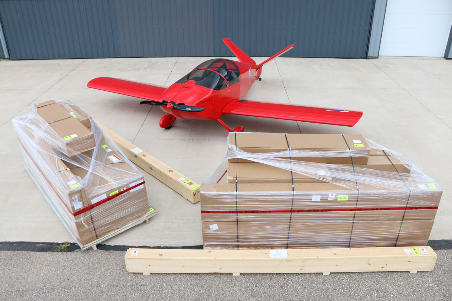

Sonex-B kit. (Photo: Sonex Aircraft)

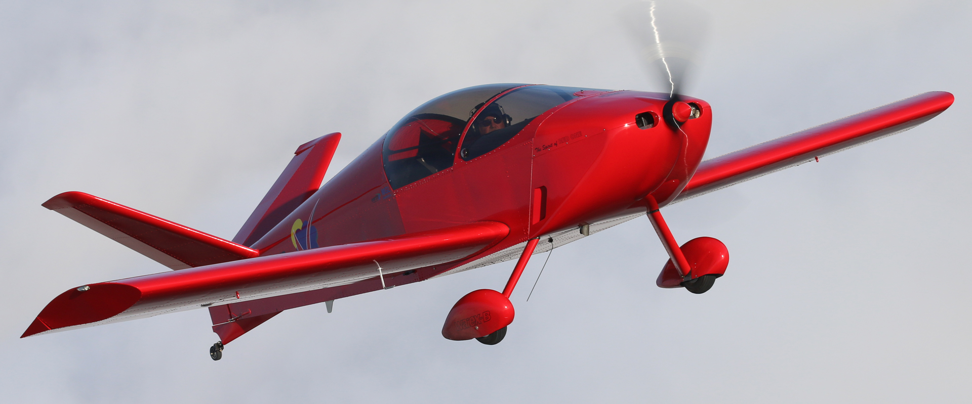

According to the company, “Following a series of engineering studies and flight tests, Sonex and Waiex owners may designate a max gross weight of 1220 pounds for aircraft with 100 hp or more.” Previously, the factory’s recommendation was 1150 pounds, so this is a useful bump of 70 pounds. “We expect these changes to be very popular and greatly expand the appeal of the Sonex and Waiex to today’s homebuilder,” said Sonex owner and president Mark Schaible.
Another consideration is stall speed since the Sonex and Waiex conformed to LSA limitations in that realm. Fortunately, Sonex says that “stall speed testing has proven the aircraft still qualify for Sport Pilots to fly under the existing rules.” Sonex says the models now stall at 50 mph clean and 43 mph with full flaps.
