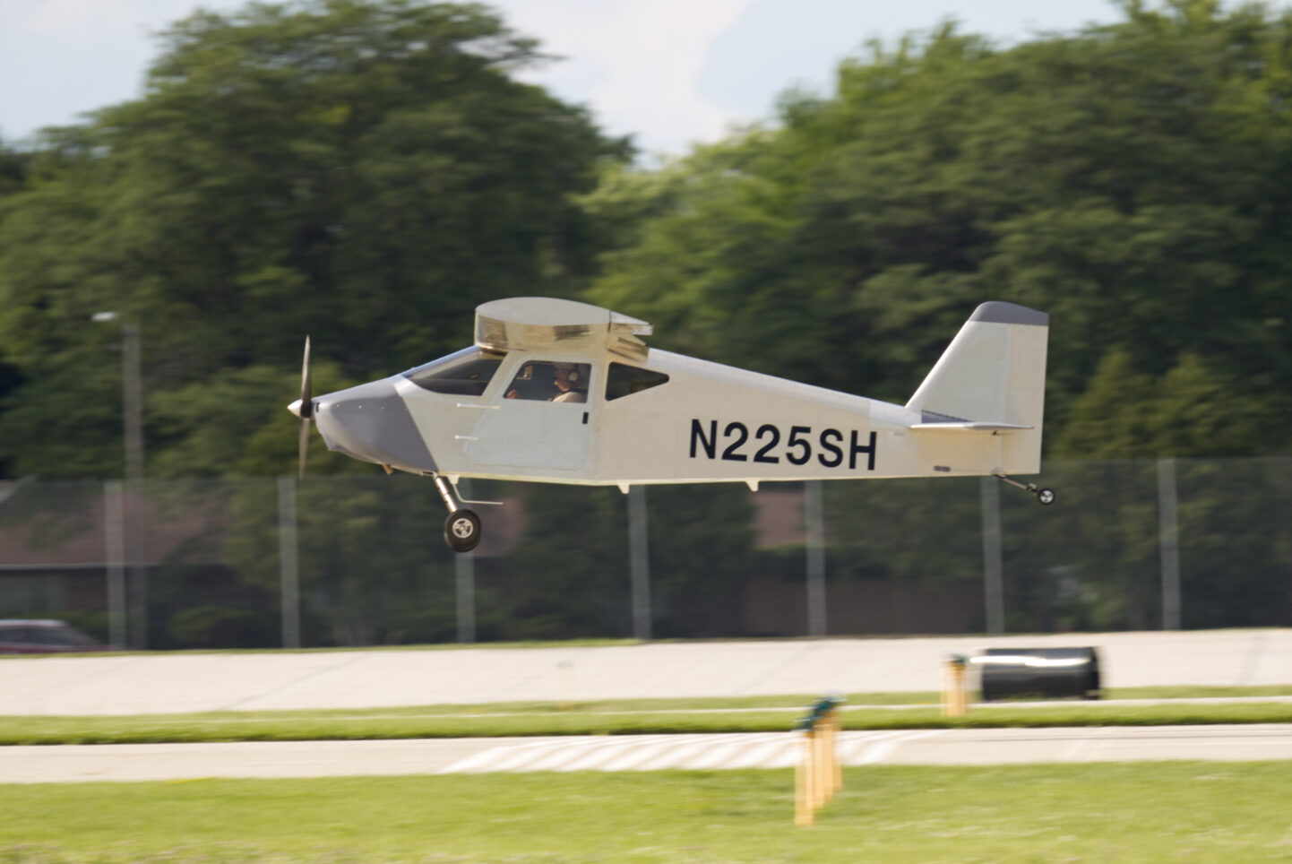

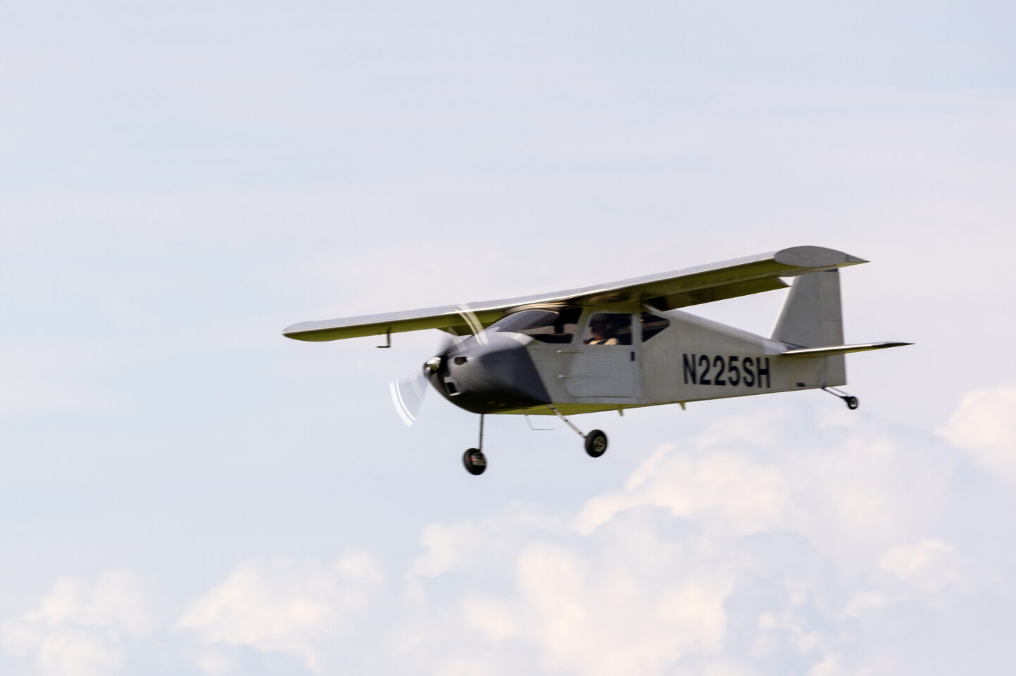

Sonex announced the first flight of the Sonex Highwing, which took place the evening of Monday, June 30, 2025. The aircraft was piloted by Sonex Advisory Board member Joe Norris.
The initial flight was kept brief due to a latch issue with the passenger-side door. Despite this, engine temperatures remained in the green, and the aircraft performed as expected, requiring only minor rigging adjustments. The prototype’s weight and balance are on target, with an empty weight of 816 pounds.
Additional test flights will commence soon, with wheel pants and gear leg fairings installed. Sonex will begin collecting and publishing performance data in the coming weeks.
