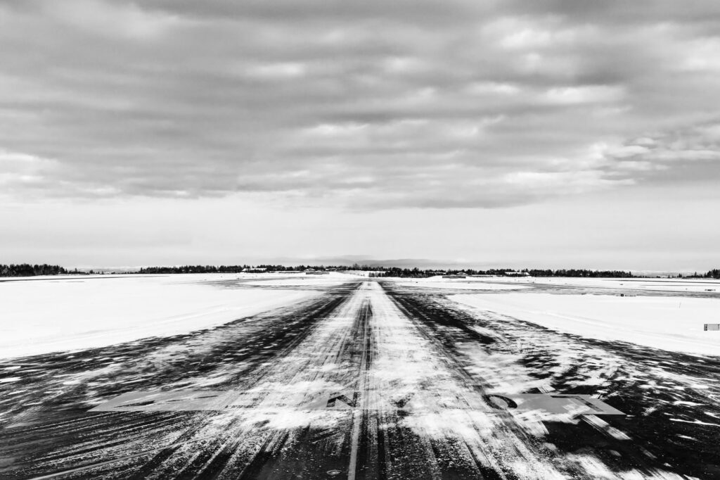

Packed snow and ice on the runway, often the result of attempted snow removal, provides much less braking traction than loose snow. On such surfaces, one should double the usual dry-surface stopping distance, just for starters, and you need to be aware of a significant crosswind component’s effect on your ability to hold the airplane straight. A wet, melting snow/ice surface presents a “nil” braking action. Snow can also lead to “reverted rubber hydroplaning” when locked-up tires under panicky braking generate heat from sliding, creating steam under the immobile tire that melts away the tread while providing no braking.
If at all possible, check out the runway conditions at a little-used airport on the ground with a four-wheel drive vehicle before attempting flight. Look for varying snow accumulation, hidden drifts, ruts and previous removal debris. On the other hand, assessing the suitability of a landing surface from above, with no input from observers on the ground, is difficult when all you can see is unbroken white. Be not the first to try a landing; look for tracks left by previous users, and note the difference between tricycle landing gear and four-wheeled vehicles. Snow depth is tricky to ascertain, even from a low pass; if you can’t tell for sure, don’t try to land. I have made experimental touch-and-goes on an unbroken snow-covered runway, but that technique carries some risk.
