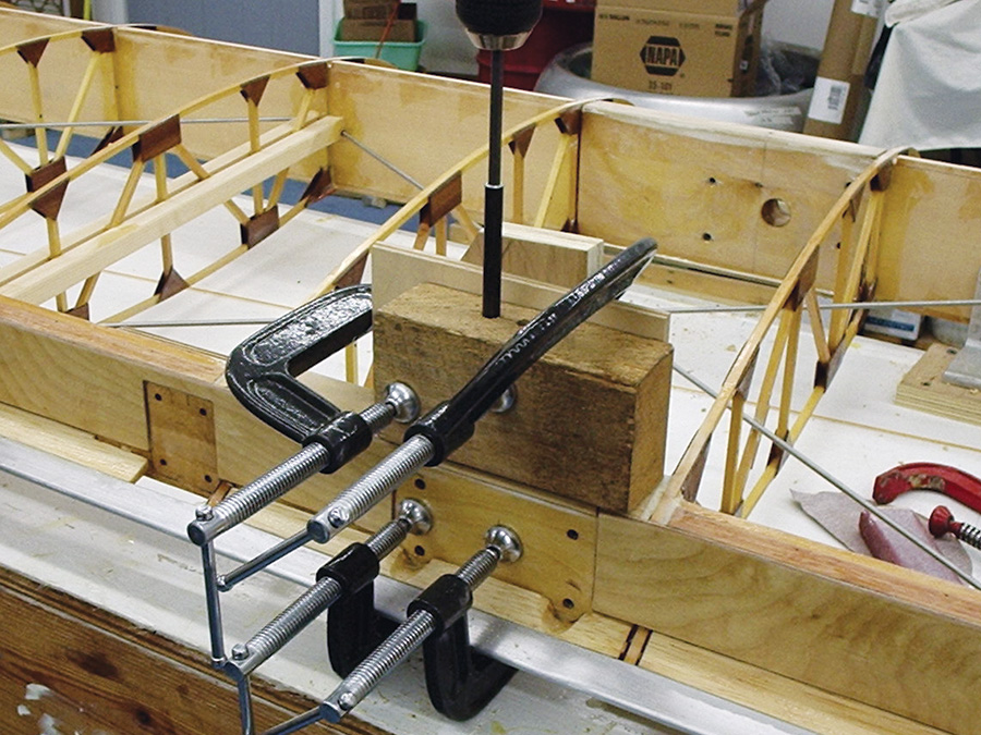

Drill blocks can have many variations to fit the task at hand. The block in Fig. 3 was fabricated to drill center and bolt holes in the hub of a large maple propeller. It served as a jig for hole position, as well as ensuring the holes were perfectly perpendicular to the propeller’s flange face (Fig. 4).
The drill block’s reference plane need not be perpendicular to the drill axis. Let’s return to our spruce spar example. The stable reference is the 4-inch deep side of the spar, not the narrow 1-inch width. The drill block is fabricated as previous, with a base plane perpendicular to the drill guide, but then a second plane is cut at 90 degrees on the side of the block, with the surface being 0.5 inch from the guide tube center (Fig. 5).
drill block 004
Fig. 4
Clamp a chunk of heavy plywood or metal to the 4-inch spar face, add a spacer equal to the spar reinforcement plate thickness (if there is one), clamp the drill block into place, insert a long bit, and pull the trigger (Fig. 6). The hole will be perfect.
