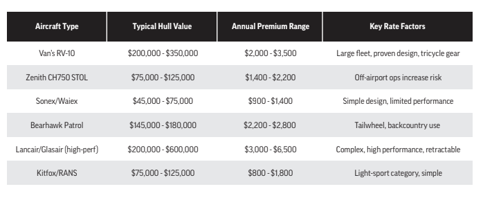

Aircraft Type and design pedigree ranks among the most influential premium determinants. Insurance underwriters favor well-proven designs with substantial fleet populations and predictable handling characteristics. Van’s Aircraft RV series enjoys particularly favorable treatment from underwriters due to the large fleet size (over 10,000 flying RVs), excellent safety record, conventional construction methods, and benign handling qualities. A builder completing an RV-10 can expect insurance quotes significantly lower than a builder completing a one-off design or a kit with a small fleet and limited safety history.
Hull Value directly impacts premium costs. Most insurers price hull coverage at approximately 1.0 to 1.5 percent of agreed hull value annually for piston experimental aircraft, with turbine and turboprop aircraft commanding slightly lower percentages (0.6 to 1.2 percent) due to different risk profiles. An RV-10 valued at $200,000 might carry an annual premium around $2,050, while a Zenith CH750 STOL valued at $75,000 might cost $1,650 annually.
Landing Gear Configuration substantially affects underwriting decisions and premium costs. Fixed tricycle gear aircraft receive the most favorable rates and lowest pilot experience requirements. Conventional gear aircraft demand higher pilot qualifications—typically a minimum number of dual instruction hours in type—and carry higher premiums due to increased ground loop risk. Retractable landing gear compounds complexity, particularly for low-time pilots, as gear-up landings represent one of the most common hull damage claims. Likewise, powerplant type influences both insurability and premium. For example, certified engines from Lycoming, Continental, or Rotax generally receive better treatment than automotive engine conversions. While many auto-engine conversions have proven reliable, underwriters view them as introducing additional mechanical uncertainty and parts availability concerns, leading to higher premiums or coverage restrictions.
Construction Materials and Methods factor into risk assessment. All-metal construction using established techniques receives standard treatment, while composite construction, moldless composite techniques, or unconventional structural approaches may face additional underwriting scrutiny.
