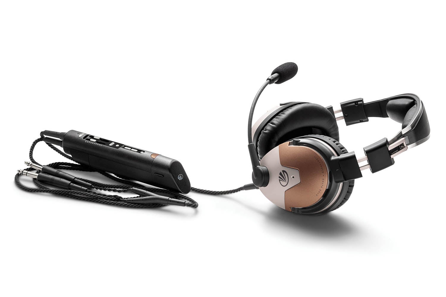

Well, not Lightspeed. Late in 2022, the company introduced the Delta Zulu headset, which in the bigger picture offers a refinement and several improvements on its familiar over-the-ear ANR headsets. But it also brings some truly new features to the category—features that caused Lightspeed to give the Delta Zulu the moniker of “safety wearable.”

A key feature of that safety suite is the DZ’s built-in carbon monoxide detector. If you’ve flown with a CO detector you probably don’t want to fly very often without one—especially if you’ve used one to detect a cabin leak or exhaust-system malady. (And, no, those passive panel dots don’t really constitute state-of-the-art protection.) Lightspeed’s Delta Zulu includes a small CO detector in the ear cup designed to issue an audible warning of abnormal levels. You can turn on the DZ and it’ll do everything you need right out of the box or you can use the free smartphone app (Apple iOS only) to set alarm thresholds and track, in real time, CO levels in the cabin. Within the app, you can set the caution threshold from 10 to 50 ppm (parts per million) and the critical threshold from 51 to 100 ppm. You can have it provide a voice alert with or without a warning tone.

As in the Delta 3 headset, which is still available, Lightspeed gives you the option of ship’s power via a LEMO plug or battery power through two AA cells in an inline control module. The Delta Zulu includes a slide-in battery case that can use AAs as well as a separate cassette with a lithium-ion battery. My brief evaluation period with the Delta Zulu prevented me from fully running a battery pack, of either type, to exhaustion but the Zulu 3s I’ve been using for three years have very good battery life from quality AAs. Recharge of the battery is via a new kind of USB connection called UAC. With adapter cables you can charge the device or connect through USB-C, 3.5mm plugs or a Lightning connector for external audio—though the Bluetooth works so well that’s probably what you’ll use most of the time.
Speaking of audio, the Delta Zulu includes an equalizer function it calls HearingEQity. Recognizing that older pilots are likely to have high-frequency deficiencies, Lightspeed created a feature that allows you to listen to canned tones and tell the headset (again, through the app) the minimum levels you can discern. From there, it creates an equalizer curve. The goal is to tailor the headset’s response curve to your own hearing for better intelligibility—and the results are impressive.

Lightspeed has taken the Zulu line up a notch with the Delta Zulu—up in performance, features and price. The DZ retails for $1099, $200 more than the popular Zulu 3. However, Lightspeed undercuts Bose’s A20 headset by about $100. The only piece of bad news here is that the DZ’s new control pod is larger (both wider and longer) than the Zulu 3’s, so if you have a mounting solution for your existing Zulu 3, you’ll have to come up with something else. But that’s hardly a reason to resist an upgrade to the Delta Zulu—the CO detector and the HearingEQity features alone are worth the $200 investment, making the improved ANR performance and added app features icing on the proverbial cake.
