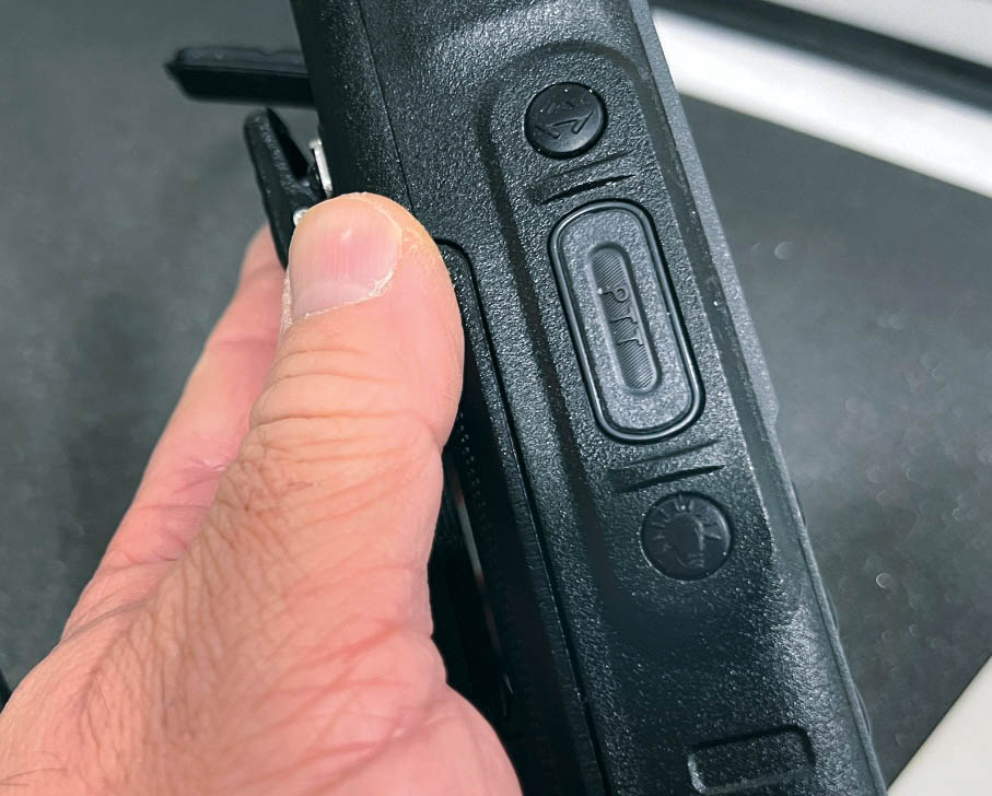

If we had a nit to pick (and it’s a minor one), we wish the radio’s push-to-talk switch was easier to feel—especially while wearing gloves. On the other hand, the switch being mostly flush with the side of the chassis is a good backstop for inadvertently keying the transmitter—something that’s easy to do with a portable radio. The radio does a have a key lock.

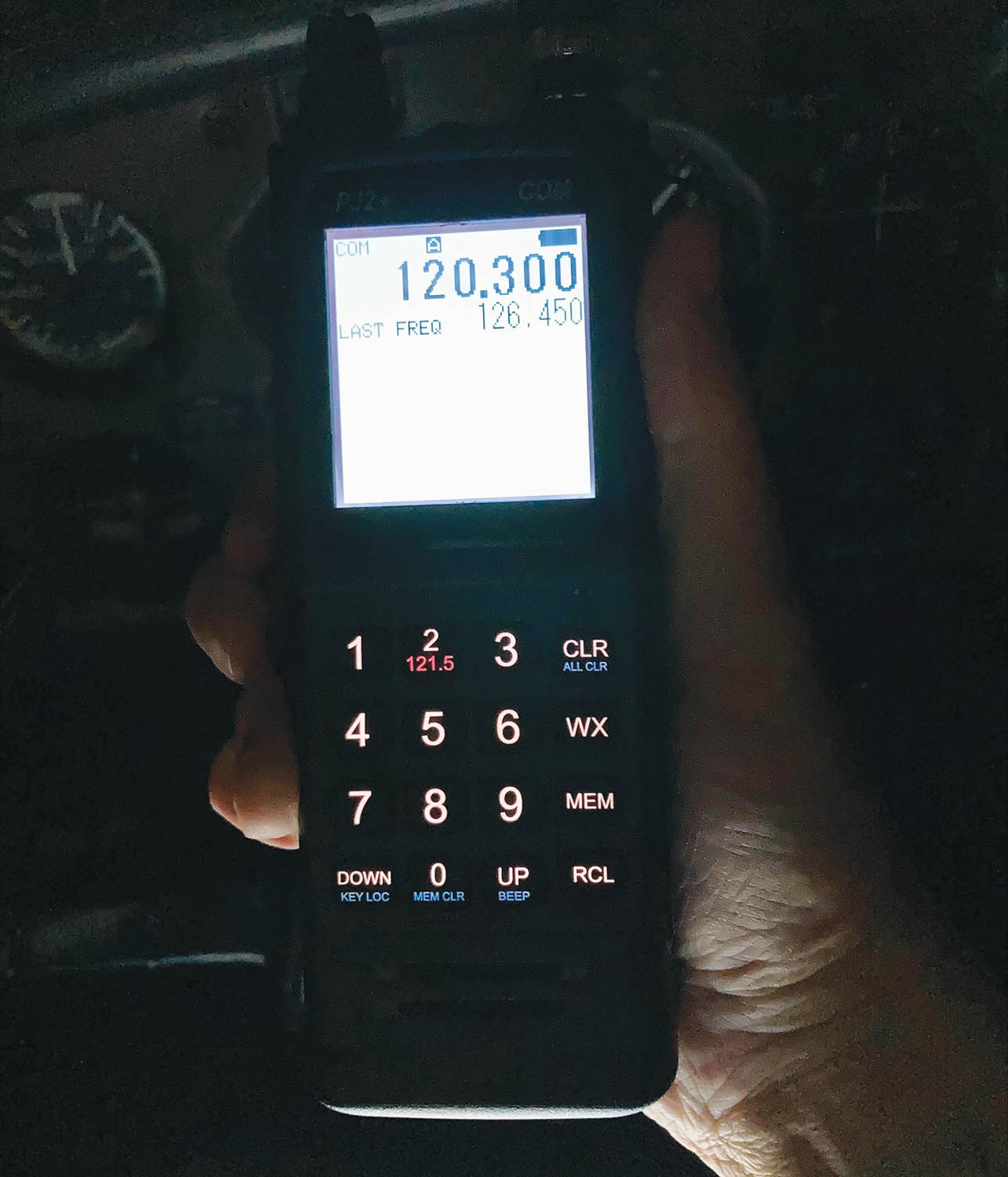

We like the LCD display on the PJ2+, and it’s a better performer than the original. It has higher contrast, making it easier to see in sunlight, and it also does a good job of cutting glare. The viewing angle is wider too, so if you plan to mount it someplace in the cockpit you have more options. Its display has a night mode, high and low backlight adjustment and you can tweak the LCD’s contrast. To save battery life, you can deactivate the screen and keypad backlighting.

The PJ2+ feature/control set is unchanged over the earlier model, although the latest one has a 3.5mm four-pole earbud/headset jack. Plugging in to this jack disables the radio’s speaker and microphone, but you can still key the transmitter and have mic audio from a compatible earbud/headset. You’ll also get sidetone (the sound of your voice as you transmit/modulate), just as you do when plugging in aviation headsets.
The radio has 20 visual memory channel storage and a scan feature for all that are stored, a 121.5 emergency frequency button, an NOAA weather band and a frequency flip-flop key to switch between your last tuned and current frequency. The radio does not have 8.33 kHz frequency channeling and there are no plans to include it for European ops.
As with the first-gen PJ2, a shallow menu structure without unnecessary features makes the PJ2+ easy to use. We think most users will be able to pick it up and use the basic functions without thumbing through the user’s manual. For a radio that might be used in an emergency situation, that’s imperative.
