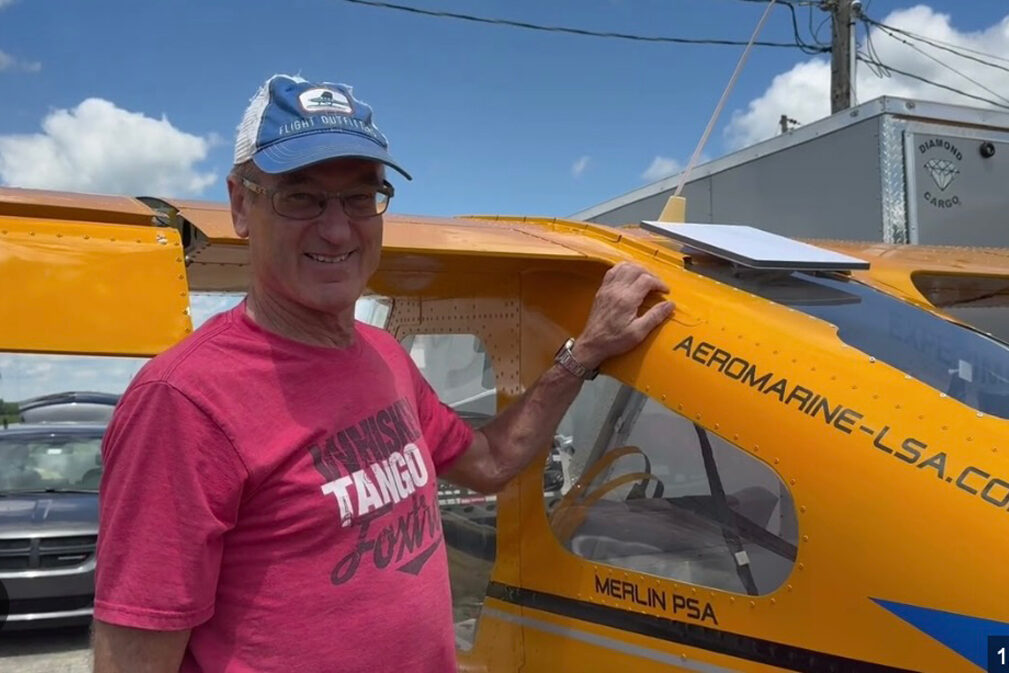

Mounting options depend on the terminal and the aircraft. The Mini works as a portable device—many builders simply place it on a rear seat or in the baggage compartment during flight, using the included kickstand to angle it toward available windows. More sophisticated installations use window-mounted suction cups or custom brackets to secure the unit while maintaining signal quality. It is important to note that Starlink needs to see the sky, so merely sticking it to a window won’t work if the sky is obscured by the airframe.
The larger terminals require permanent mounting, typically on the aircraft’s upper fuselage. This involves structural analysis, antenna placement modeling, and often custom fabrication to create a mount that maintains the terminal’s environmental seals while providing necessary RF transparency. The installation isn’t trivial, but it’s well within the scope of work most builders tackle during avionics installation. As builder, you will need to document to the FAA Inspector or DAR that the Starlink installation and signal does not interfere with any other installed avionics.

Mounting Starlink in an experimental aircraft involves balancing performance, convenience, and safety. The simplest approach uses the Mini as a portable device, secured during flight but removable for ground use. This eliminates permanent installation work while providing full connectivity capability.’
More integrated permanent installations require careful antenna placement. The terminal needs clear sky visibility throughout the aircraft’s operating envelope, which typically means upper fuselage mounting away from control surfaces and antennas. The installation also needs to maintain the aircraft’s weight and balance envelope—13-15 lbs in the wrong location can significantly affect handling characteristics.
