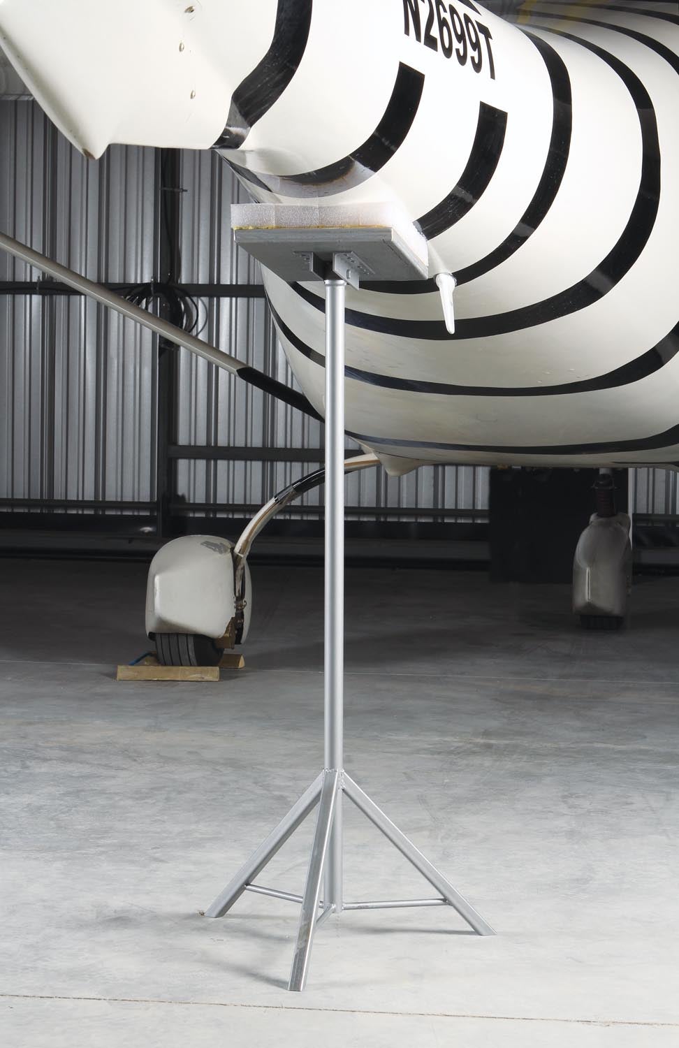

the tail boom innards, be it for annual ELT inspections or to check control riggings. The little fin to the right of the stand is the transponder antenna.
I decided I needed a tail stand after my transponder inspection last spring. A normal transponder inspection is pretty basic: Turn on the avionics and, after everything boots up, a technician walks around the airplane with a fancy (and expensive) gizmo that measures both the content and output signal strength of your transponder. If all goes well, you get a logbook entry, pay and go home. Other than it being the first time at a new shop (Accurate Aero in Minden, Nevada), I expected the procedure to be routine.

Back at the hangar, I set about figuring out how and where to install the new antenna. Before climbing into the boom, I set up the usual stack of lumber and foam under the tail. While certainly stable enough, I realized it was a Mickey Mouse setup.
What I needed was a dedicated tail stand. Something both sturdy and worthy of a professional-looking shop. In other words, a perfect project for the Home Shop Machinist!
The design I came up with is similar to the axle stands featured in the March 2019 issue of Kitplanes®. The main difference is that this is a tripod design. With four-legged stands, the wider the stance, the more they are affected by uneven floors.
A typical commercial tail stand has a shackle or yoke with a cross pin to attach it to a corresponding tie-down point on the tail. The Jabiru doesn’t have that feature, so I designed my stand with a pivoting 8×12-inch plywood table. Together with a generous foam pad to protect the paint, the table spreads the load over a wide area.
While the single post may look spindly, it easily handled my full weight (180 pounds) with nary a wobble. In use it will never see that much load. I figure during a typical ELT inspection, the most it will need to support is about 80 pounds and only slightly more if I have to reach the antenna connection.
The antenna install went well. I included the ground plane recommended by the shop, and when I went back for a retest, it passed with flying colors.
Download the detailed drawing of the LSA tail stand. That’s it for now. Time to get back in the shop and make some chips!
