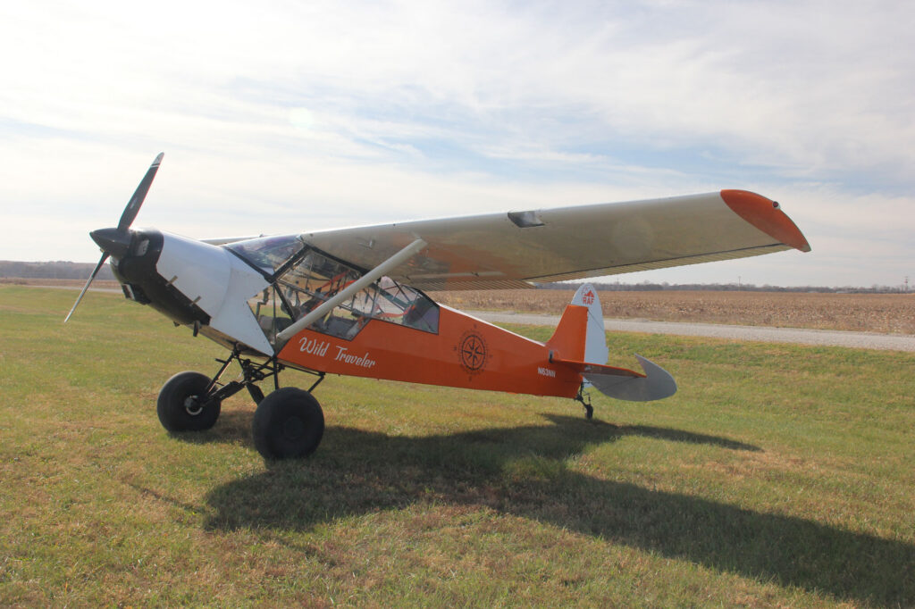

To start with, Wild saved a lot of construction time by repurposing a pair of 1967 Cessna 150 wings, obtained from a sad non-motion hangar accident that only involved the rear portion of the Cessna. He got the unscathed wings for $3,000, which gave him a ready-made fuel system, lift struts, and electric flaps. The welded-steel and fabric fuselage is his own handiwork; he eyeballed Super Cub framework, purchased a flux-core continuous-feed welding system, and went to work cutting and fitting chrome-moly steel tubing.
The inevitable obstacles were overcome with try-again stick-to-it-ivness. Because he was using a relatively lightweight Continental O-200 engine, he found the resulting Center of Gravity was going to be too far aft. “I had to redo the engine mount twice until I got it right,” Wild said. “Before that, I had to figure out how to attach the lower wing struts without cutting them down. I finally brought them inside the fuselage structure to attach them, which worked out fine.”
For the fabric portion, Wild used the Stewart covering system to wrap the fuselage and tail feathers, which he highly recommends: “I covered it in summer, which helped the glue dry.” The white and Omaha Orange paint was an automotive acrylic finish delivered from Amazon; the emblems are vinyl appliqué.

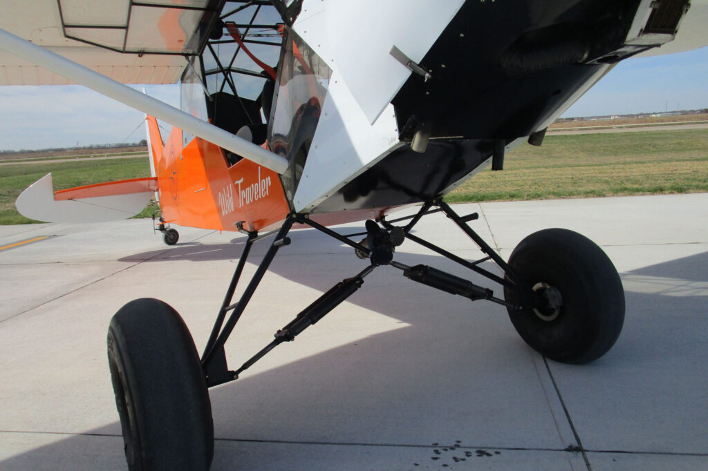

The “Wild Traveler,” as he appropriately dubbed his creation, has a finished empty weight of 933 pounds, while the gross weight is set at 1550 pounds. With a 2.5-gallon header tank added to the 22.5 usable-gallon Cessna tanks, he has five hours of endurance, cruising at 100 mph. The stall speed is a mere 35 mph, thanks to the baby Cessna’s famous “para-lift” semi-Fowler flaps. Big 26-inch Alaska bush wheels, with Shockmaster suspension and a Matco tailwheel, easily enable off-road landings on sandbars and sod strips.

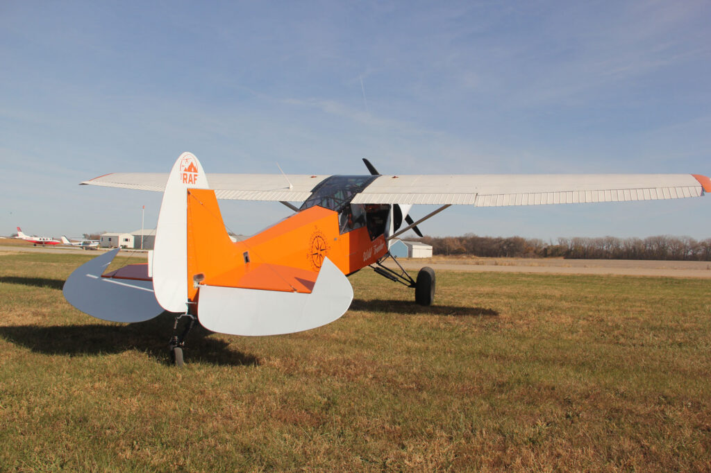

“The seats are boat chairs, very comfortable. I did not install any rear-seat controls for the passenger,” he said. There is a netted wood-floored baggage compartment behind the rear seat, accessed by a fold-down door on the right side of the fuselage; capacity is 50 pounds. Back at the tail, the usual Cub-style adjustable horizontal stabilizer and balanced elevator are employed. The vertical stabilizer carries a row of vortex generators to keep airflow attached at low speeds.
