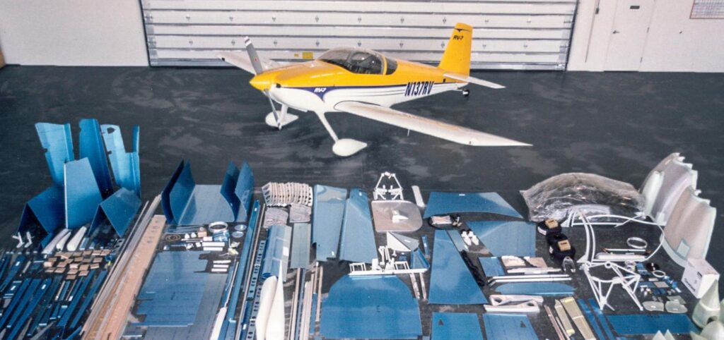

The turning point, the innovation that truly democratized kit building, was the rise of CNC (Computer Numerically Controlled) machining and, specifically, the development of what we now call matched-hole technology. The concept was pioneered by designers like John Thorp with his T-18, which featured a form of pre-punched, easily assembled parts that he called a “hole-coordination template technique”. This was revolutionary for its time, allowing large assemblies to be clecoed together with the precision of an Erector set, without the need for complex jigs.
By the late 1990s and into the 2000s, companies like Van’s Aircraft had heavily invested in this process, powered by industrial-grade CNC punch presses. The process is simple in concept but transformative in practice: the computer-aided design (CAD) for every part of the airframe includes the exact location of every single rivet hole. The CNC machine then punches these holes into the flat aluminum sheets with a degree of accuracy that is nearly impossible to replicate by hand. When the builder receives the parts, the holes in a fuselage skin line up perfectly with the holes in the underlying bulkheads and stiffeners. The structure effectively becomes self-jigging. If the holes line up, the assembly is straight.
This single development dramatically reduced the most time-consuming and error-prone part of metal aircraft construction. The tedious process of laying out, drilling, deburring, and often re-drilling holes was largely eliminated. It shifted the primary task of the builder from fabrication to assembly. One can see the difference starkly by comparing an early kit’s contents—piles of unmarked aluminum sheets and extrusions—with a modern one, where pre-formed, pre-punched parts are ready to be joined together right out of the box.
Alongside this came the rise of quick build kits. Manufacturers began offering major subassemblies, like the fuselage or wings, largely completed at the factory. This allowed builders to bypass hundreds of hours of work while still complying with the FAA’s “51% rule,” which stipulates that the amateur builder must perform the majority of the fabrication and assembly. This, combined with builder-assist programs where builders travel to the factory for a concentrated period of construction under expert supervision, has further increased the likelihood of a project being finished [7].
