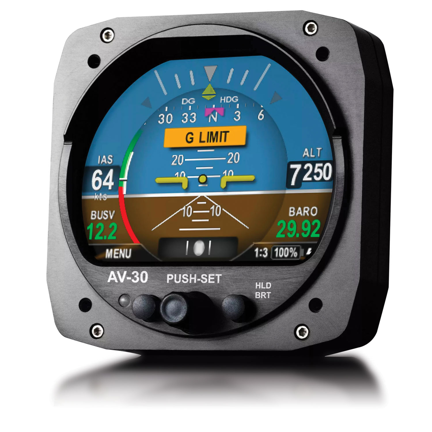

The Experimental-class AV-30 has a full built-in sensor array (attitude and pitot/static) to display aircraft attitude, altitude and airspeed. From there, it calculates and displays vertical speed, true airspeed—as well as G loads, a vertical velocity trend (roughly analogous to a VSI) and AOA. As on the AV-20, the -30 uses a synthesis of airspeed and pitch attitude to calculate an AOA. You set the upper and lower limits based on observed stall AOA and cruise AOA; the AV-30 does the rest.
The AV-30 can also display aircraft heading but does so with what amounts to a digital DG. Set the aircraft heading to your compass and the AV-30 will keep track of heading as you fly, though it’s not a slaved system and there is no internal or external magnetometer available at this time. (Lucky you, you get to keep your whiskey compass!) The AV-30 can, however, be connected to a wide range of GPS position sources through an RS-232 input, and with that will display ground track, lateral deviation and GPS waypoints on an expanded HSI. This feature centers on basic course guidance, since there is no internal database to provide map data.
In fact, the AV-30 has two RS-232 data channels, one dedicated to the tailBeaconX and the other to external nav sources. It also has a direct connection to an OAT probe without an external signal conditioner, which the Garmin G5 requires. (With the OAT probe, the AV-30 calculates and displays true airspeed and density altitude.) The AV-30 does not, however, have a way to connect to nav sources providing vertical guidance, and does not have the ability to decode ARINC 429 data feeds, which is what all modern IFR-approach-approved GPSes require. Garmin’s G5 does, but requires external boxes to add this function. (And, it should be said, the G5 is designed to string additional functions through its CAN bus networking, where the AV-30 is currently built for point-to-point connections.)

Most builders will purchase the AV-30 to be the primary attitude indicator or to replace old vacuum-driven gyros. Here, it’s a winner. The display is bright and crisp, and it faithfully reacts to the aircraft’s movements while nicely balancing responsiveness to accuracy. It shows what the airplane is actually doing in a clear way and, in case you’re curious, the unit I tested had no tendency to drift off indicated bank angle during long-period continuous turns. My sole complaint, and it’s a small one, is that the slip-skid ball is quite sensitive. Either that or the Garmin G5’s is overly damped, but I did find myself initially chasing the ball when flying primarily on the AV-30; in time, I learned to just let it waggle.
A key feature of the AV-30 is the internal DG, which would allow you to replace both the attitude indicator and directional gyro in a vacuum airplane. Overall it worked well, remaining accurate for 20-30 minutes at a time. uAvionix says a software update readied since my unit was built improves that performance. And while this unit didn’t prove as steady as a system with a magnetometer, which constantly corrects itself, it’s worlds ahead of your typical vacuum gyro. Remember how bad those could be? One possibly important distinction here: The AV-30 does not have a dedicated rate-of-turn indicator, which would be an issue for Experimentals whose operating limitations say they can fly IFR as long as they’re equipped in accordance with FAR 91.205; that FAR explicitly requires a rate-of-turn indicator. In this case, you’d need to keep your old turn coordinator alive to be strictly legal, while the other instrument-hole EFISes we’re familiar with do include the rate-of-turn feature.
The DG can be overlaid with an HSI presentation that also includes a basic route “magenta line.” I was able to get a Garmin aera 760 to drive the AV-30—though, for quality of images, the accompanying photos are using the internal demo mode. You can choose whether to show the DG heading presentation or allow the unit to display GPS ground track. Finally, as I found on the AV-20 tested previously, the calculated AOA display was surprisingly good and useful. The display can be nestled next to the airspeed tape for a really quick, at-a-glance check on both speed and AOA without beating up your surely rusty instrument scan.
