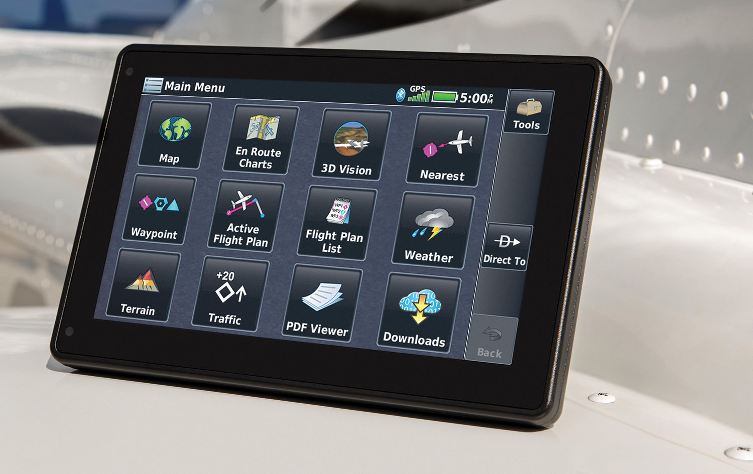

It’s inevitable we’ll compare the 760 to a similarly sized iPad running Garmin’s own Pilot app, so I’ll start by saying the aera’s basic menu structure and presentation is well suited for a busy, bumpy cockpit. The main menu is a set of 12 blocks, each bigger than your thumbprint, that make it easy to move into the core functions. And, here, unlike in the Pilot app, Garmin segregates functions into separate screens, rather than relying as much on overlays. So you have the Map page, which does have a set of overlays, separated from the En Route Charts page, which is a digital representation of a VFR sectional or IFR en route chart. A 3D Vision screen provides an EFIS-like display, which gets its resolution from the GPS or, if connected to an outside attitude source (like a GDL), then it’ll show real attitude. (It does not convey actual airspeed or altitude, showing GPS-derived data instead.)
The other functions found on the main menu include Nearest Airport, Waypoint data, Terrain, access to your Active Flight Plan and to your Flight Plan List. Then there are the Weather and Traffic pages, which require connection to an ADS-B/TIS-B source, such as a GDL 5X or a Garmin transponder with ADS-B In. (Worth noting is that with the Wi-Fi capability, you can get weather on the ground if you have internet on some other device; I had no trouble getting the aera connected to a phone-based hotspot.)
The Tools menu takes you into the secondary features including the Setup pages. And while the touchscreen allows “flick” scrolling, a pair of Up and Down buttons persist on every screen, as does a Back button to help you reclaim the Main Menu without getting lost. Overall, Garmin has managed to keep the menus simple and self-explanatory.

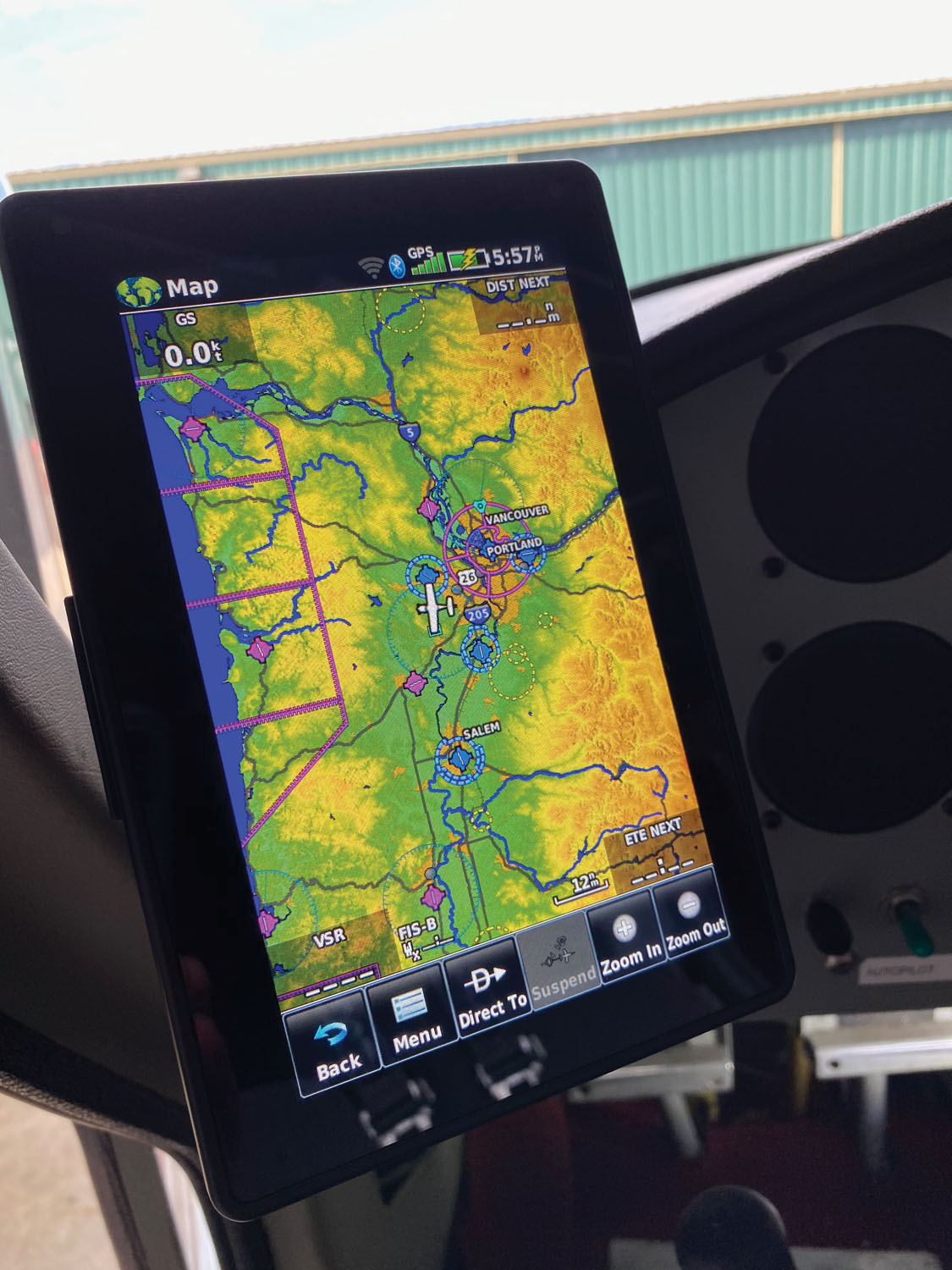

You’ll be spending most of the time on the Map page, and it’s generally a good one. The low resolution tends to make the display seem more cluttered than it does on the Pilot app for the same amount of data, so I found myself frequently turning layers on and off, and changing the map detail on the fly. The Menu button on the bottom gives you quick access to the layers. A wonderfully flexible configuration menu allows you to highly customize several data groups (including the nature of map data, airport and airspace presentation, and so on) to help refine what is shown at various zoom levels. Most of these have an Auto mode, but you can define exactly when you’ll see certain data elements. Garmin’s been doing this a long time and it shows.
What you will notice on the main Map Options page is that you can’t see everything at once. To prevent confusion, you can’t have Terrain and Weather on the same overlay, and selecting weather shuts off Fuel Prices. If you’re accustomed to the Pilot app, you know you can load the main map up with 1001 things, which is not always the best tactic! The aera forces compromises that are, for the most part, mild annoyances, not deal breakers.
