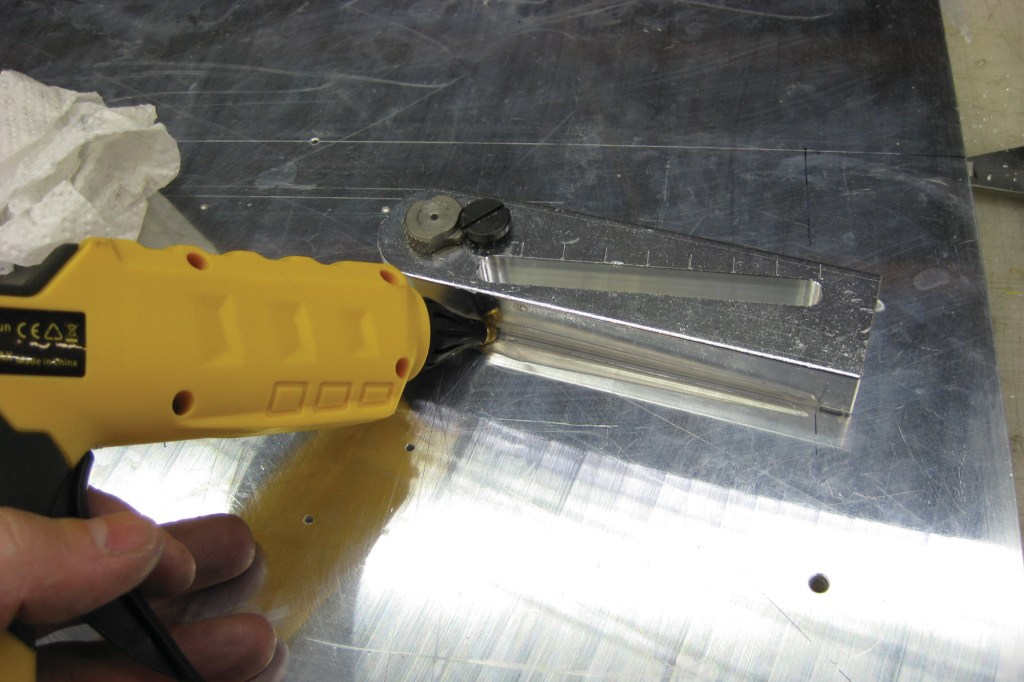

In the last 20 years, pretty much any electric tool is now available cordless. I haven’t touched my corded Dremels in years. The cordless glue gun (as I’ve said in previous articles: What? You don’t have a glue gun???) makes gluing in tight spots/crazy angles easy-peasy. And I love my cordless circular saw. The trick is to choose a single brand that has most of the tools you want so that you can minimize the number of (expensive) battery packs. I like Dewalt and I have a couple of 2Ah battery packs and a heavier 5Ah pack for hungry tools (the circular saw) or jobs that might take some time (the random orbit sander). With three battery packs, I don’t think I’ve ever been at a loss for power – they just rotate turns on the charger.

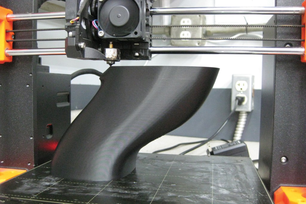

I’ve printed several thousand jigs, test pieces and airplane parts with my Prusa Mk3is, Mk4, and XL (see my article in the April 2025 issue of Kitplanes). You’ll want to pair your printer with some CAD skills – and you can do that with Solidworks through EAA. Solidworks can be moderately challenging to learn if CAD is a new skill, so I highly recommend the tutorial books by Paul Tran. I struggled with Solidworks at first, but finally I made myself sit down and work through Tran’s exercises beginning to end for 8 hours a day. In 3 weeks, it clicked.

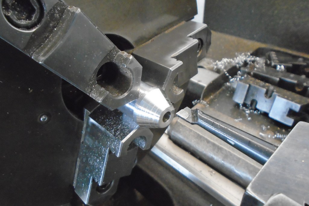

Fabrication and imagination are the chicken and the egg in my mind – you build what you can imagine, but sometimes you limit your imagination if you don’t know how you’d build it. When I started the SR-1, I had built an RV-4 and had the tools for that kind of kit build. But the SR-1 is a custom design – aside from some obvious components like engine, wheels and avionics, the entire airplane is custom fabricated. I’ve often had an idea of what I wanted, but not the tools to make it a reality. Once I obtained the tools, it not only allowed me to fabricate from scratch, it also expanded my ability to imagine new components, because I could build (most) anything now. The 3D printer had an even more profound effect in this way – for example, being able to fabricate negative draft molds (because it’s easy/cheap enough to break up a mold to liberate a part) if that makes for a better part/easier fabrication.
I recently picked up a lathe, and have had access to a Monarch EE for the duration of the SR-1 build, but to be honest I turn a lot less parts than I mill.
Learning how to mill, and turn on a lathe (and to be clear, I consider myself a beginner machinist) was super fun and satisfying. I know homebuilders joke a lot about making up excuses to buy new tools, but I’m a big proponent of trying out new tools. Sometimes you never know how a tool will impact your efficiency or creativity. At worst, you never use it, in which case you sell it and lose a bit of money. But when a tool hits a homerun for you, that far outweighs the duds.

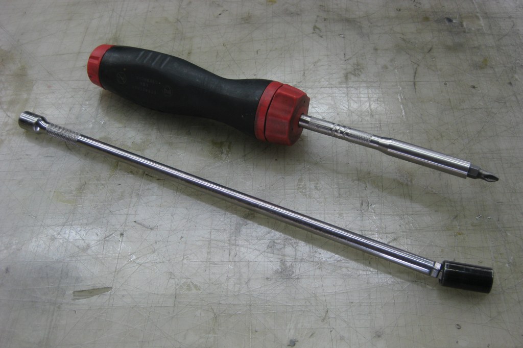

I was able to attend a few Red Bull Air Races back when they were active and I was installing TECAT torquemeters on the planes. These planes came apart and went back together for each race, so that was a lot of screws going in and out. I noticed that quite a few of the teams had the Snap-on ratcheting driver. I’m not going to get into a discussion about the value proposition of expensive brands like Snap-on, but there was a reason so many teams had this particular driver. They have a very smooth mechanism, and are easy to reverse rotation – but not so easy as to reverse accidentally. The knurled shaft and smooth ratchet makes it easy to quickly turn screws out by turning the shaft (rather than the handle) once they are loosened. I use this one driver 95% of the time.
I really love Snap-on’s wobble extensions as well. It’s a socket extension that features a head that allows the socket to wobble slightly. This often makes all the difference in being able to get the socket on the bolt, without having to use a universal drive. It’s an awesome feature – my go-to extension when doing engine work.
