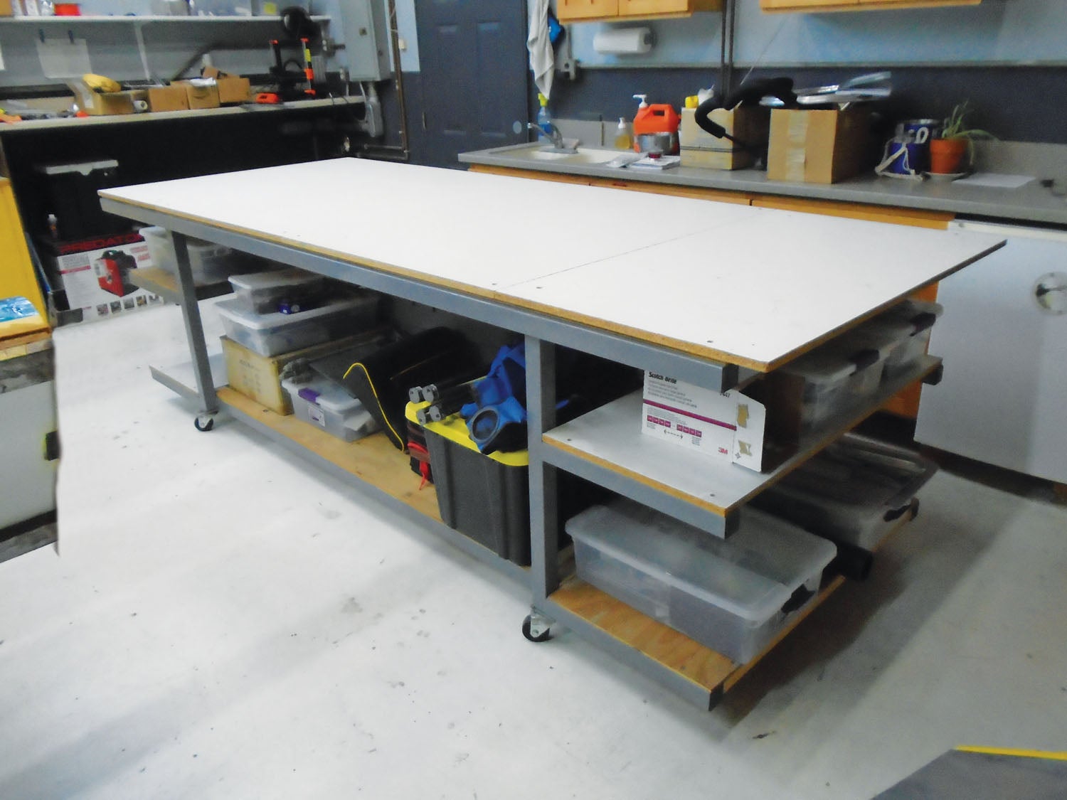

I like big tables. The 2×4-foot EAA tables look downright miniature in my eyes. My tables for composites are 5×10 feet. (Many composites come in 50-inch-wide rolls, so a 60-inch-wide table works well.) I have another assembly table that is 4×10 feet and a couple of smaller 2.5×6-foot tables that I use for staging and materials storage. One of the nice things about the wider tables is that you can work on both sides—I often have different projects going on different sides of the table. Obviously, this size of a table doesn’t make sense if you are planning to shove it up against a wall. Note that the 5-foot-wide tables can be a bit of a reach to grab something on the other side, so unless you are pretty tall, it might be better to stick with 4-foot-wide tables.
Since you’ll be spending many hours standing at your table, get the height right. The EAA tables are 33.75 inches, floor to tabletop, but for tall folks this may be uncomfortably low. I’m 6 feet 2 inches and my tables are 38–39 inches high, which feels perfect for me.
The steel frame itself should also be a few inches inset from the work surface dimensions. For example, a 4×8-foot table might have a frame made of 2-inch square tubing, with outside dimensions of 44×92 inches and inside dimensions of 40×88 inches. The reason to inset the frame is to provide a handy edge to clamp workpieces to. If you run the frame flush with the upper work surface, you’ll be limited to using deep C-clamps or bar clamps rather than spring clamps, which are often more convenient.
For the first steel table I built six years ago, I attached the work surface and shelves with construction glue. It worked fine for a few years but then began to let loose. I now attach the wood top to the steel with self-tapping screws. I countersink these so they will not catch on my work.
One final note: Consider designing your tables to maximize material usage and minimize labor. For example, melamine board comes in 49×96-inch sheets. So my 4×10-foot table is actually 49 inches wide. Likewise, I designed the legs on my 5×10-foot tables to be 48.25 inches wide as measured inside to inside. This allows me to slip a 4×8-foot sheet of plywood between the legs for a shelf without having to do any cutting. The legs are 52.25 inches outside to outside, which gives me about 4 inches of table surface overhang to clamp to.

Shelves under the work surface are a great place to store parts or supplies. This frees up shop floor space and adds weight to the table, giving it a more solid feel. I suggest offsetting the shelf edges a few inches inward from the upper table edge. For example, if the upper work surface is 48×96 inches, the lower shelves can be 40×90 inches. This of course reduces the useful shelf space but makes cleaning easier since chips and other debris can fall straight down to the floor, rather than onto the shelf below.
For shelves I typically use 3/8-inch ply. For the work surface, I use melamine-faced particleboard. The white surface is easy on the eyes and nice to work on. After a few years of abuse, I flip it over and voilà, a nice white surface again. (This is another reason to use screws and not glue.)

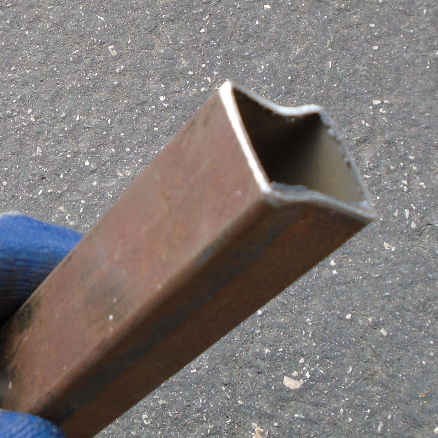

Most metal suppliers sell steel in 20-foot sticks, though they’ll be happy to cut it to length for you (for a fee). Some suppliers also deliver. When buying steel, try to get sticks that have been kept under cover and are still covered with a fresh coat of oil—starting a project with rusty steel is no fun.
You’ll use the chop saw to cut the steel to the exact length for your table, so I suggest getting 20-foot sticks. This will minimize leftover cutoffs. Sixteen-gauge (1/16-inch wall thickness) is plenty strong. Unless you plan on parking a tank on the table, avoid 1/8-inch.
Building the Upper and Lower Frames

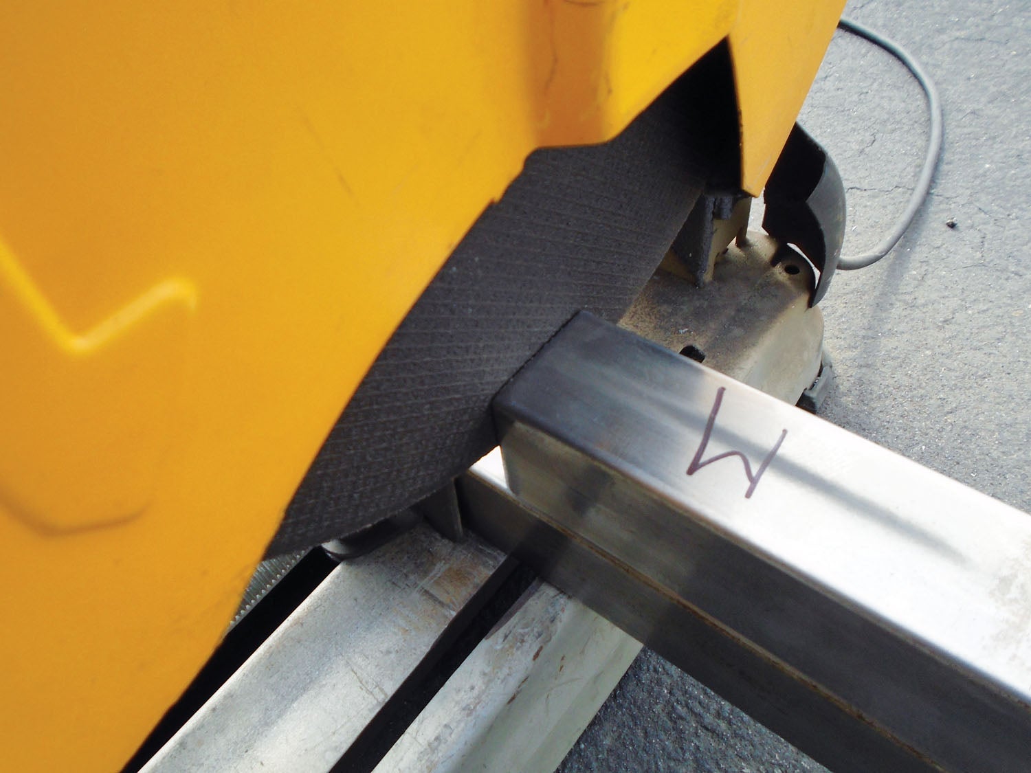

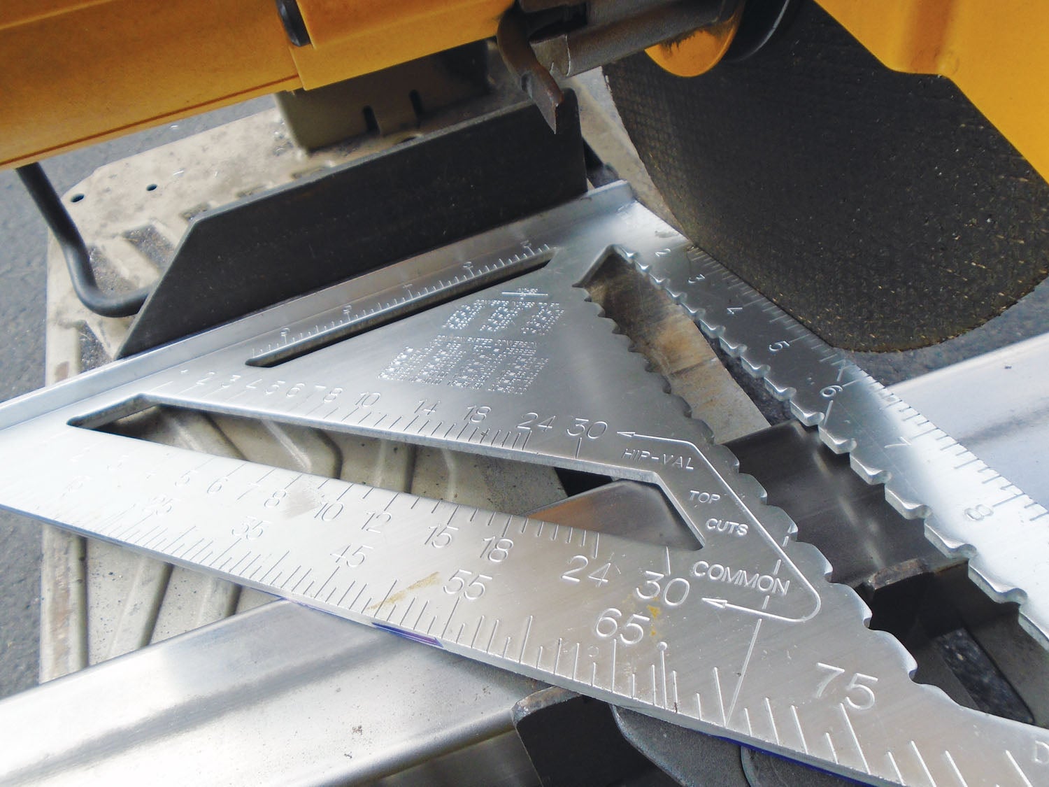

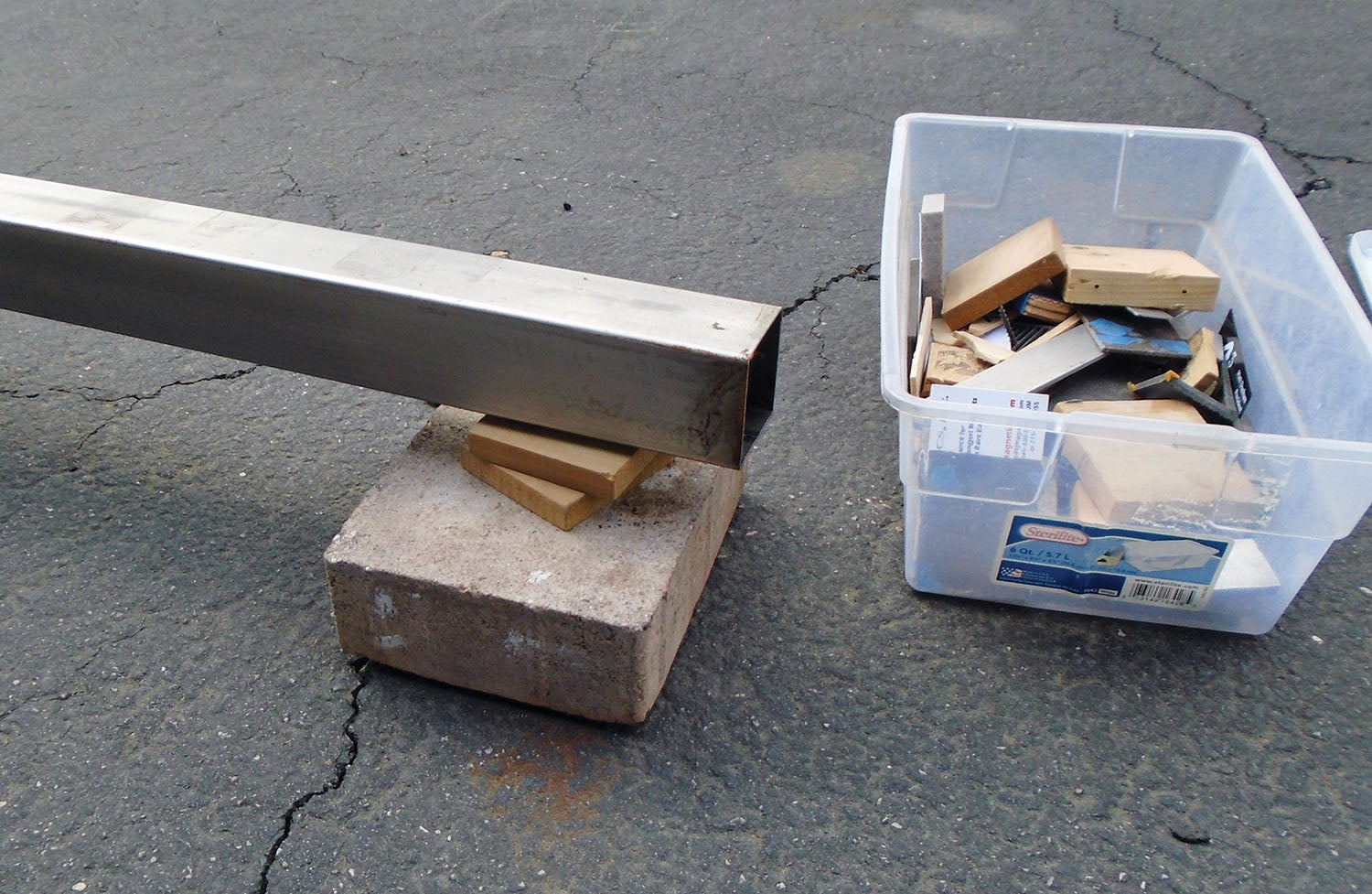

Before cutting the sticks to the required length, chop off any crushed ends. Next, mark your cut lines with a carpenter’s square. Since you’ll be cutting multiples of each piece, mark your first one with an “M” to indicate it’s the master, then use this piece to size the rest. Place the master on the next piece to be cut, flush the ends, then slide the piece to be cut toward the chop saw blade until the blade is flush with the master. I find this faster and more accurate than measuring and marking each piece individually. Also use the carpenter’s square to confirm the saw’s fence is square to the blade. Nice square cuts make the subsequent welding much easier.

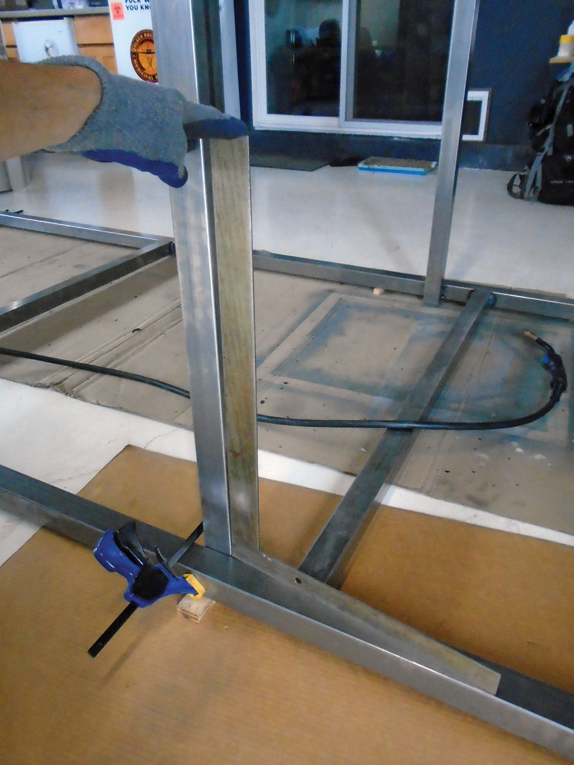

Once you’ve welded the upper and lower frame, it’s time to add legs to the upper frame. Use a bar clamp or C-clamp and a square to position each leg in place, then tack weld. Because the upper frame has been final welded at this point, it should be square and level. You’ll want to use it as a reference for the legs and shelves, but from here on out I suggest tack welding. Good tack welds will hold the table together but allow for adjustment with a mallet if necessary.
With all four legs tack welded in place, clamp the lower frame to the legs and tack weld it into place. Before final welding the legs to the upper and lower frames, check to be sure that everything is square.
There are a variety of ways to check/crosscheck for square in addition to a square itself. I like to level the frame that is resting on the floor, then check the upper frame for level. Of course, if your legs form a parallelogram, both frames could be parallel but the legs not necessarily vertical. However, this can be checked with a plumb bob. Finally, if you have middle shelves, assuming that the top and bottom shelf are vertical, you can use a straightedge and ruler to determine if the middle shelf is also square and level.

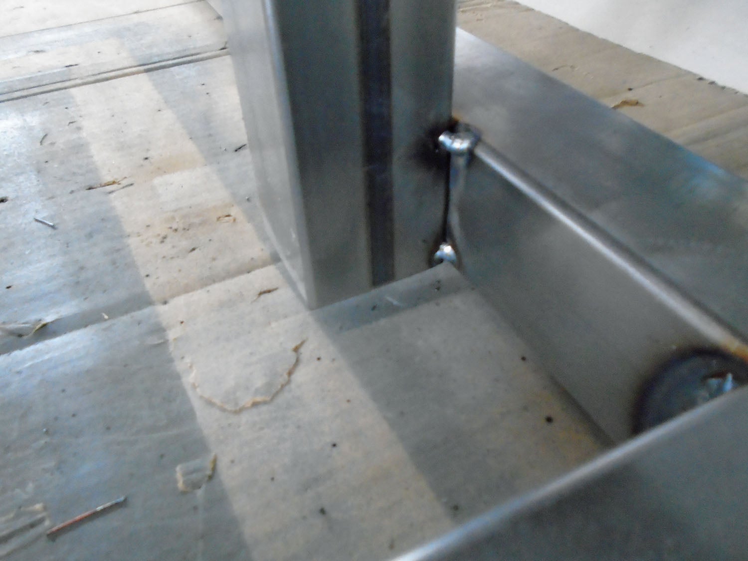

You’ll notice that while the rest of the middle frame is 1 inch square, the center cross member is 2 inches. The reason is that if you’re building a 4×10-foot table, you’ll need to use a 4×8 sheet of plywood with an additional section at the end. The 2-inch tubing gives you enough tube to provide 1 inch of support to each sheet and have plenty of edge margin for screws.
Since the sheet will be resting flat on top of the middle tube, don’t weld the top seam as was done in the photo—the shelf won’t sit flush! Just weld the vertical sides of the tube.
