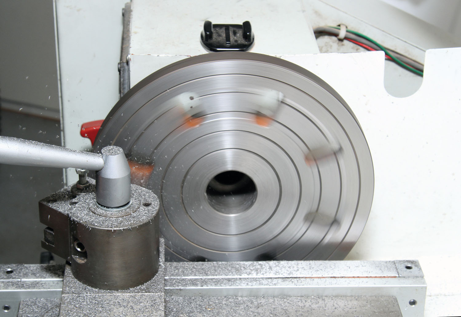

Fast forward to this summer. Despite having torn apart, cleaned, and repacked the wheels, I noticed corrosion pitting on the brake rotors of the Funkist. The combination of being submerged and then not having regularly used the brakes probably allowed moisture to linger and attack the rotors.
Since the brake rotors on the Funkist were barely worn, I decided to try resurfacing them using my small home-shop lathe. The brakes on my Funkist are more than 20 years old, and from an era when parts were made so they could be repaired or restored. With modern components that is sometimes not the case. New rotors may not be compatible with lathe turning, or they may simply be so thin and lightweight to begin with that when worn out, they must be replaced. Always check with the manufacturer for wear limit (minimum rotor thickness) and approved procedures. If the information is ambiguous, contact the company and ask. The experimental aircraft community is super-friendly, and if you have a question, manufacturers want you to reach out to them.
