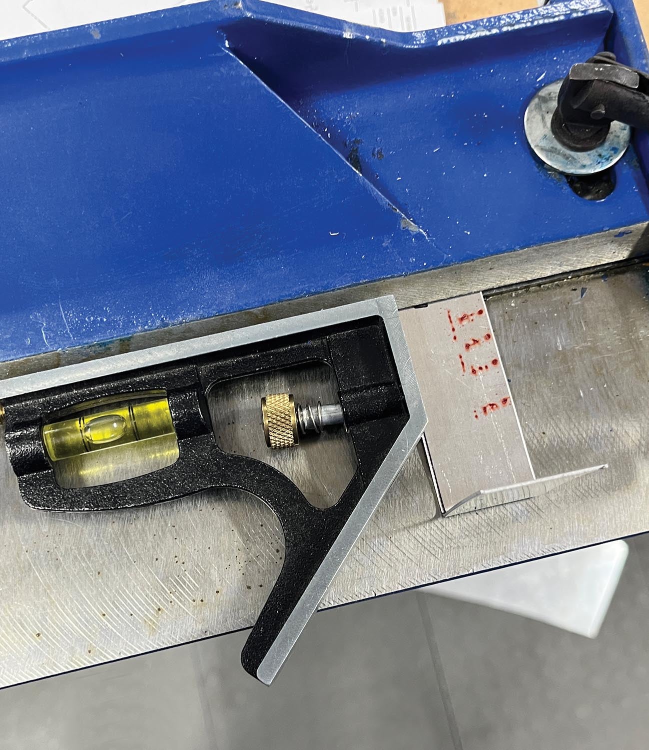

I had to make about a dozen brackets for the cowlings and the metal brake came in handy again. I used a base unit from an adjustable square and held it in place on the brake to form a nice 90° bend to the long axis of the bracket. This method ensured the brackets would be straight when mounted to the tail cone.

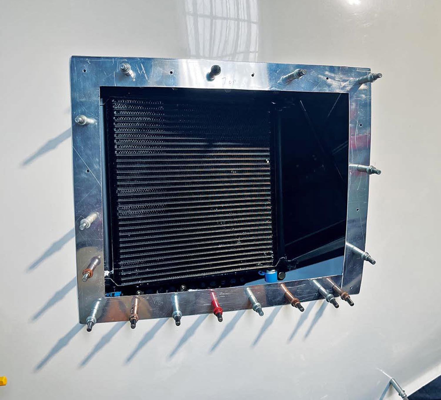

For working with fiberglass, I really like a high-speed, battery-powered Dremel, along with an assortment of various accessories. I find that it’s easy to control and makes small work out of opening up the cooling exits on the cowlings using a cutting wheel and sanding drum. It also made an easy job of cutting the flanges off the premolded tail rotor shaft covers and cutting holes in the cowling for the oil cooler exit air. You can certainly use aviation snips to make some of the cuts, but I wouldn’t recommend them for final cuts in fiberglass as they leave tiny cracks in the gelcoat along the cut.

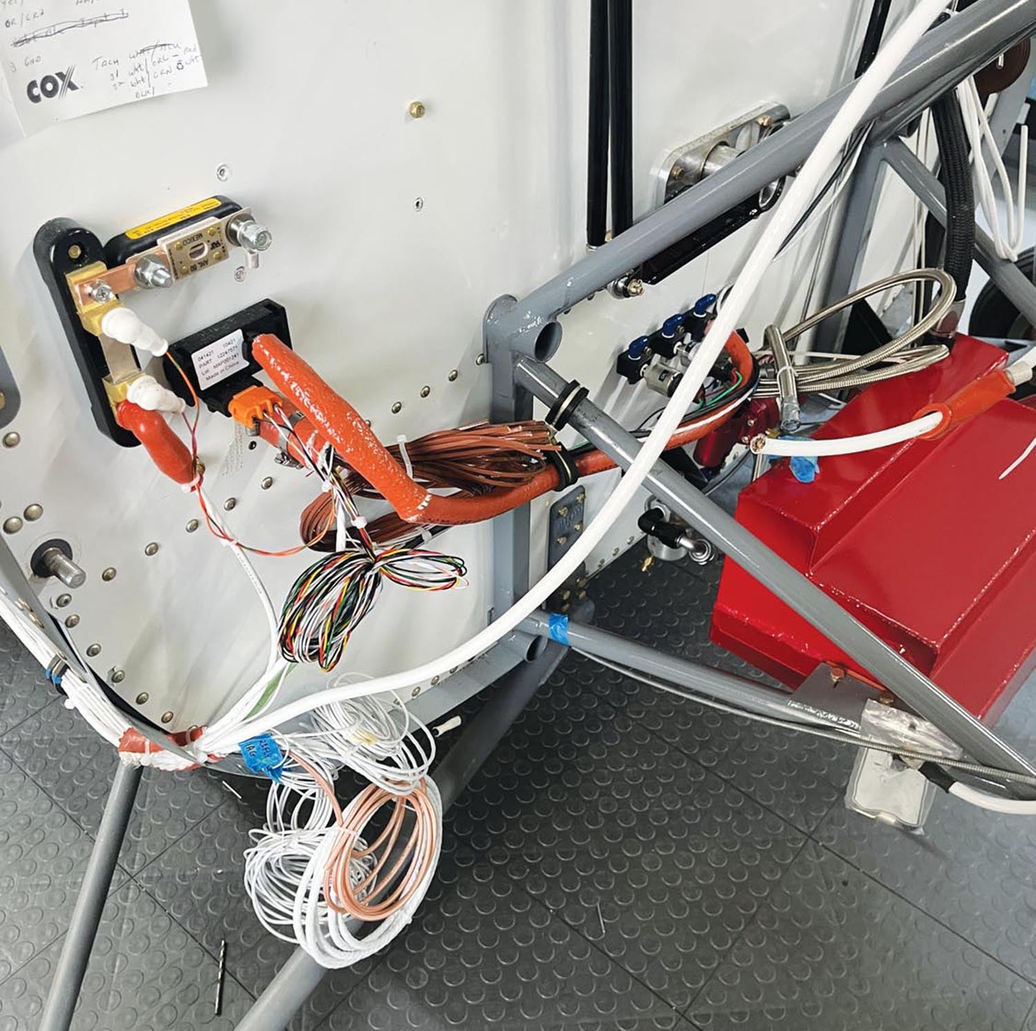

I used Panel Planner software, which some of you might be familiar with. I’ve used it on my last couple of aircraft. I find it relatively easy to use and Gene Velazquez, the founder, is extremely responsive. As an example, when I updated the software to do this panel, I discovered that the dimensions of the instrument panel were wrong. I sent a note to Gene and he updated it within one day! Another feature I like is the ability to print off the panel “full size.” This allows me to tape the print to the panel in the aircraft and then sit in the cockpit making sure everything will fit and is functional. After three or four variations, I sent the final to Rob Hickman at Advanced Flight Systems, and I hope to see the results soon.
I will be using a single AFS 6600 EFIS as the main display, with a dual engine/rotor rpm gauge, manifold pressure and airspeed indicator as backup. Rob and his team are another example of stellar customer support to aircraft builders. Helicopters need a second oil pressure indication for the transmission in addition to engine oil pressure. Using another input on the EMS module, they are coding this into the 6600 software for me. Speaking of the EMS module—that is the box to which all of the engine sensors are wired, and then it is connected via the SkyView network to the EFIS for display. Since the helicopter engine is quite a distance from the cockpit, I decided to mount the EMS module on the cabin side of the firewall behind the left rear seat. That way none of the engine sensors required any additional length of wiring, thereby saving some weight and eliminating the chances for intermittent connections associated with spliced wiring. I now only needed one 9-wire SkyView network cable from the instrument panel to the cabin firewall instead of approximately 30 wires, not including the 24 CHT and EGT wires that would have needed extensions.
The center piece of the Advanced Flight Systems setup is the Advanced Control Module (ACM), which is a very comprehensive power and distribution center for the aircraft. It eliminates the need for any circuit breakers, thereby saving some weight and complexity. The ACM also displays on the EFIS, so you can see the health of the electrical system. The premade harnesses connect the aircraft and avionics to the ACM, saving time and preventing wiring mistakes. You still must run wires to various components on the aircraft, such as lights, fuel pumps, etc.
Luckily, the space behind the instrument panel on the Hummingbird is cavernous, so I was able to mount all of the remote components such as the radios, transponder and backup battery behind the panel. The ADAHRS, which provides attitude inputs to the EFIS, is mounted on the floor of the center panel console underneath the switches. The ADAHRS also provides magnetic direction information to the EFIS.
With all of the electrical wiring and metal controls in the cockpit, I was concerned that the ADAHRS would not be able to provide accurate magnetic info, so I mounted a remote magnetometer in the tail cone. It requires mounting it within 1° of all three aircraft axes, so with the use of a smart level, I’m pretty sure I accomplished that.
I did make some additions to the electrical system, based upon experience from my other aircraft. For one, I added a hot bus on the main battery compartment so I can have things like cabin lights for night loading of crew and passengers, and USB outlets for phone chargers and iPads, connected without having to turn on the master switch. It also allows for connecting the Lycoming electronic ignition, which is basically a SureFly ignition. I added another “expansion” bus for things like electric seats and some instruments that were part of the kit, like the tach generator emulator and manifold pressure gauge. These bus additions will make adding future components much easier.
