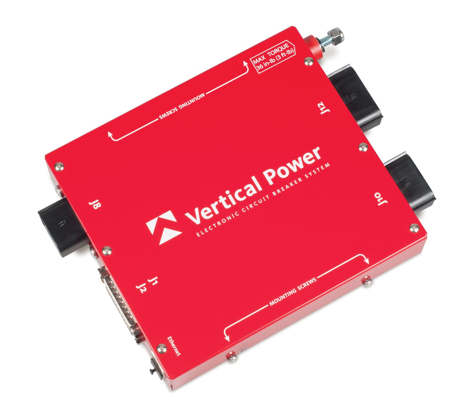

VP-X: Circuit Protection on Steroids
The Vertical Power VP-X Electronic Circuit Breaker System is a separate product that takes power from the PPS and intelligently distributes it to all the electrical devices on the aircraft—including avionics, of course. It also provides on-screen control of the electrical system. Vertical Power said roughly 30 OEMs use the VP-X Sport as standard equipment. You don’t need a PPS to use the VP-X.
There are two models to choose from: the $1695 VP-X Sport and $2395 VP-X Pro, which differ by electrical system compatibility (the VP-X Sport is for 14-volt systems only, and the Pro works in 14- or 28-volt systems), the number of available circuits, processors and power supplies (the Pro has dual processors and dual power supplies for redundancy). The physical installation for both products is identical, as is the setup. Both the Pro and Sport compact modules have dual 25-pin D-sub connectors and can be mounted behind the instrument panel or any place suitable for remote avionics and accessories. There are six connectors on the VP-X Pro and five on the VP-X Sport. Three of these connectors carry high-current loads, and two D-subs are used for low-current systems, including trim motor, as an example. An Ethernet connector is for Windows-based configuration and software updates.
The VP-X Pro has 32 switched power inputs (24 circuits on the Sport model) and what Vertical Power calls Dual Bank technology, or two independent power banks in a single system for redundancy. This isn’t a true dual-bus system (the company dropped that language used on earlier products), but the VP-X Pro has dual banks. This means you can divide avionics and other electrical loads between those two power banks, and in case one bank controller fails, the other bank will continue to operate independently.
You still have the same single-point failure problem you would with a traditional power bus, of course. If the main power supply to the VP-X (contactor, battery, etc.) fails, you’ll still lose the main bus. Don’t throw those battery-powered backups away, and even consider an additional fuse block for some systems. Still, we like the VP-X’s ability to precisely monitor the connected systems thanks to a built-in microprocessor checking each circuit 100 times per second. If there’s an issue with the circuit, there’s a timing component for detecting short circuits, plus its ability to precisely measure voltage and current on every sweep. The EFIS throws a fault message to get your attention to go to the main electrical page where you’ll get more information on the use—short circuit, overcurrent, overvoltage, etc. You’ll know what has tripped, why it has tripped and should have plenty of clues to help troubleshoot the issue. The VP-X also makes it easy to load shed without killing the entire avionics bus.
Don’t overthink the interface overall, and when installing the avionics and a VP-X, think in terms of wiring to a traditional power bus with mechanical circuit breakers or fuses. Simply wire the power input from the avionics component into the VP-X. Each bank of circuits is powered by an independent power supply and a microprocessor, and you wire the avionics master in as a main switched input. You can get creative and highly configure the circuits. Vertical power offers generic wiring harness kits (starting at $625) that come with all of the wires (with Molex and D-sub connectors) on one end that connect to the VP-X device. There are four major connector inputs on the VP-X Sport and five on the VP-X Pro. It’s said that a VP-X can save as much as 60% installation time over a traditional bus arrangement, although there will be an initial learning curve.
There are no relays or solenoids in the PPS or VP-X. Moreover, the two banks (A and B) do not share common components on the circuit board—each bank is isolated from the other outside of the main power bus input and ground. We like that either bank can power the aircraft’s starter circuit, so you should always be able to get an engine started if one channel fails. Of course, you could still have a failure of the master switch or battery contactor, but these are relatively rare.

Very much enjoyed this article. Well summarized and packed with information. “If” I was going to kick off another build project, I’ll be going back to this review. thanks.
After spending many long months wiring my RV8, I am seriously looking into using the VerticalPower box for my next airplane project, if there is a next airplane. I don’t regret doing everything by hand because it was a great learning experience.
From a photo caption in the article: “We give the PPS an edge in perceived reliability.” How do you “perceive” an edge (and how do you quantify it?) in reliability for a product whose inner workings are unknown to you? Unless you’ve examined and tested the code running inside the PPS (or the ACM), or read the datasheets for its components to discern MTBF predictions, how can you make *any* assessment of its reliability? The assembly of discrete components that you compare it against are all well characterized over decades of service in GA aircraft. They require no software (or software updates) to operate, and if something does go wrong with one of them, replacement parts are available from suppliers everywhere. Furthermore, their failure modes are few, well understood and easily tested in the field. If a system like the PPS or ACM has a failure, how will it manifest and which systems will it affect? How long will it take and what will it cost to remove the box, ship it to the manufacturer for repair, ship it back and reinstall it? How long will the manufacturer support it (Garmin, anyone…)?
These products are intended to appeal to builders who are uncomfortable with the skills or time required to wire an aircraft, and to system integrators who work for airframers and avionics shops. That’s fine, and I understand the appeal, but let’s not pretend that we’re gaining reliability just because it’s easier to install or because the manufacturer of the gadget says so. Maybe they are reliable — I certainly hope so — but I have yet to see an article about them that asks the manufacturer any hard questions about how they proved it.
I asked tough questions. Vertical Power said it designed the products to certificated standards, but since it’s an experimental product and nobody wants to pay for the full TSO process, it fell short of the full-up certification proving process, although it did conduct heat/burn testing. It spent five years developing the PPS with 27 months of beta testing with close to a dozen units in all conditions around the world.
In-house testing consisted of high loads, high voltage, climate, and destructive testing with solvents, oils, water.
Builders I surveyed are pleased with the reliability, simplicity and support of the latest-gen Vertical Power products.
$1,700 vs about $200 for 2 contactors, a current shunt, [ not shown in the pic ], and a 60-80 amp breaker in the panel.
As an electrical engineer/ pilot/ a/c owner, I’ll take the latter. Contactors will last 50 years, are simple to connect with 2 wires…
So, it’s a few more holes to drill and a couple of extra connections.
My experience is that electronics will not likely live for 50 yrs, especially when exposed to the 180 degF heat under the cowl….!!
