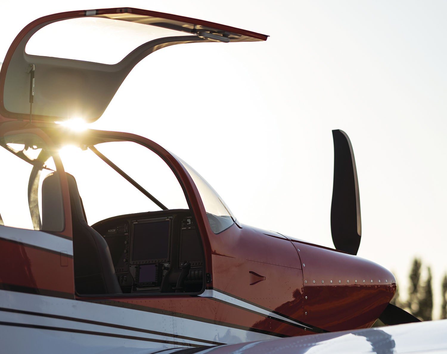

Lots of things can happen to an airplane in flight, and they are often caused by human error before or just after departure. Canopies and doors open up—usually a result of inattention to the latching process. In almost all cases, an unlatched door or canopy is a non-event, so long as the pilot doesn’t make it worse. In a few cases, an unlatched gull-wing door can open up and come off. In these cases, it can damage the tail as it goes, making for a bad day. There are also cases of a pilot struggling with a door or canopy and losing something from the cockpit that hits and/or jams the tail. In all cases, the first thing to do when you get a sudden blast of air is—nothing.
Take a beat, take a breath—and realize that you’re still flying. Now, solve the problem. If there is a re-latching procedure that works in the air, use it. If not, your best option is to land—ignore the door or canopy for now—fix it on the ground and continue on your way. This kind of thing is a distraction, not an emergency—it’s a minor anomaly that you don’t want to make worse.

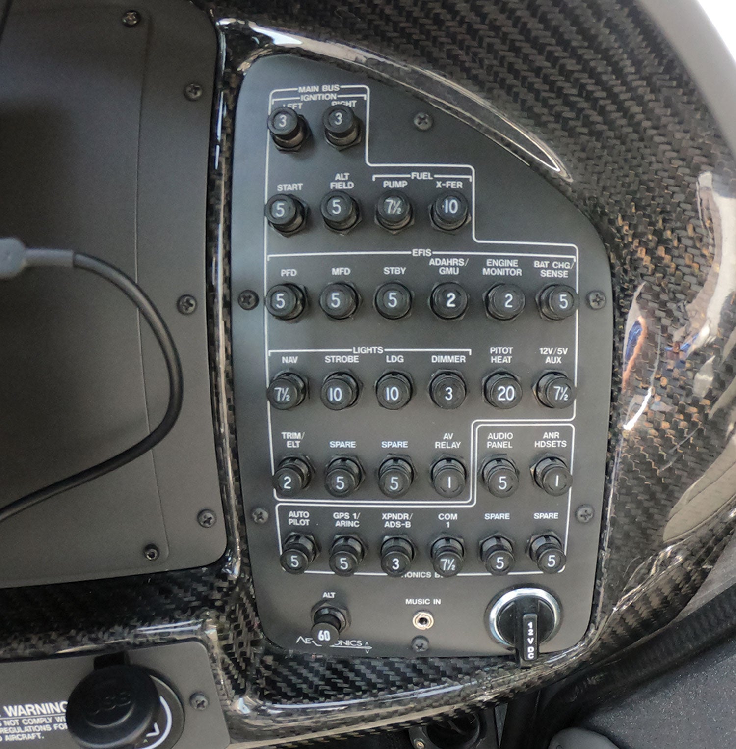

Next, let’s talk about electrical problems. The most common is a charging-system failure—usually caused by an alternator or wiring problem. The signature is likely to be missed if all you have in the cockpit is a voltmeter and an ammeter—unless you have a very studious scan of the system instruments. Fortunately, modern EFISes can be set to give you a message or alarm if the voltage drops below a specified value, and if you get such a message, the first thing to do is check the voltage. Anything below about 12 volts is cause for concern because the alternator should be putting out better than 13 volts to keep the battery charged. However, it’s important to see what is “normal” for your airplane on the ground, with the engine running, because of variations in measurement systems (some ammeter readings lag a bit, for example). Low voltage could mean you’ve overtaxed the alternator/charging system, but it also means you are now operating on the battery.

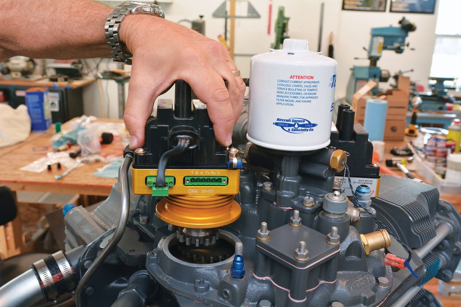

If you have old-fashioned magnetos, you should realize immediately that the engine will keep running, even with the electrical system completely dead. If you are running electronic ignition, it is not so cut and dried. Some generate their own electricity (so long as the engine is already turning above a certain speed) and will keep doing so even without ship’s power. Others require power from the ship’s electrical system to keep the motor running. If the latter is the case in your airplane, you have a limited time to find a place to land. With good designs, you should have enough battery power to last longer than the fuel in your tanks—so don’t panic. Just find a good airport at which to end the flight. However, if you haven’t checked those backup batteries in a while or you’re not sure of how well the system can handle a charging failure, you might pick the closest field—just in case you become a glider. In any case, make a deliberate decision to get the airplane on the ground—make a plan—then stick to it.
An electrical failure can and will affect more than your ignition, but it shouldn’t lead to disaster. You might lose navigation and communication when the battery dies, so the first thing you should do is eliminate any unnecessary electrical loads. In the old days, the landing and nav lights took a lot of juice, and many still do—if you have LED lighting, there is much lower draw—but I’d still power off all the lights. Secondary or tertiary radios? Off. Entertainment systems or air conditioning? Definitely off. (This is where you’ll be happy you paid a little extra for pullable circuit breakers or left certain fuses accessible in flight for items without their own on-off switches.)
Only keep running what you need to complete the flight to your new destination. If you have electric flaps or gear, make sure that you deploy them before you lose all your juice—plan ahead. If you have electric trim—get it set to where you’ll want it for landing.
None of this is cause for panic. It is cause for planning. Experimental aircraft have a wide variety of systems designs and implementation. If you are the builder of the plane, you should understand all of the interconnections as well as the potential failure modes and implications without having to refer to anything. Make sure that you test all possible configurations before leaving the ground to make sure it all works the way you expect it to. If you are not the builder, the same rule should apply—but sometimes there are little nooks and crannies that the designer didn’t pass on. In that case, know exactly what you need to safely end a flight on a runway and learn enough to make sure you can keep those things going. Always know how the airplane works—not just how to work it.
