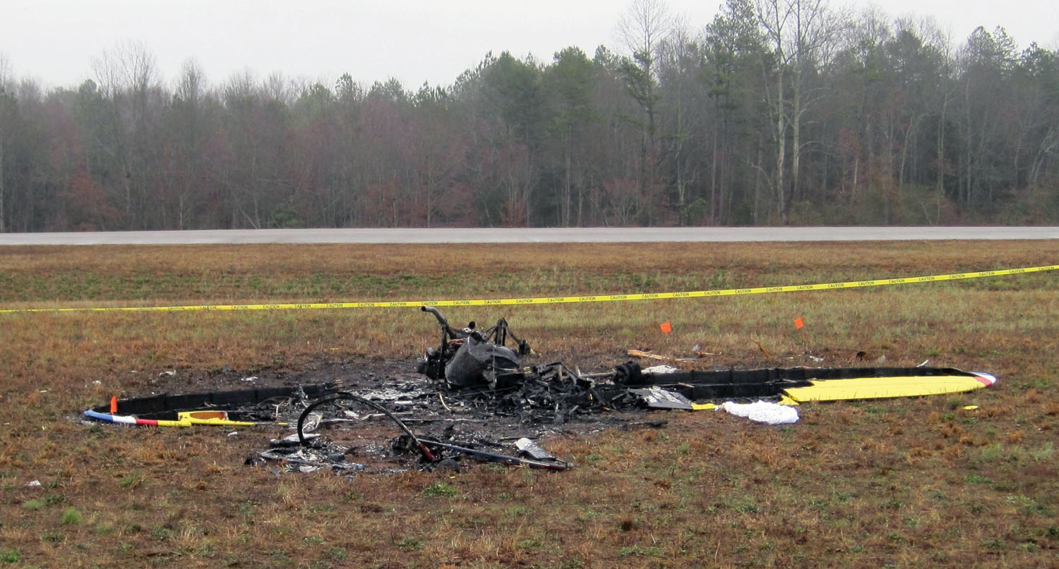

Post-Impact Fires
Back in 2002, a Fly Baby lost its engine on takeoff and cartwheeled. The pilot broke a leg in the crash, and was pinned in the wreckage. The fuel tank, located in the front of the fuselage over the pilot’s legs, ruptured. He was soaked with gasoline and unable to extricate himself from the aircraft.
No fire, fortunately. But this is a nightmare most pilots are only too conscious of.
So, what are the chances?
Let’s start with the probability of fire. From the NTSB records, about 10% of homebuilt accidents report a fire after impact. This is based both on an “aircraft fire” parameter in the NTSB database, as well as a manual examination of accident narratives to identify additional cases. As we saw in Figure 1, it’s a big slice of the pie, but still not all that common.
I took a stab at identifying the primary construction method used for 3428 fixed-wing homebuilt accidents from 1998 through 2017. Figure 2 shows the percentage of post-impact fires versus the construction method. (Note: “Unknown” in the figure refers to my unfamiliarity with the aircraft type, not that the NTSB was unable to determine the mode of construction.)
Again, composite construction stands out. Where the effect of the construction material may not be a great driver in in-flight fires (since the fire is usually primarily concerned with the engine compartment), composite materials do seem more likely to support fires after the airplane crashes.
This is borne out when examining production-aircraft crashes. The all-composite Cirrus has the highest percentage of post-crash fires among a dozen small GA aircraft examined (Figure 3).
But it is important to compare aircraft of similar performance ranges. Burning fuel is usually a primary component of post-impact aircraft fires, and the harder the plane hits, the more likely the tanks will rupture. Hence, the faster the plane is going at impact, the greater chance of a post-impact fire.
Figure 4 shows the percentage of post-crash fires for homebuilt aircraft versus the Wikipedia-listed cruise speed for the aircraft. While few airplanes actually crash at their cruise speed, it is useful as a metric for comparing the relative performance of the aircraft; most Pietenpol accidents occur at slower speeds than Glasair ones.
The figure also shows the type of construction. Again, composite aircraft suffer post-impact fires more often, but higher impact speeds probably have more effect.
(Which composite aircraft has no post-impact fires? The Searey. Seventy percent of its accidents were on water.)
