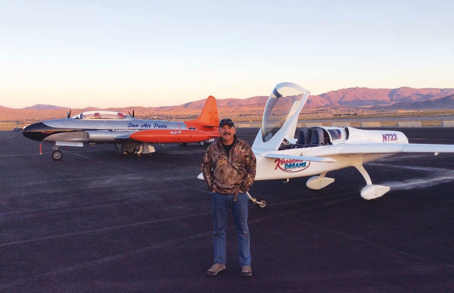

The CozyJet on the ramp at Tonopah, Nevada. It’s a nice place to stop for gas between Las Vegas and Reno.

It was these parameters that I learned to deal with when launching off on the CozyJet’s RAFE promotional tour to the Reno Air Races and back. It was an awesome trip with the intermediate stop at Kanab and flying through countryside I’d only seen before while flying in other jets like the F-14 from my Navy days and the Boeing 737 I fly at work. One of the most rewarding legs was crossing the Nellis ranges north of Las Vegas. There I once played in my Tomcat as part of the Air Force’s Red Flag exercises. Flying in a tactical fighter teaches you about making sure you have enough fuel. Crossing the Nellis ranges in the CozyJet was no different. There are not many places to stop and get gas, and the only place is Tonopah, Nevada. Back in my Navy days, things went on at Tonopah we couldn’t talk about. I’d flown there many times and always wondered about that little airport in the middle of nowhere Nevada. I finally got to stop there, and I highly recommend it if you’re in the area.
The CozyJet did its job at Reno, and thousands of people got to hear about the RAFE. I kidded Hoot Gibson that more people looked at the CozyJet than Strega! After an awesome week at the Reno Air Races, it was time to head east and get back to Texas. There were a few more events the CozyJet was booked at before the season ended, and it went back to JetGuys for some seriously needed upgrades. The first on the list was larger wheels and brakes. I hate to say I told myself so, but I told myself so.

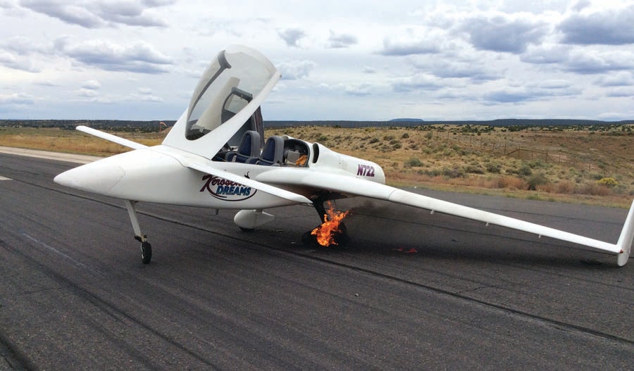

Fire!
Suddenly, a puff of smoke went by the left side of the airplane, low. The little voice inside of me screamed, “Hey! This thing could be on fire! Get out!” I unbelted, opened the canopy, and leapt over the side, practically right onto a fire. Still not knowing what was going on in the engine compartment, the immediately visible problem was flames coming from the left wheelpant.

Post-fire investigation showed the fire actually melted the aluminum brake line where it attached to the caliper. Now the 5606 brake fluid was draining out of the master cylinder and feeding the fire even more. I grabbed my bags and dragged them about 100 feet from the burning plane. When I turned around and looked at the burning CozyJet, my heart sank. I remembered reading about a Defiant lost to a brake fire in Albuquerque years ago. Above the gear leg fire was almost 100 gallons of Jet A, separated from the flames by only foam and fiberglass. It looked like this could be the end for the CozyJet.
Standing on the far end of a 7000-foot runway with no one else in sight, watching your plane burn, is a very lonely, helpless feeling. It occurred to me to call 911. Grants is a tiny old mining town, and not much exciting happens there anymore. With the added difficulty of attempting to communicate on my cell phone in all that wind, the 911 operator thought I was telling her my trailer was on fire. I tried to correct her and asked her to immediately send fire equipment to the airport, but I don’t think she even knew there was an airport in Grants. I gave up. With no other ideas, I took a picture of the burning plane with my cell phone camera just to document its last moments. I just knew any second now that Jet A was going to blow, and I jumped when there was a loud pop and the airplane moved. The tire had exploded from the heat, and the airplane settled on its rim.
Since I’d heard Ray and his friend were going to lunch after I departed, I thought I was the only person on the airport and totally doomed. About that time I saw a car coming down the runway toward me. It was Ray. He’d seen me land and wondered why I was going downwind so hot. When I didn’t taxi in, he went outside his office and realized I was at the end with a problem. He had no idea I was on fire. When he drove up, his jaw was hanging and I said, “Ray! You have a fire extinguisher?” He quickly replied, “No, I’ll go get one!” As relieved to see him as I was, my heart sank.
I walked to the runway edge and kicked at the dirt, seeing if I could gather some up to throw on the fire and smother it. But then realized how futile that would be.
I thought about dragging my stuff farther away because I had no idea how big the fireball might be when the tanks finally melted enough to let all that Jet A spill out. It seemed like there was no way to save the situation, and all I could do was stand there as this awesome one-of-a-kind CozyJet went up in flames.
As I watched, the left wingtip slowly settled onto the asphalt as the melting fiberglass gear leg gave way to the weight of the plane. Then, much to my surprise, I saw a truck racing down the runway with emergency lights blazing. Maybe my 911 call actually worked!
