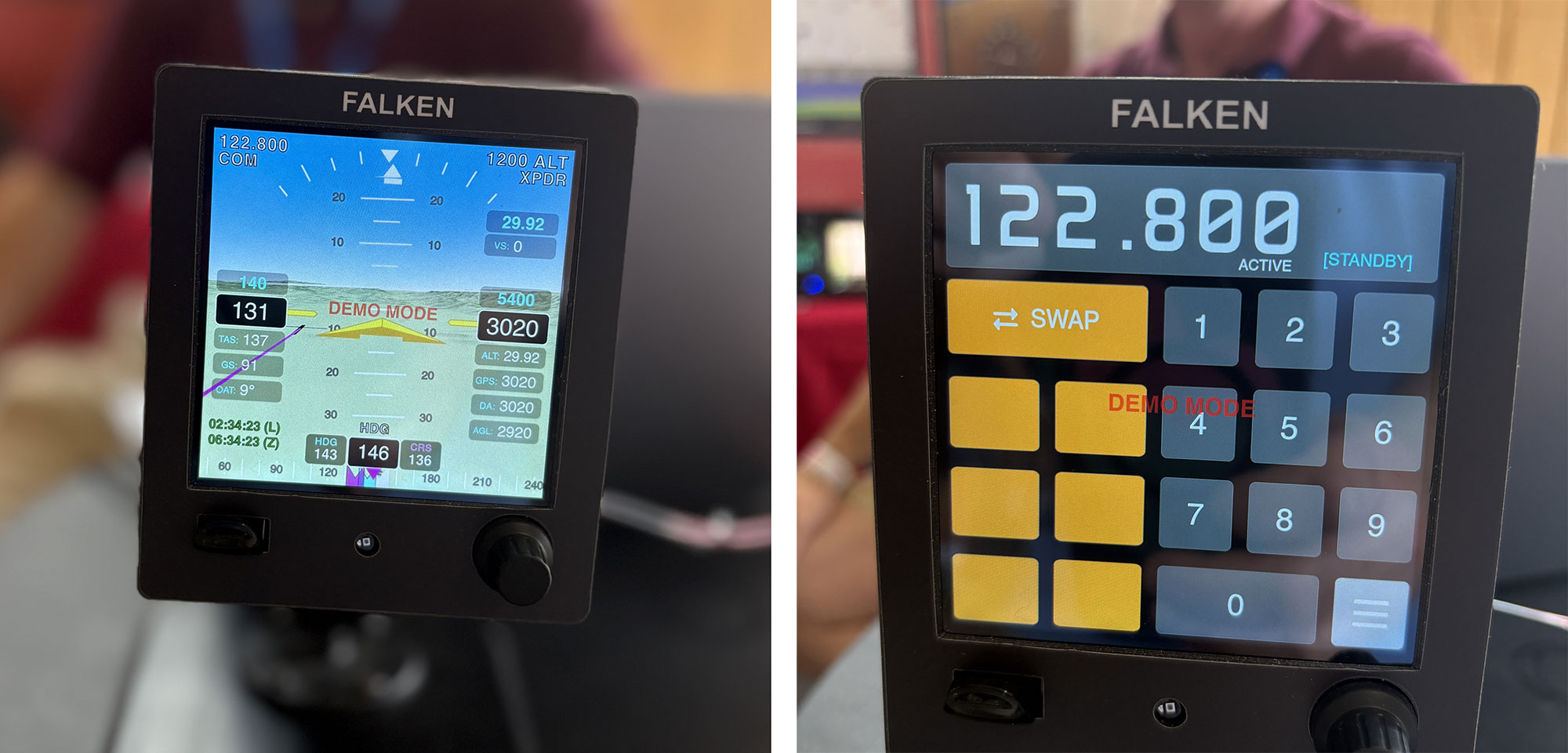

The centerpiece of the new lineup is the Astra Mini EFIS. Priced at $2500, this compact unit is designed to serve as either a primary flight display in a smaller aircraft or as a capable backup in a more complex panel. The Astra features a bright, square 720×720-pixel touchscreen and provides a full primary flight display (PFD) with synthetic vision, a moving map (MFD), and an engine monitoring display (EMS)—the latter requires the separate Falken EMS module. It can also remotely control a variety of com radios, transponders, and autopilots. Notably, the unit does not fit a standard 3.125-inch instrument hole.

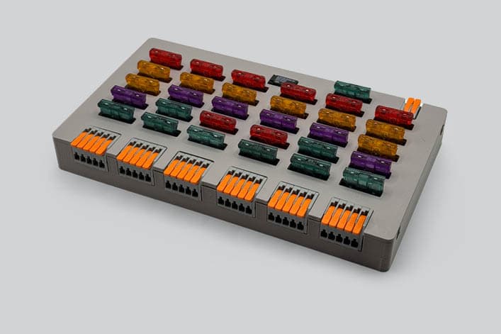

Supporting the new EFIS is a range of new hardware. The FlightBox v3 is the next generation of Falken’s popular portable ADS-B receiver. For $499 ($399 for pre-orders through August 31), it offers dual-band ADS-B, a WAAS GPS, AHRS for attitude data, a cabin altitude sensor, and a carbon monoxide detector—all powered by a five-hour internal battery or ship’s power. For builders looking to simplify their wiring, the new BusBox Power Center ($450) offers a 30-circuit power management system that uses easy-to-wire lever terminals instead of traditional ring or tab connectors. Falken also introduced a new magnetometer ($299) and an ARINC 429 adapter ($499) to integrate certified navigators with its systems.
