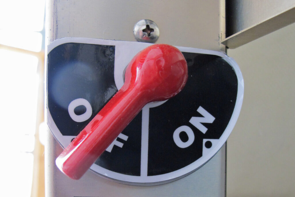

Fuel valve selector
Managing fuel while in flight should be simple and straightforward. But on many of the aircraft I’ve inspected, it’s confusing and complex. There should be only one fuel selector in a single-engine aircraft. It should be in a visible, easy to reach location for the pilot when he or she is fully belted in. The selector markings should be clear.
