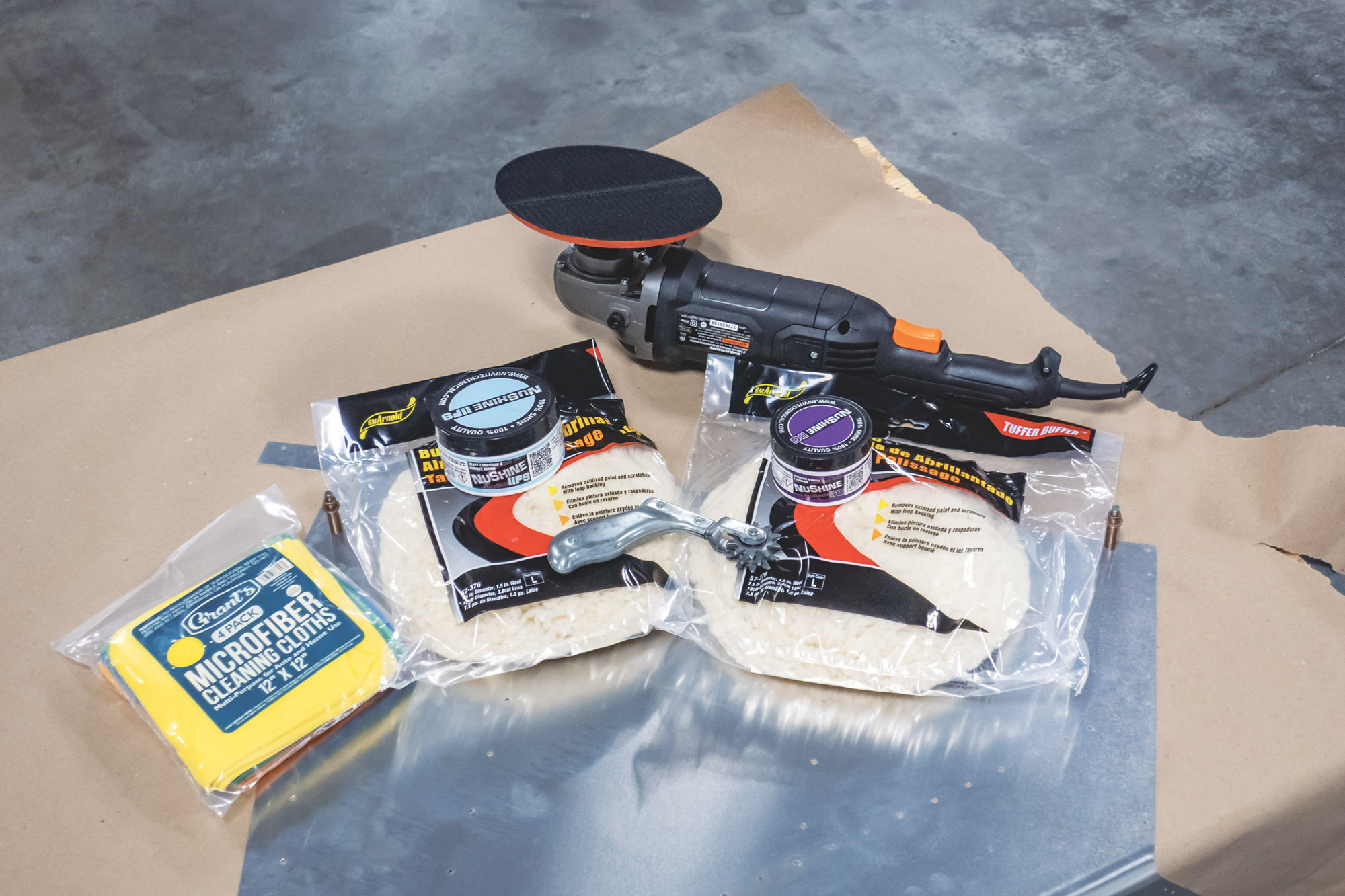

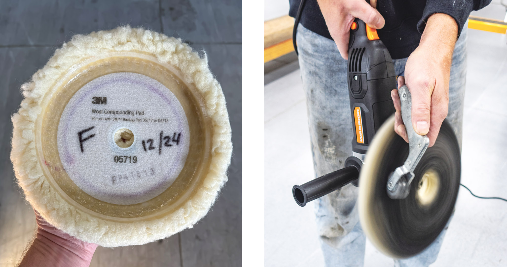

Compounding Pad: Type, Condition, and Care
Initial polishing is done with a rotary buffer and wool compounding pads (at this stage an orbital buffer won’t make the cut). Always begin with a new wool compounding pad. No excuses. It must be new, it must be wool, and it must be a compounding pad, not a polishing pad. I use a 3M pad, part number 05719. If you’re only exploring your will to polish, buy one pad. If you are committed to polishing, buy two.
During use a pad will become matted and less effective. When that happens the pad should be spurred. During extended buffing sessions a pad can become saturated with polish, and spurring is no longer effective. Let the pad dry before spurring it. If you wish to keep polishing, switch to a backup pad.
Pads can be washed, but never wash one to use with another grade of polish. Wash them in a bucket of warm, soapy water—never in a washing machine. Rinse them well. Depending on the size of your project, at some point, like you, a pad may lose its enthusiasm for the job. Think of pads as consumable items and replace them when they seem to be wearing out.

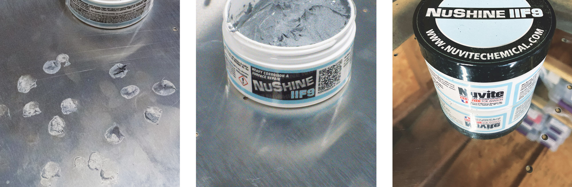

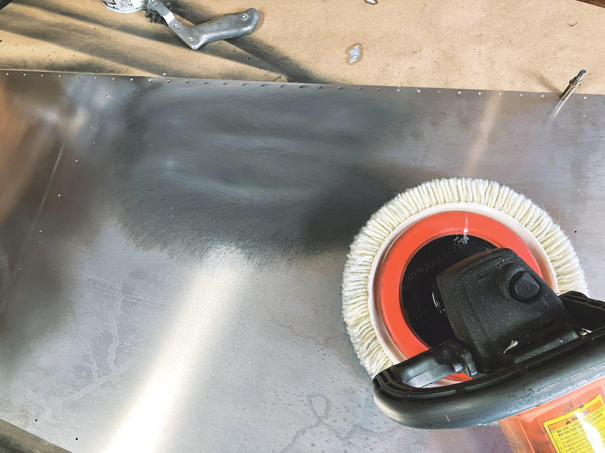

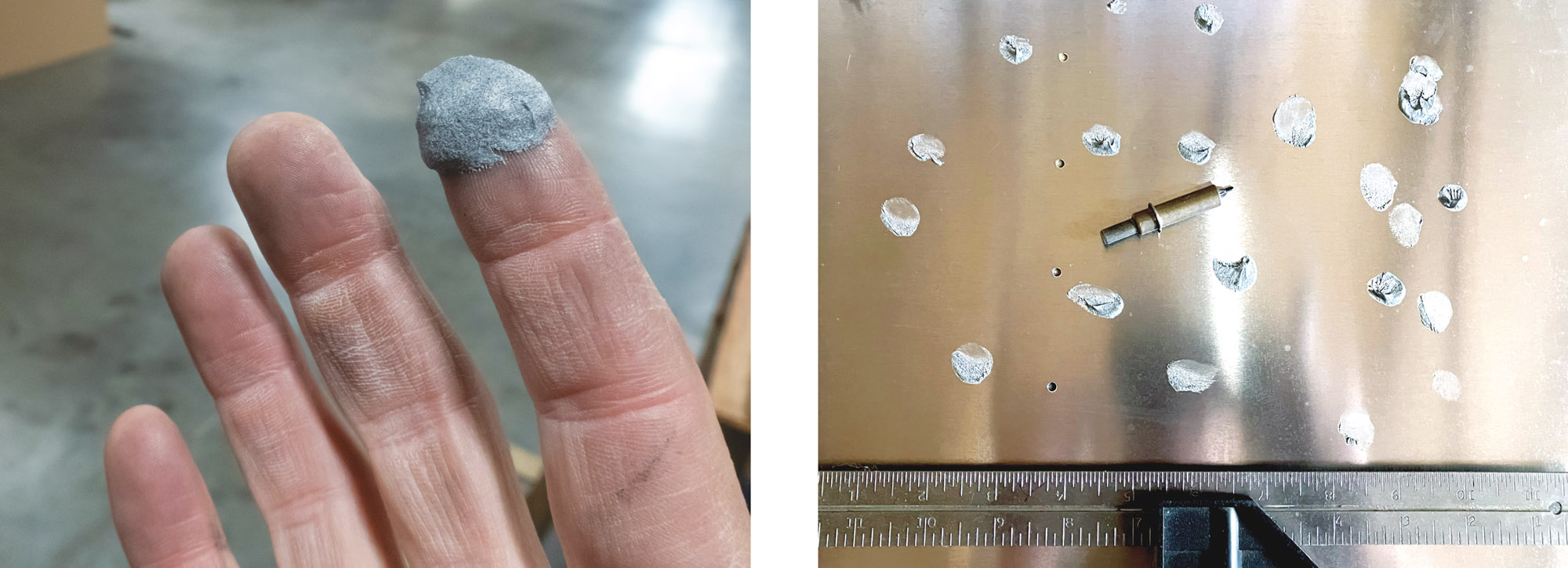

Amount of Polish Applied

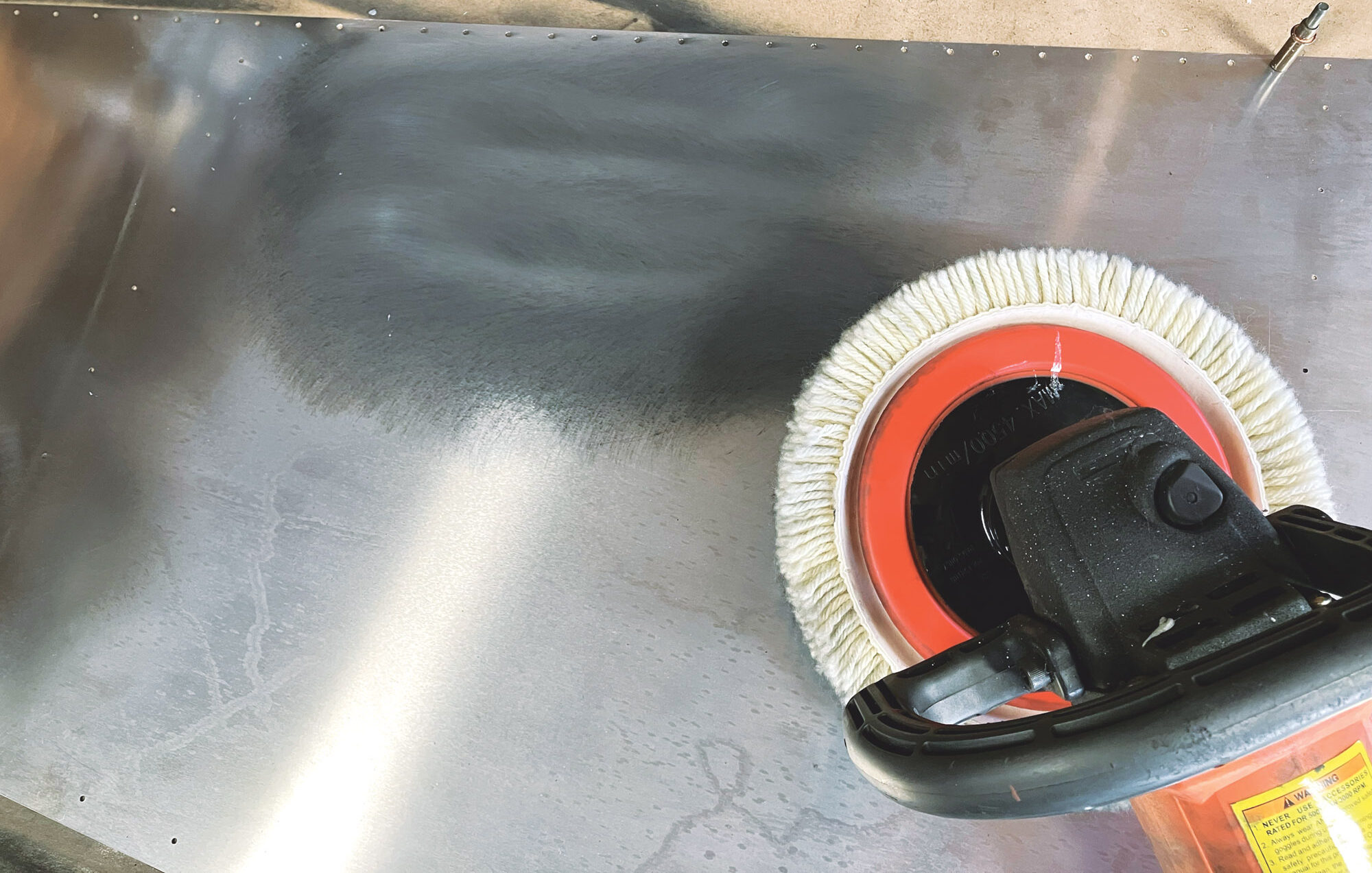

Nuvite NuShine II consists of a fine polishing substrate suspended in a carrier solvent. If too little polish is used for a given area it dries quickly and becomes ineffective. If too much is used it self-lubricates and becomes a thick, black coating that clogs the pad. My experience is that people use too much polish, at least at first. More is not better. There is a caveat (of course). When you begin polishing with a new pad, the pad will absorb some polish, just as a dry paintbrush absorbs paint. Therefore, you will need more polish than “normal” until the pad has stopped taking its angel’s share. Also, as a surface becomes polished, less polish is needed for each new pass in the same way a second coat of paint requires less paint. The key is to observe the results and regulate polish application and distribution accordingly.

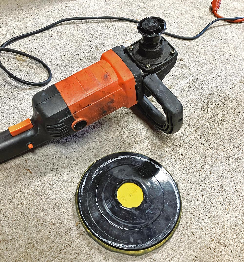

Rotational Speed of the Buffing Pad
I estimate the speed of my rotary buffer to be 750-900 rpm. Nuvite recommends 2000 rpm, but my experience at higher speeds is the polishing compound gets flung from the surface while I spread it or the polish’s carrier burns off, leaving the remaining substrate ineffective. I recommend starting slow and adjusting the speed up (or down) as you gain experience. You’ll also find that surface friction slows the buffer during the first round of polishing. Don’t hesitate to adjust the buffer’s speed to accommodate the conditions.

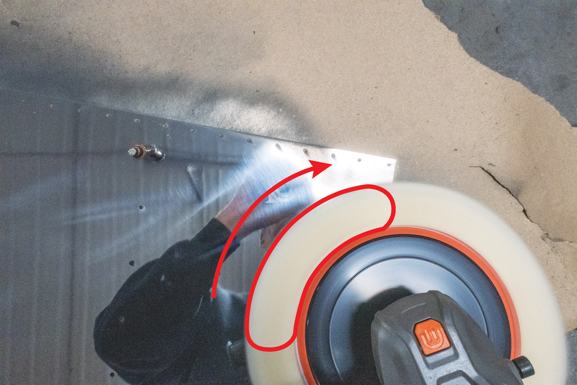

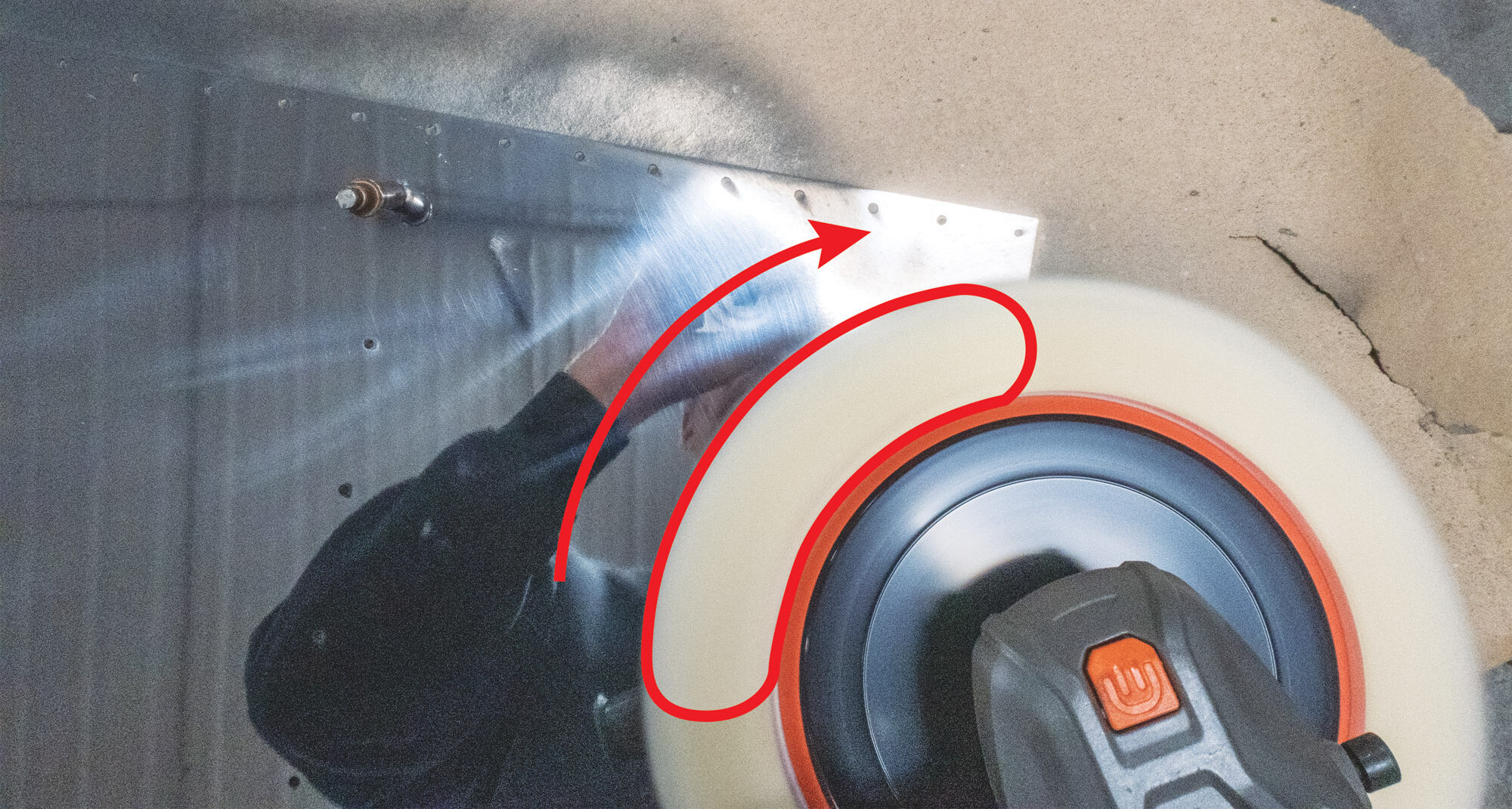

Contact Patch of the Buffing Pad

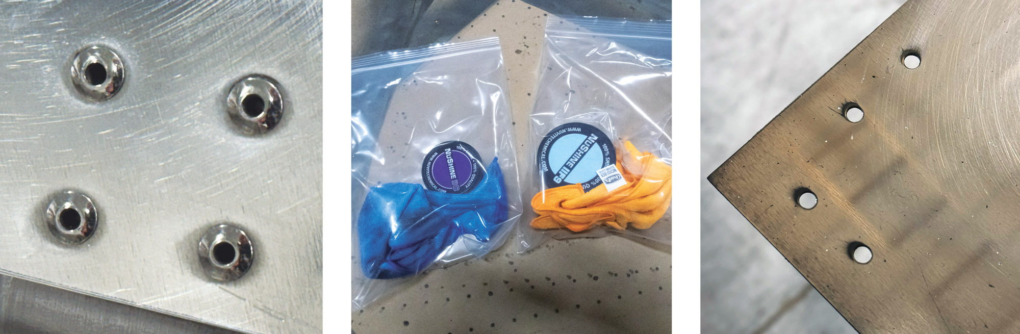

The buffer must be held at a slight angle to the surface so only a portion of the pad contacts the surface. Changing the buffer’s angle on either its pitch or roll axis provides control over which portion of the pad contacts the material. This lets you control the direction the pad spins over the grain and, critically, off a surface or over an edge.
various angles. This highlights a benefit of polishing skins before assembly (left). Use a microfiber towel to remove polish
residue from the edges of holes and panels and from around hardware. In the same way I bag each buffing pad after use, I also bag my cleanup rags to isolate them by grade of polish and to keep them free of debris (center). Residue that has dried can be softened with denatured alcohol prior to removal (right).

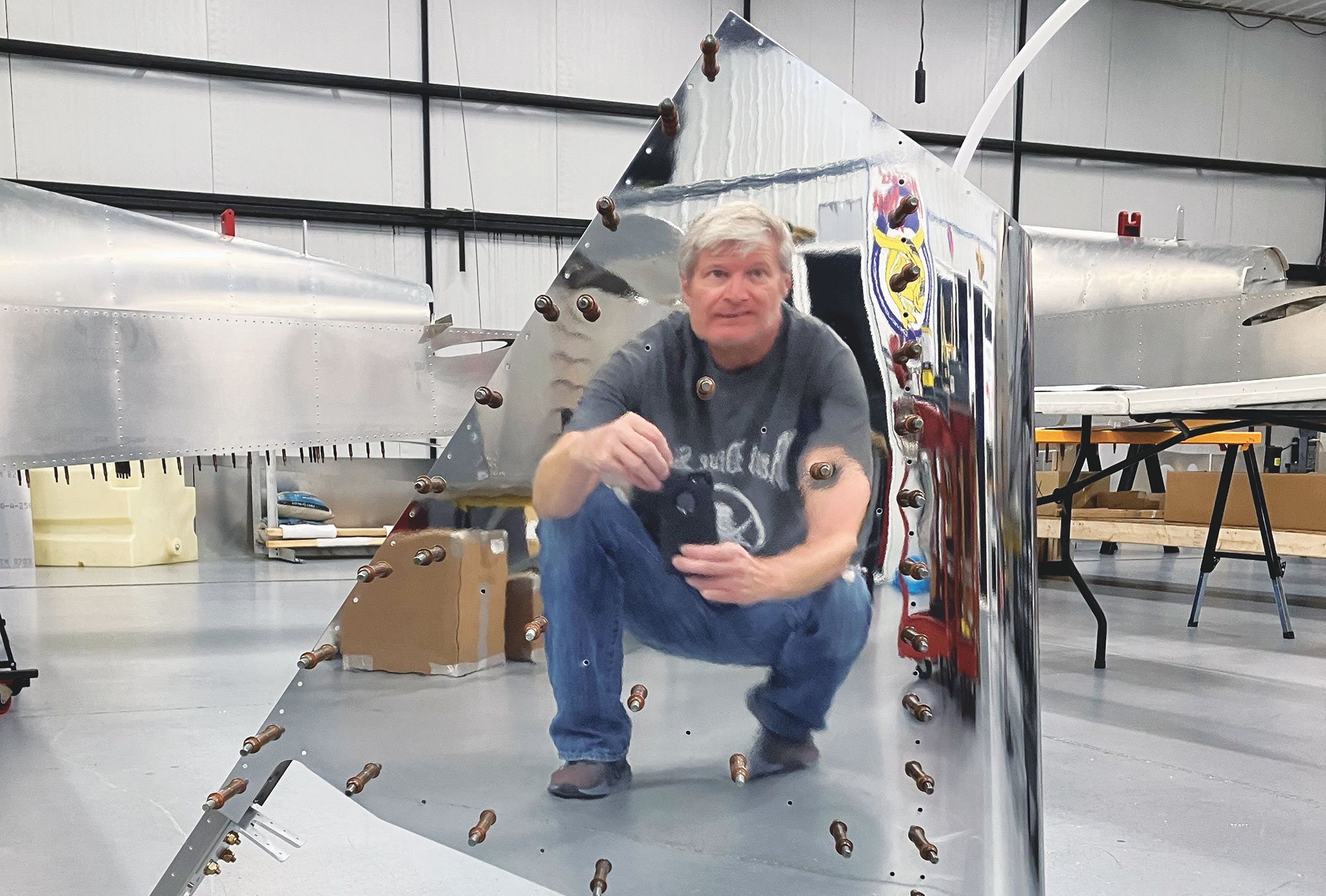

Flat Is Your Friend

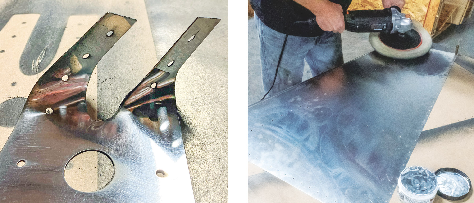

I emphasized in Part 1 that polishing individual parts flat and fully supported on a workbench is the easiest and most efficient path to a shiny finish. Subassemblies (wings, tail, and fuselage) can be placed on sawhorses and rotated/flipped so each side can be polished at a comfortable height without having to support the weight of the buffer. I did the initial polishing (NuShine II grades F9 and C) of the individual skins of my Onex before assembly. I’ll do the final polish of the major subassemblies flat on sawhorses (a touch-up with NuShine II grade C and then grade S, to de-swirl). If you’re done or nearly done with your airframe there’s no way around the inconvenience and frequent discomfort of polishing vertical and inverted surfaces and, of course, future maintenance of a polished finish will be at mercy of your knees, shoulders, and back.

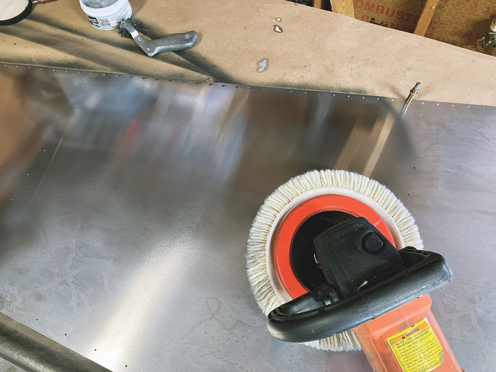

Making a Mirror With NuShine II Grade F9

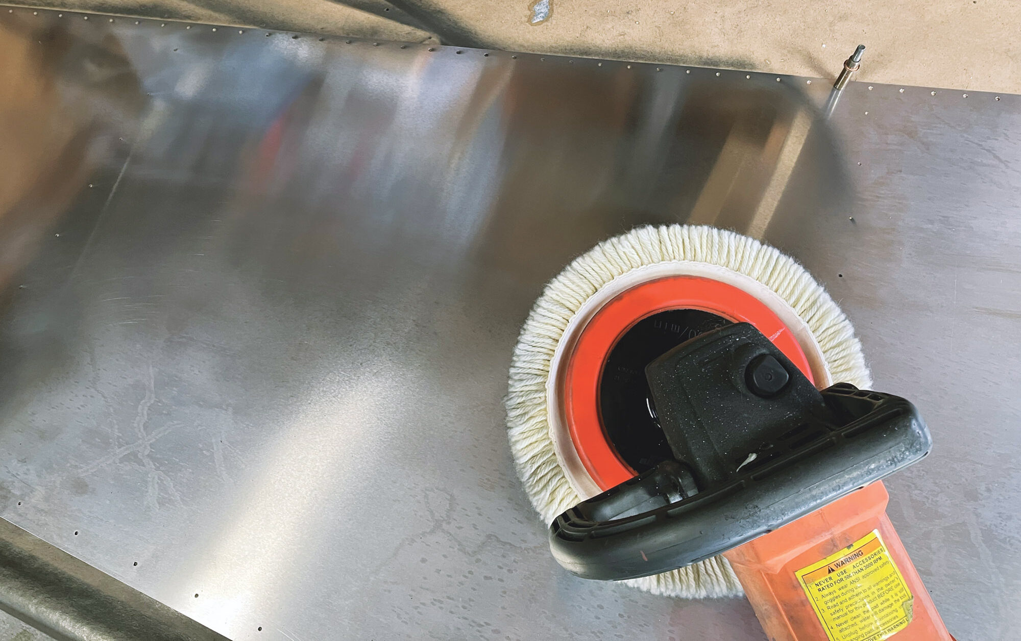

My technique for polishing with NuShine II F9 is to make four separate passes over the surface, each with its own application of polish (think of each pass as a coat of paint). What distinguishes each pass is the manner in which the compounding pad contacts the surface. On the first pass I hold the buffer so the portion of pad contacting the surface is rotating parallel to the grain. The first pass takes the longest but yields encouraging results. I polish an entire part before making the second pass with the pad’s contact patch rotating perpendicular to the grain. Passes three and four are made while moving the buffer in overlapping circles. All passes with F9 will leave swirl marks, which NuShine II C will diminish and NuShine II S and an orbital buffer will eliminate.

Polishing is not difficult; it is time-consuming and…boring. Unless you are committed to polishing, test-polish a few square feet of 6061-T6 to see if your commitment to polishing runs as deep as the reflection you achieve. Having one wing done poorly is a bad look. There are no shortcuts to a polished finish, but it’s a look that’s hard to beat and one that enjoys many benefits (see Part 1). If you find you don’t have the gumption to polish an entire airframe you can always give up and paint. In the final part of this series we’ll hone the initial polish with NuShine II C, polish out the swirls, and look at ongoing maintenance of the polished surface.
