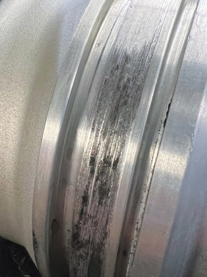

Recommended overhauls on constant-speed propellers are important. Here is a blade root that would not pass inspection due to scraping—most likely caused by improper lubrication or periods of inactivity.
