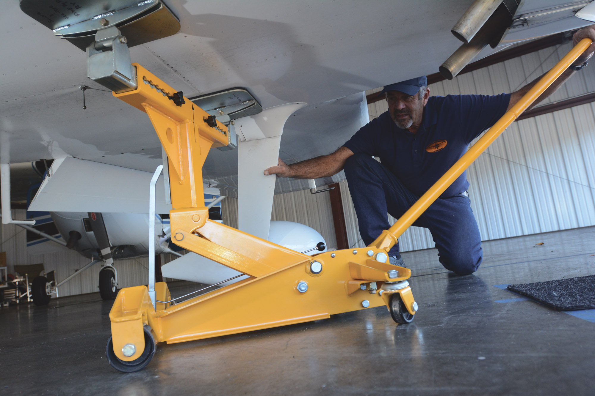

But the AJS jack does have its attractions. Chiefly, it is a thoughtfully designed, well-built answer to quickly and conveniently lifting small aircraft. A notoriously unliked chore, lifting airplanes always requires specialty tools and is usually done with a motley collection of objects found around the hangar. A bottle jack here, some old lumber there, a C-clamp or two, and you’ve lifted your pride and joy a few shaky inches into the air. There’s nothing quick, easy, or reassuring about it most of the time.

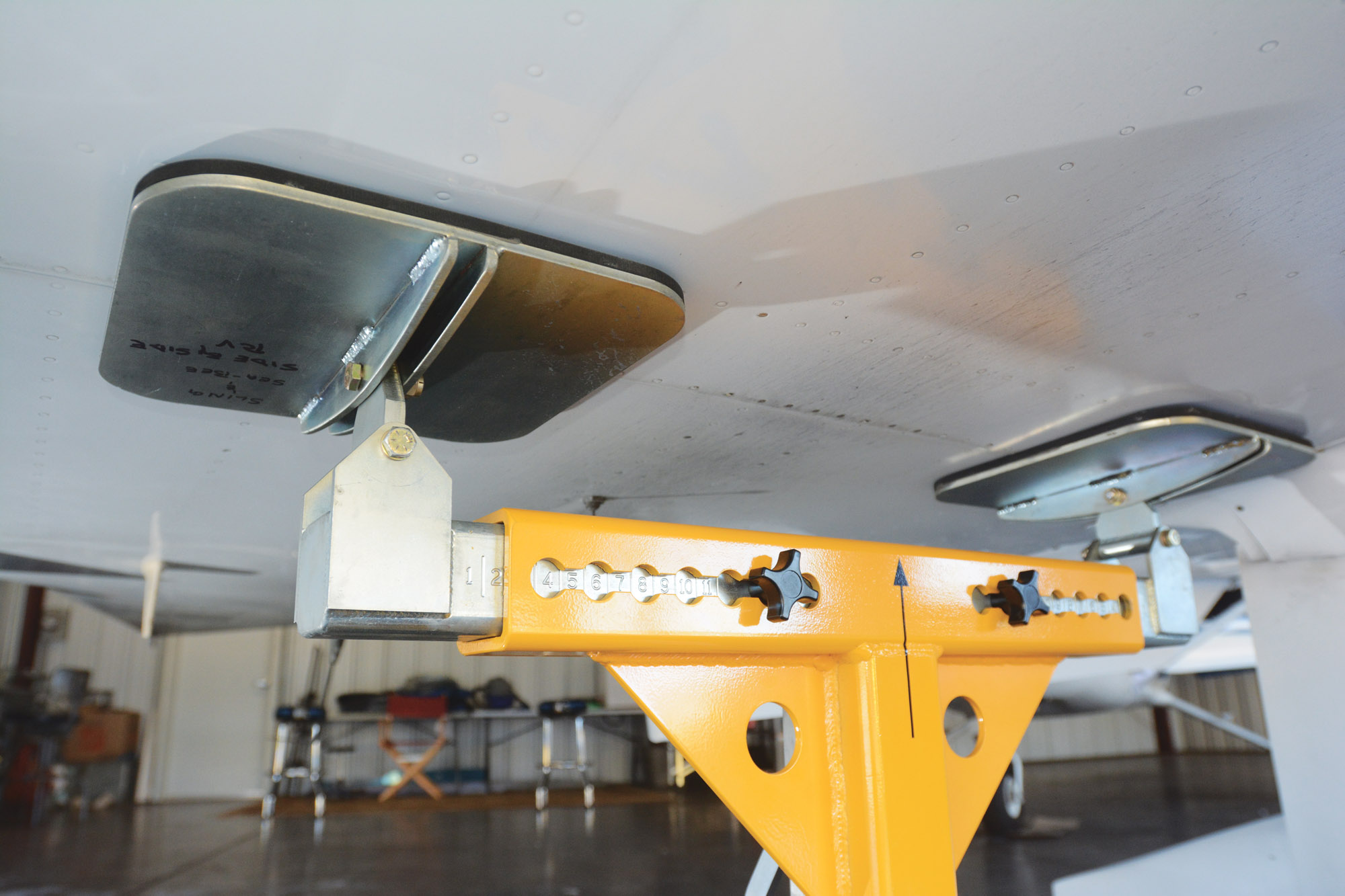

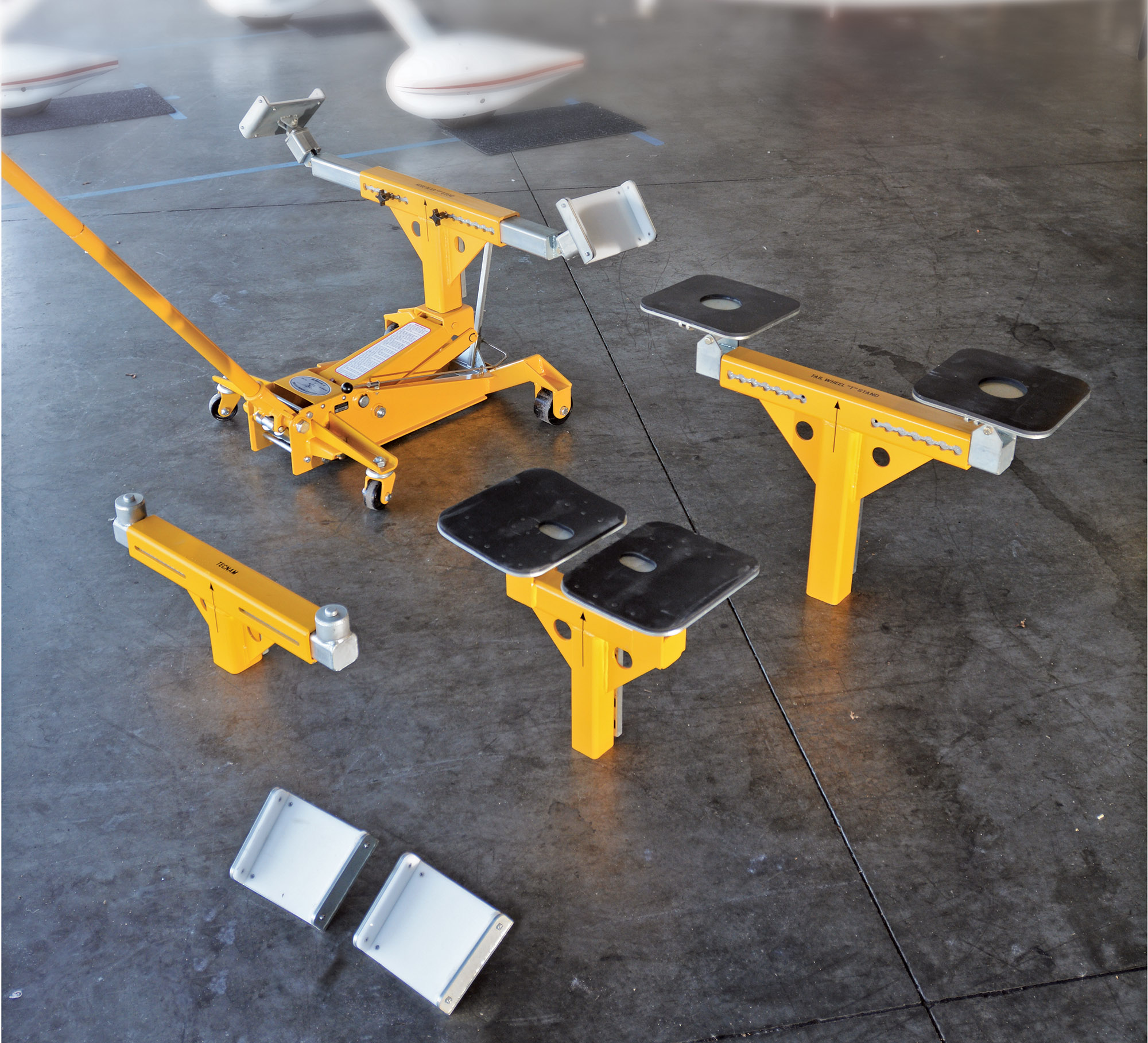

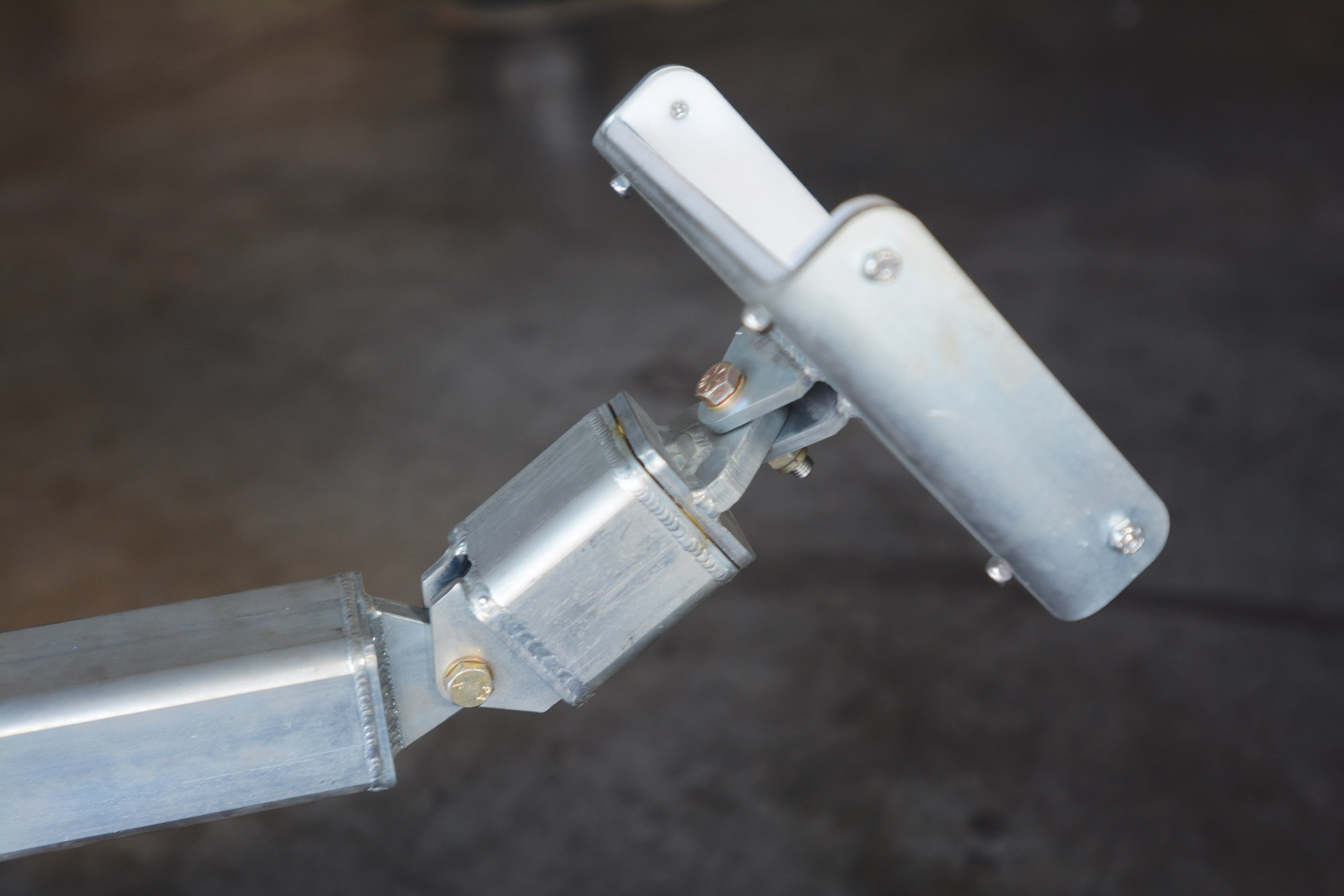

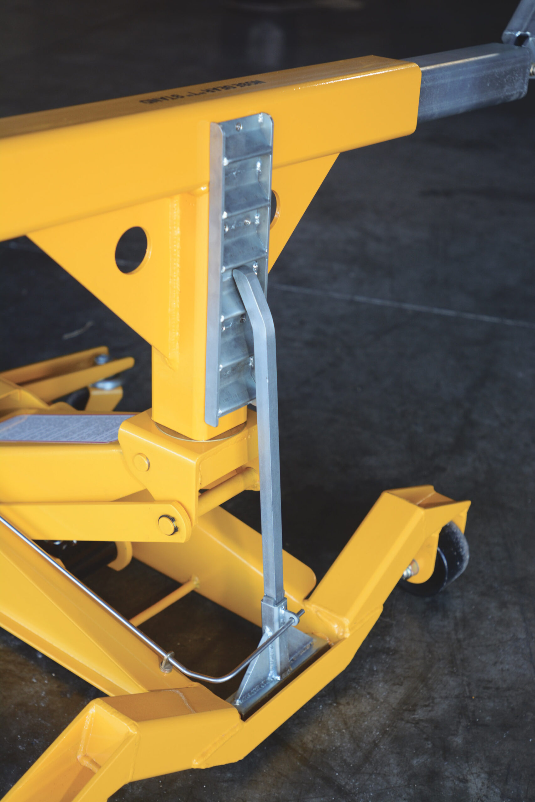

Conceived and offered by John Renquist of Valley Center, California, the AJS jack was designed to make jacking what it hasn’t been: quick and easy. His result is simple enough. Starting with a hefty floor jack, John gave it outriggers for stability and a series of custom-developed risers and jacking pads to fit specific aircraft. The purchaser designates the appropriate T-stand for his plane (or planes) and gets a lifting system specifically designed to mate with their airplane.
John, an A&P/IA with homebuilding experience, began development of these jacks in 2014 and has been selling them for several years. He’s always ready to build a new T-stand/jack pad combination as demand dictates and to date has a good start supporting popular airplanes. These include the leaf- and tube-spring fixed-gear Cessnas starting with the 120s and ranging up to the 185. All VanGrunsven RVs are accommodated (both tandem and side-by-sides, taildragger or nosegear), along with the Midget Mustang l, Sling, Tecnam Twin, and XCub. One presumes the various Harmon Rockets are, er, supported as well. Contact John if you have another airplane in mind.
