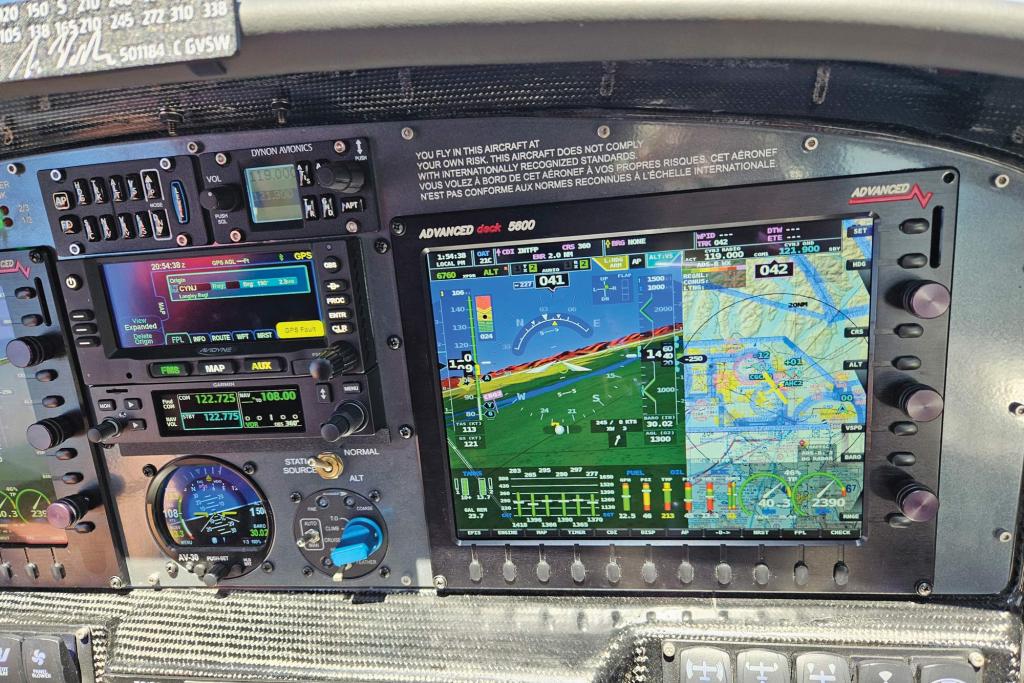

“The avionics have worked just fine. I haven’t changed a thing other than map updates.”

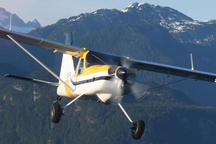

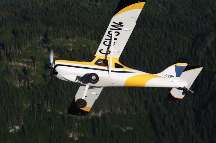

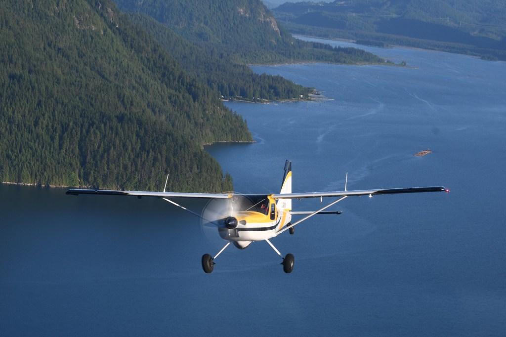

Now that all the required tests were complete and Sean was happy, it was time to get those inflight photos. Unlike the first flight where the Cardinal’s primary duty was to monitor the flight and advise Sean of any problems such as oil leaks or loose panels, Glen’s Cessna Cardinal was again drafted for use as the photo ship. Both Glen and Sean are experienced formation pilots and after a briefing to cover the safety of the flight plus the wishes of the photographer (me), we anticipated no problems.
The Cardinal, with its cantilever wing, is a good photo platform as the rear seat area allows access to both windows as well as the smaller rear window. How many aircraft can offer a back window? However, windows that don’t open can be a problem for the photographer. Watching the light carefully and keeping the sun behind helps to reduce the reflections from the window. In this instance, shooting in the late afternoon helped. The location selected was north of the Fraser River to a nearby lake and with the local mountains providing a scenic backdrop.
Once the picture taking was done, Sean decided that it was time to put on a few more hours with a shakedown trip. Sean’s concept of a few hours might differ a little bit from yours or mine. Thus, the return trip from British Columbia to California saw 22 hours added to the logbook. The trip gave him a baseline for future flight planning; cruise at between four and eight thousand feet consumed fuel at the rate of 11 gallons per hour. Oil consumption was minimal; none was added during the trip. The only “problem” during the trip occurred during the fuel stops. A minimum of an hour was spent answering questions from the many who wanted a closer look.

The panel has an incredible ability to provide an overload for my inner luddite but when Sean pushed a button some where, he gave me the “sacred six” that made life much easier.
