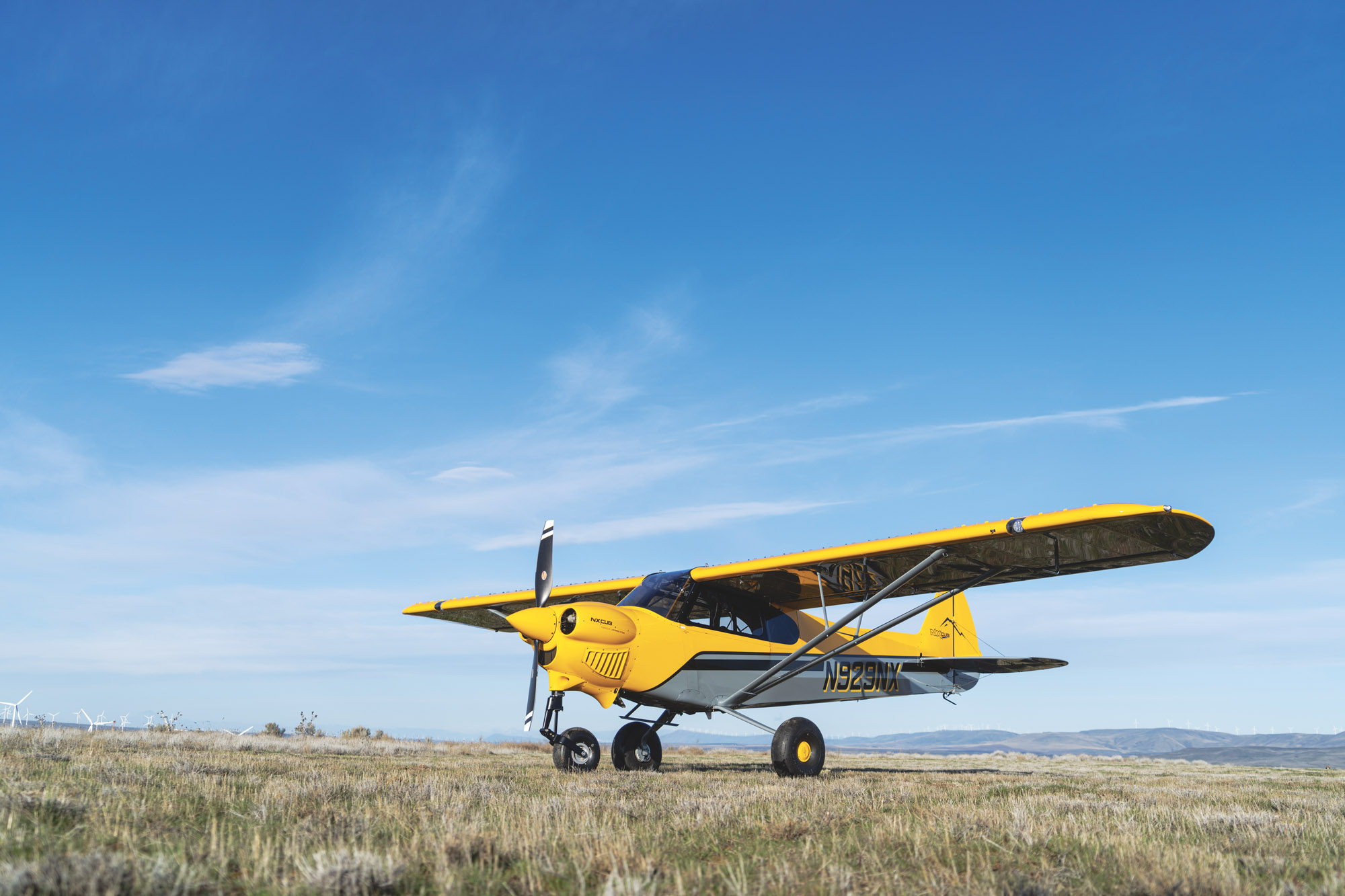

Of course, the most obvious change to the basic Cub design is that big nosewheel—but truth is, the XCub is a nose- or tailwheel airplane, and you can build it either or both ways. All of the airframes come with the attach points for either gear, and you decide to buy the nosewheel set, the tailwheel set, or both just to have the option. The nosewheel configuration is about $10K more than the tailwheel, and if you want both, you’ll spend another $20K—so $30K will give you all the bits for either configuration.

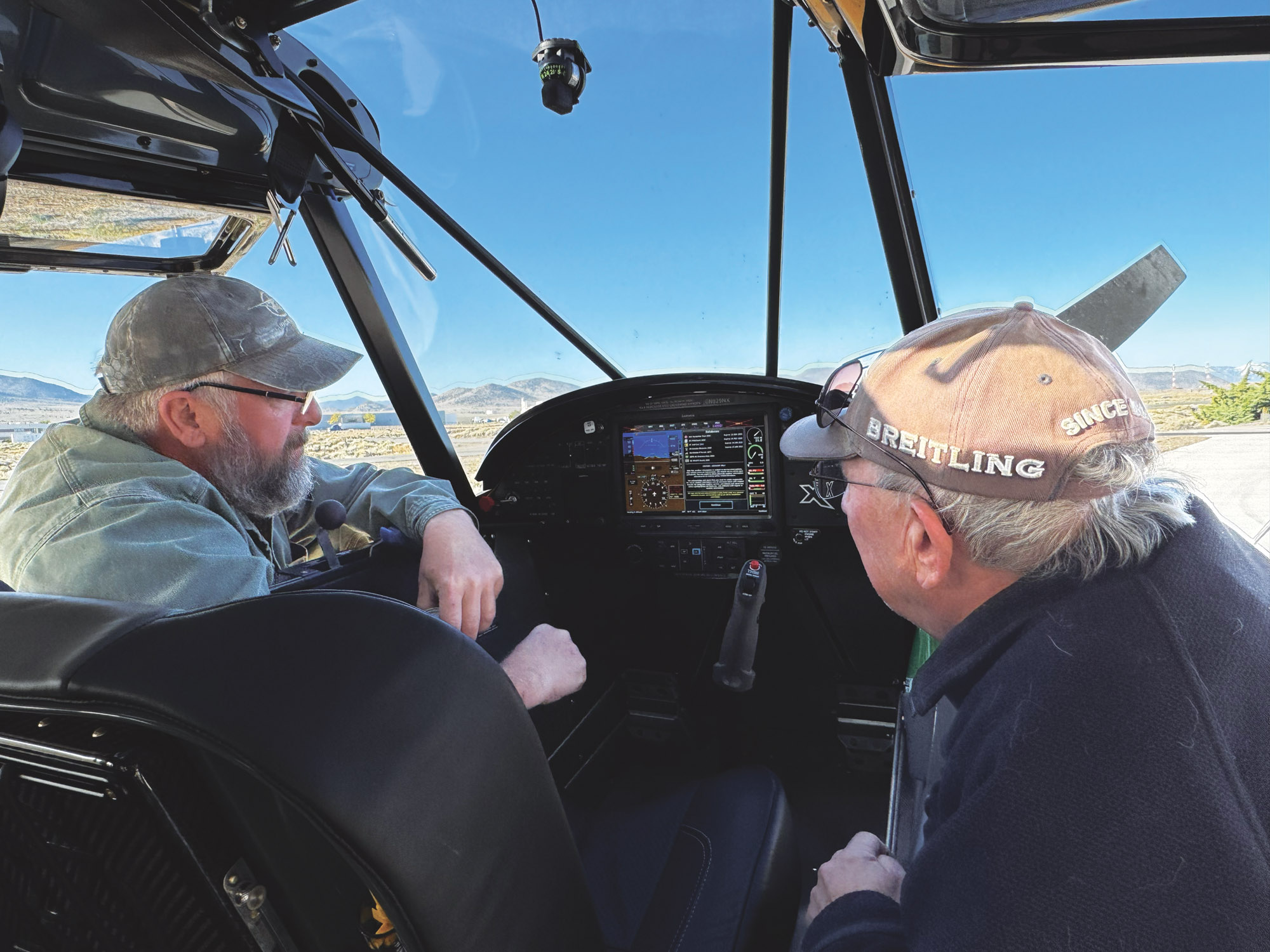

Brad Damm, CubCrafters vice president, delivered the very first E/A-B built NXCub to our ramp at our airpark in Dayton, Nevada, leaving it for us to play with for a week or ten days…or maybe two weeks! After a quick checkout flight we dropped him off at the airline terminal and drove home, rubbing our hands in glee—this airplane is amazingly fun to fly and very capable as a backcountry machine. That’s the summary—let’s dig in to the details.

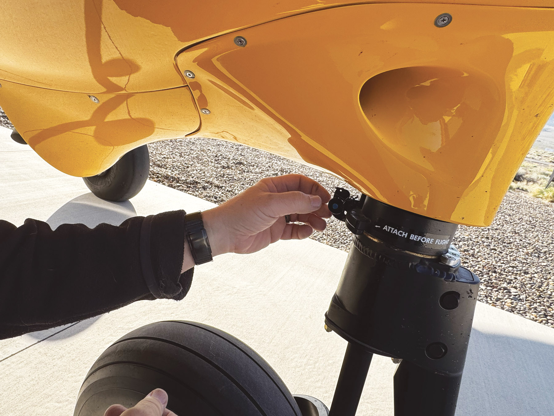

Cubs are Cubs in many ways—but precious few require preflighting a nosewheel! You do all of the usual stuff: Make sure the wings and tail are attached, the tail wires are taught (and don’t forget to check the lower ones for nicks from rocks and gravel), and that the fuel is free from water. You’ll want to check the vortex generators atop the wing are in place—but the airplane flies just fine if one or two are missing. If you find a hole in the vortex line, make a note to replace it, but don’t cancel the flight.

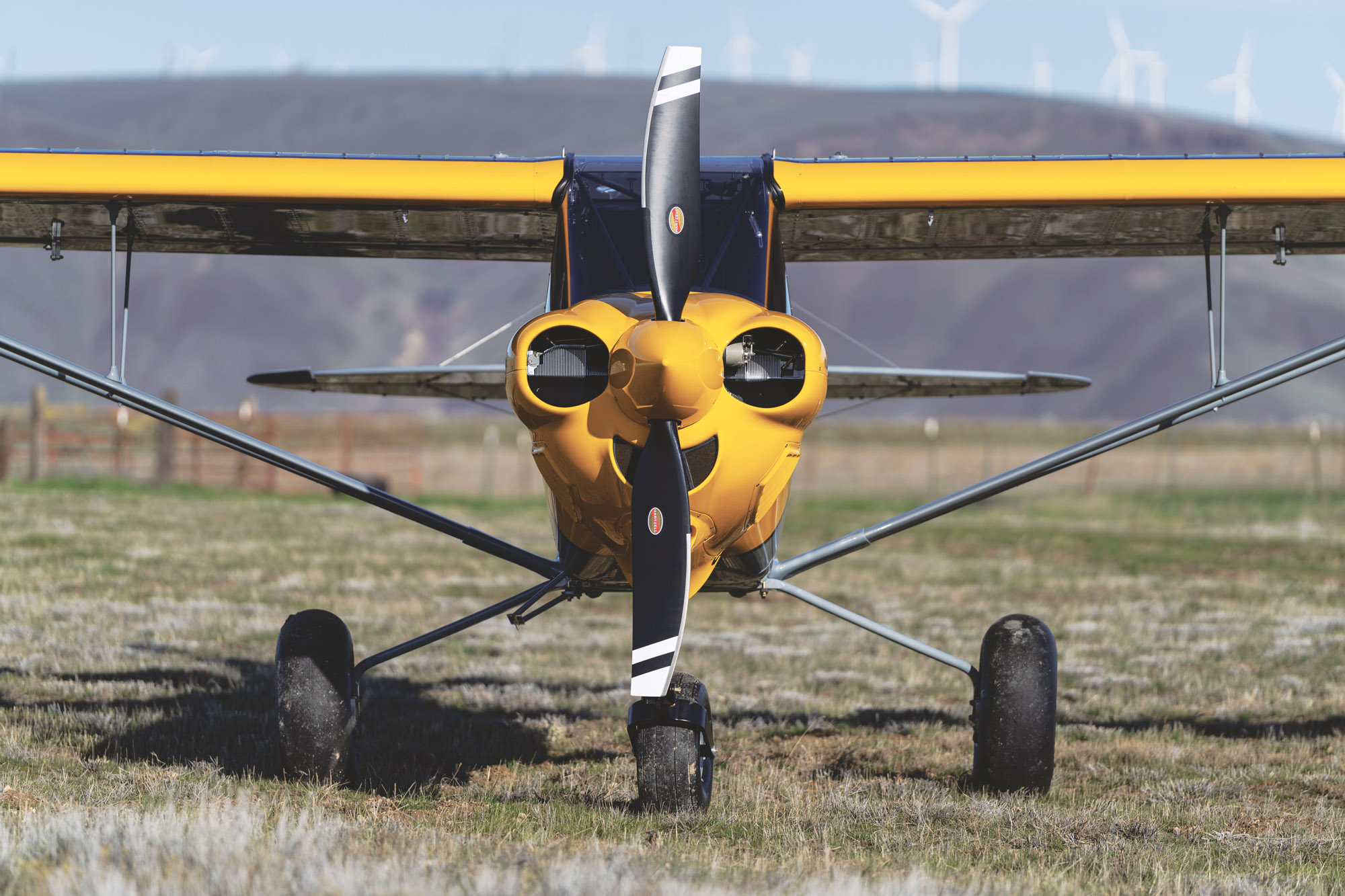

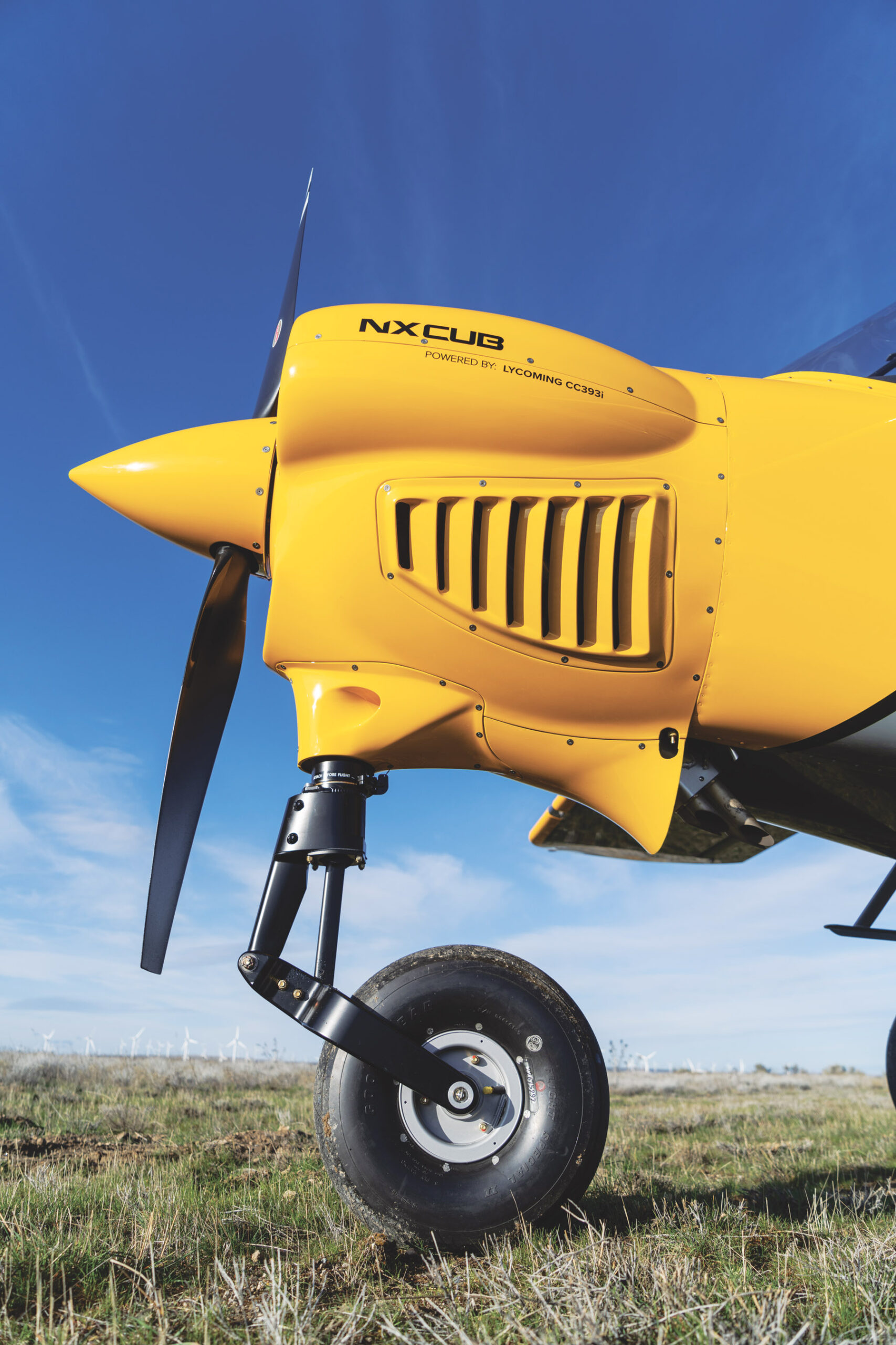

The nosewheel is full castering, but a limiter bracket restricts it from turning past 95° right or left. This prevents the nosewheel from rotating into the prop—a very bad thing if you were to land on a steep uphill runway and let the airplane roll backward. But the clever part is the bracket is removable via a quick push-pull pin so that you can fully swivel the wheel to push the airplane around on the ramp. Crafty. But what if you forget to put the limiter back in? There is a switch built into the assembly if the limiter bracket is not installed—it lights a bright red light on the pilot’s panel with a label saying “Do not engage starter!”

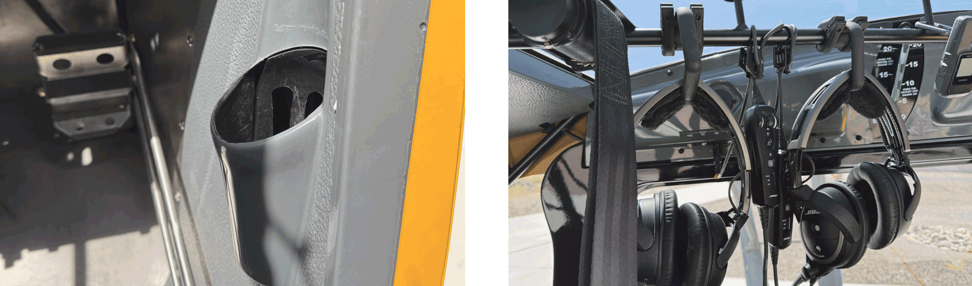

With fuel, oil, and airframe checked, it was time to mount up. Even this is made simpler in the XCub—instead of a little foot peg a rock climber might appreciate there’s more like a streamlined running board. It eliminates the risk of skinning an ankle on the end of the peg if you slip.

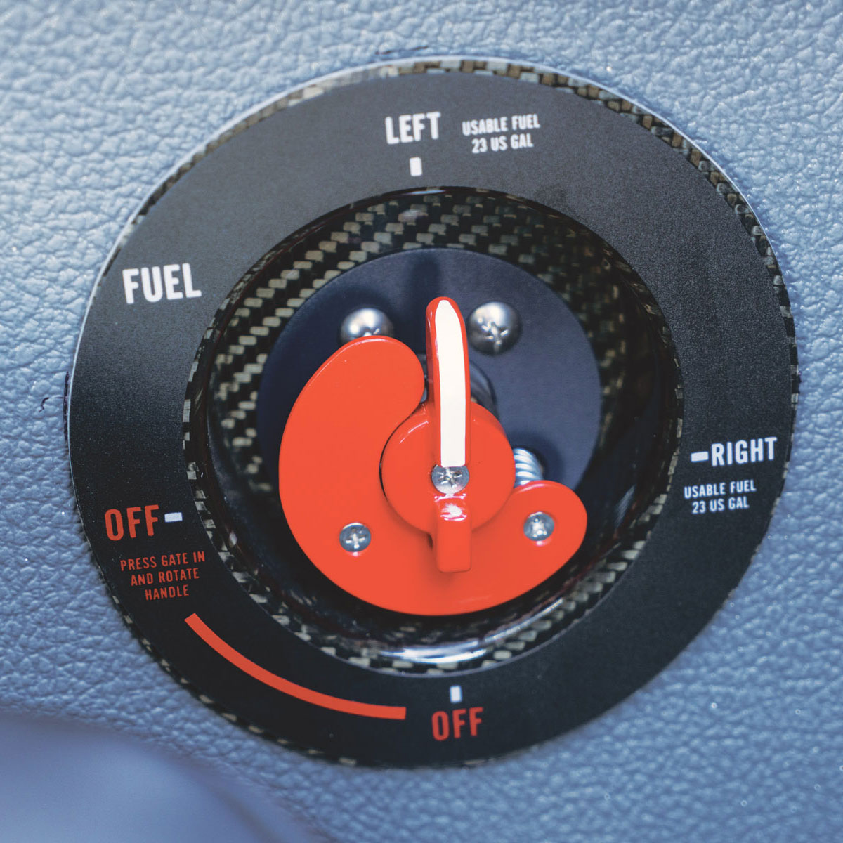

no both position.

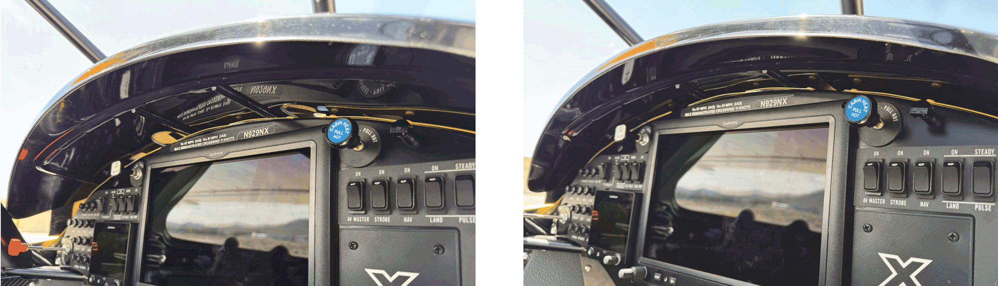

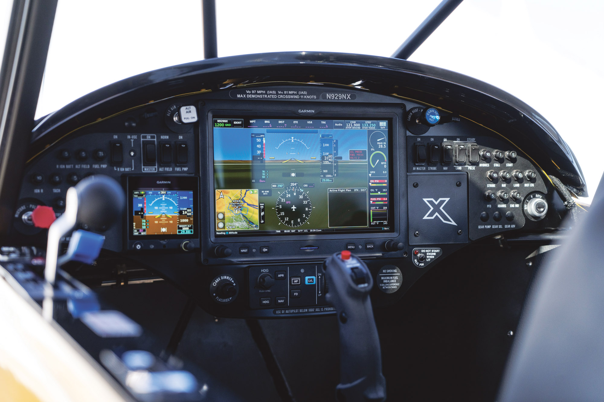

Settling into the comfy seat, you find it can be adjusted fore and aft to optimize distance to the rudder pedals. Everything on the panel is easily in reach, and the fuel selector is down on the left sidewall—left, right, or off—no “both” position. Why no “both” in a high wing? The answer is arcane and relates to how the FAA determined unusable fuel quantity—suffice to say, leaving off a “both” choice in the certified XCub allows an extra gallon of usable fuel on each side, and CubCrafters doesn’t want to stock multiple different types of fuel selectors for certified and E/A-B.
Cockpit setup is simple—switch on the backup battery to power the ignition and then the master to boot up the EFIS. Start the engine, then bring the alternator online and hit the avionics switch —then power up lights as needed.

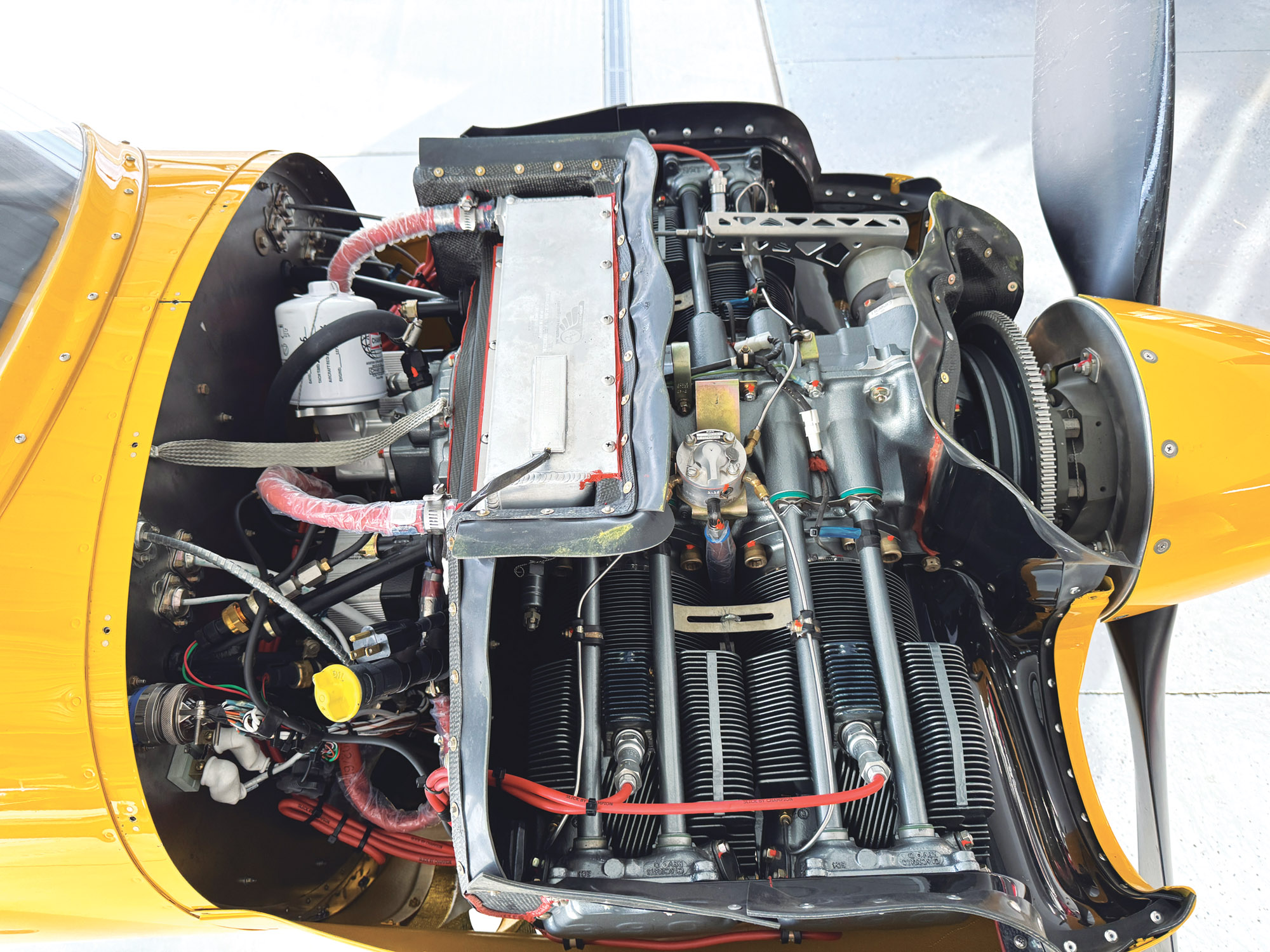

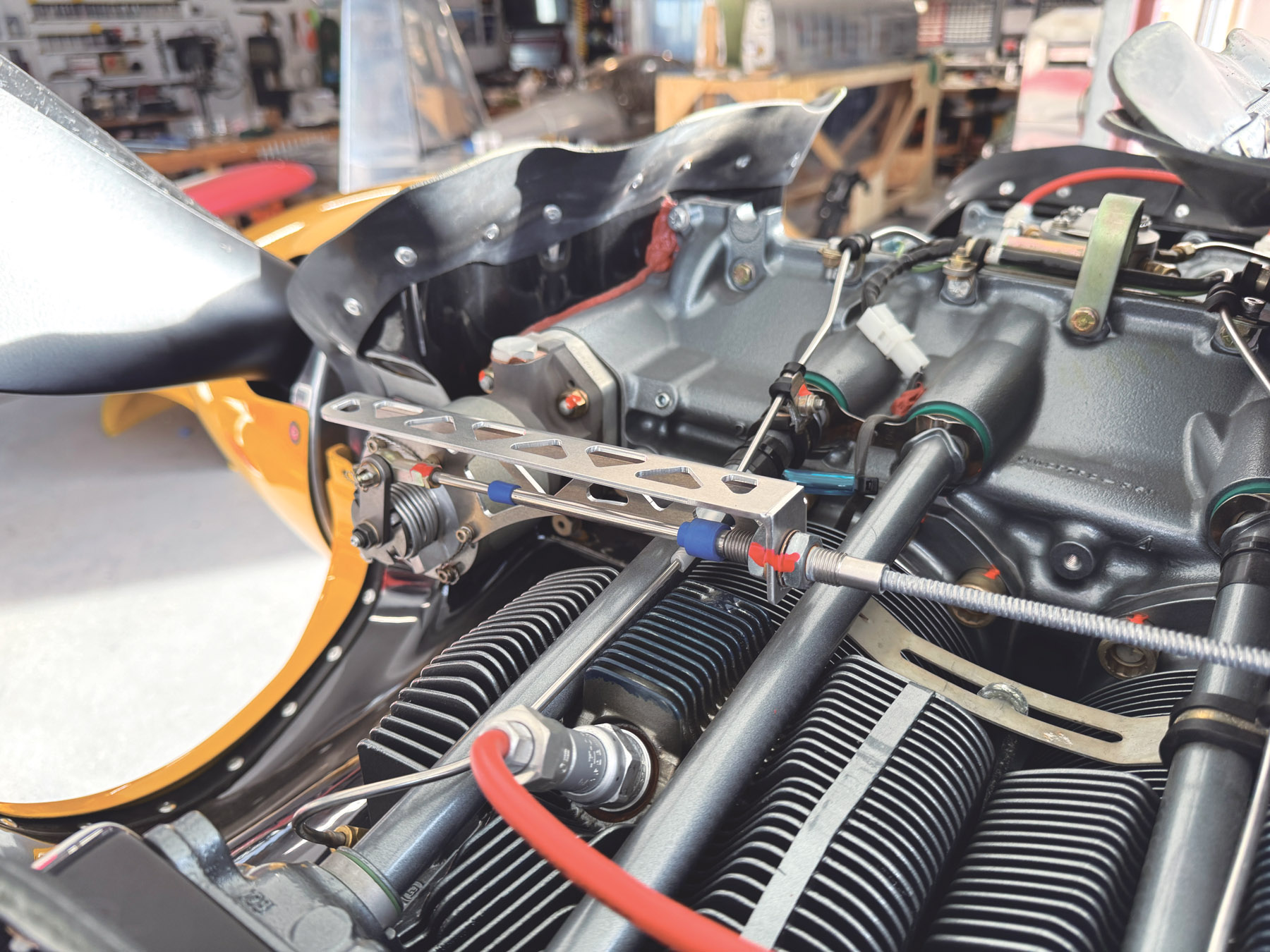

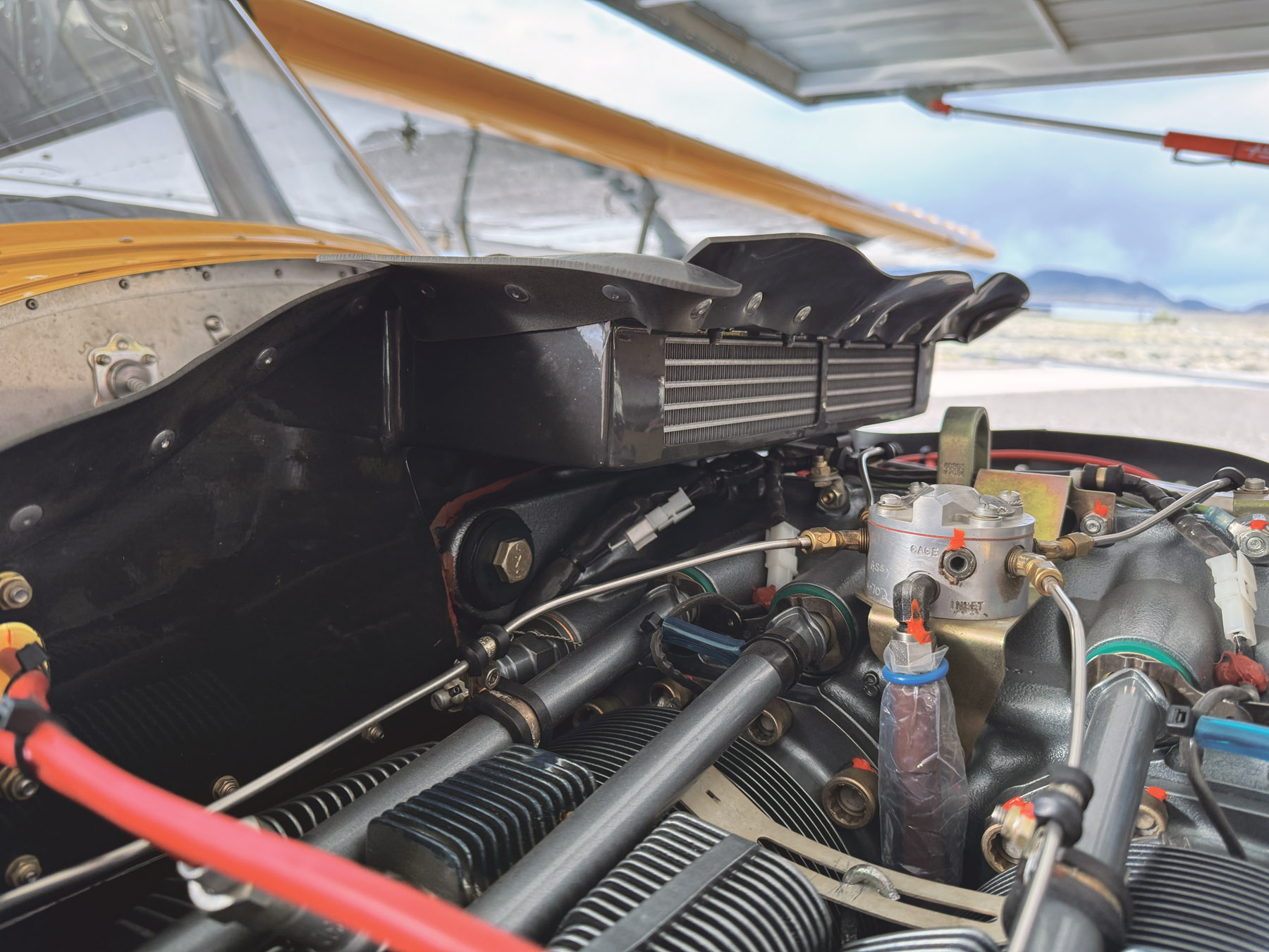

Starting the fuel-injected 390 (OK, it’s actually a 393 cubic inch engine, as are all 390s, but CubCrafters demanded Lycoming give them credit for ALL those cubes, and it sets the logo apart from all other 390-powered airplanes out there) is just like any injected engine: as simple or as hard as you make it. For this airplane, cold start is throttle–cracked, mixture–rich, fuel pump–on until you see pressure, then fuel pump off—then hit the starter and it fires up. Hot starting is like most injected engines as well: Assume it is flooded, throttle open, mixture to idle cutoff, crank until it fires and feed in the mixture. Don’t forget to hold your mouth just right—and it worked great for us!
Taxiing is simple with differential braking and the full-swivel nosewheel. It will feel just a little spongy to those used to a firmer nosewheel, but this big-shock, trailing arm gear allows a hair more motion—but you’ll get used to it after a couple stabs of the brakes. Taxi to the active, smoke the standard CIGAR, and you’re ready to roll. Note the radio is headless (frequencies are controlled from the EFIS) so practice this before getting into a high-intensity radio environment if you haven’t done this before. We had to hunt for the audio volume (also on the EFIS) after takeoff…our mistake for not trying it ahead.

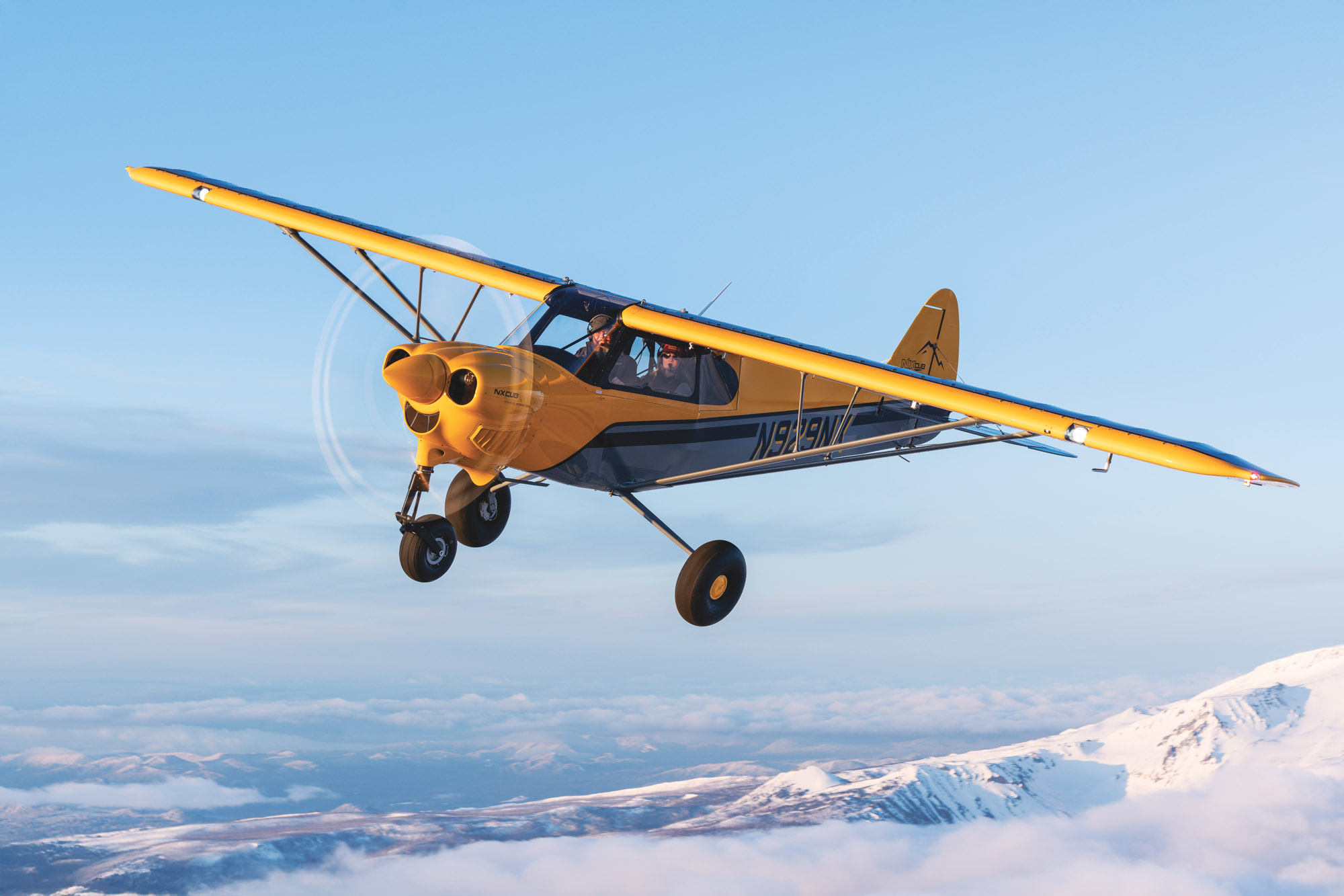

Control is positive in all three axes, yet the airplane is wonderfully stable. It stays right pitched where you trimmed it and is completely predictable. Roll is very natural for the weight and size of the airplane—much lighter if you are used to the Piper Cub—but in my mind perfect. The rudder is very effective once you have a little airspeed and nicely blends with aileron in the turns.
After clearing the pattern at 1000 feet, we pulled the prop to 2500 rpm—a comfortable setting, but use whatever works best for you. Damm suggested 2200 gives best economy cruise. With our home airport at 4400 feet MSL we won’t see more than the low 80s for percent power on the EFIS, even at full throttle—but pulling back to about 70 percent gives a nice cruise. Sixty-five percent felt very comfortable, however, and exact cruise numbers aren’t that important to us in backcountry airplanes, to be honest. You get there when you get there; these aren’t go-fast airplanes.
We started our air work with a couple of steep clearing turns, and I was amazed at the visibility out the top of the cockpit through the plexiglass with 45°—almost as good as being in a bubble. With the airspace clear I pulled back the power and flew down around 50 mph, horsing the roll and yaw around, daring it to stall out of the slow flight. It didn’t take the dare so I pulled the power off, and it lazily bobbed its nose a bit, yawning at me and settling into a bit of a descent. “So you don’t want to break? Let’s try this!” I added power, accelerated a bit, pulled the nose up quickly to a 45° attitude, and pulled off the power. That got us a nice break, but still straight ahead. Same technique with 30° bank? It broke and rolled toward level—it is a very nicely mannered airplane.
Stalls were accompanied by a warning horn, but there was no AoA installed on the machine. Brad admitted he really likes AoA, uses it all the time in airplanes where it is installed, and appreciates the progressive tones from the Garmin G3X—but said that CubCrafters is still trying to find a reliable static port position that will satisfy Part 23 certification for the airspeed/altimetry function and also work for AoA. They have considered using a second pitot tube just for AoA but haven’t come up with a solution yet…but they are working on it.
