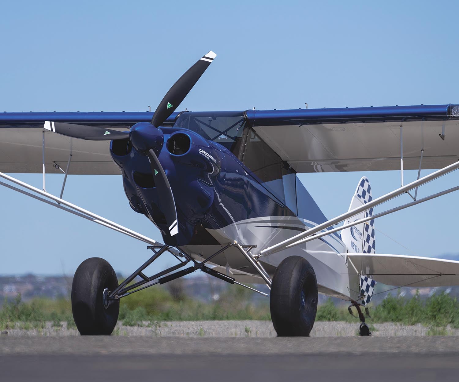

I was invited to participate in the build of a Carbon Cub UL (the new model with the Rotax 916 on the nose). In fact, I became the builder of record for an airplane that will function as a test article and dealer demo. (Sadly, I was not gifted the airplane after the build, though I am negotiating for visitation rights.) The build took place over two sessions several weeks apart—normally the gap between the first week of work and the final couple of days doing assembly tasks is much shorter, but this airplane was still undergoing engineering changes so it was slow-tracked compared to the regular process.
As mentioned earlier, the CubCrafters program relies heavily on the customer doing fabrication projects. What’s more, these are done alongside the normal processes employed with the production-line Carbon Cubs. It’s not like there’s a dingy shop in the back where builders come to labor. No, you work directly with the same guys who build the certified parts, on the same mostly high-tech machines they use. You’re assigned a guide for the whole process; in my case it was the ever-cheerful Gracie Main. Her job was to photograph my efforts, thereby documenting my education, and then move me from one project to the next. While the process is highly choreographed, it does at times feel scattershot as you move from trimming carbon-fiber cloth to cutting steel tubes to pushing a button on the CNC router to drilling holes in things. (This time, never my own digits.)
It’s worth noting that because CubCrafters is an FAA Part 23 aircraft manufacturer, your parts are always carefully segregated from the rest of the system. Computer-based tracking ensures that, say, the tail members you carefully bent will actually reach your airplane, though the care taken with each piece is the same as if it were going on someone else’s certified example. For that matter, the parts themselves are identical, so what you end up with is an airplane registered as an Experimental/Amateur-Built but made with certified-quality parts.
