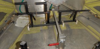

With the engine hung it was time to fit the new cowl, in this case a non-stock, James Aircraft Holy Cowl. Why go partway with these changes? Why not add a few more variables to make it really interesting?
Installing the cowl during the original build was fairly straightforward, but matching a new cowl to the existing fastener holes would prove to be a challenge. Or so I thought. Trimming the top cowl first, as is the practice, was simple. With the spinner installed, a piece of scrap aluminum angle was used to set the gap between the cowl and the spinner. Two rolls of paper towels nestled between the cylinders helped hold the top cowl at the proper elevation, and a trouble light was placed inside the engine compartment so the edge of the firewall could be seen through the translucent fiberglass. Black electrical tape was used to mark the cut line on the cowl. Trimming the cowl and sanding the edge straight with a long board was a non-event.
The original cowl was held in place with quick-turn fasteners, which have large holes on the mounting flange. To make sure the new cowl lined up perfectly, I made a small aluminum plug with a #40 hole in the center. The plug was placed in the fastener’s hole, and a hole-duplicator was used to drill a matching hole in the new cowl. The cowl was then removed, the #40 hole was enlarged and the quick turn fastener was installed prior to moving to the next hole. As with the original cowl, I started with the center hole and moved to the outside, alternating between the left and right sides. While a time-consuming process, the new cowl fits as well as the original.

The Holy Cowl does not come pre-cut with a location for the oil filler access door. After identifying where I wanted to place the oil door, I covered the top cowl with stretch wrap and laid five layers of fiberglass over the pre-marked door. I wish that were the end of the story, but in my rush to finish something, anything, I over trimmed the door after I cut the hole in the cowl. A quick call to Will at James Aircraft had another layup headed my way.

Something doesn’t look right. The stock filtered airbox (FAB) does not line up with the air inlet on the bottom of the cowl.
The inside of the bottom cowl was sealed to prevent it from absorbing oil with four coats of epoxy and acetone mixed 50/50 and rolled on with a 3-inch high-nap paint roller. After this layer hardened, the inside of the lower cowl was covered with a sheet of self-adhesive heat shield, which is similar to contact paper. To smooth out the heat shield, a wallpaper seam roller was employed. The edges of the heat shield were taped off, and a skim coat of clear RTV was used to seal the edges and prevent the heat shield from peeling up. (The tape was removed immediately following the application of the RTV.)
Unlike the standard item, the Holy Cowl is designed to work with a cooling plenum. The plenum provided is a close fit, but some additional trimming and fiberglass work was required. For my installation, I cut the front of the plenum off, covered the engine in Vaseline (otherwise known as the poor man’s mold release) and glassed the plenum directly to the engine and inlet ramps. While I was at it, I built a ramp at the aft left of the plenum to provide more air to the oil cooler mounted behind the No. 4 cylinder. Overall, the substitution of the Holy Cowl added little in the way of extra work, with the notable exception of the plenum.
